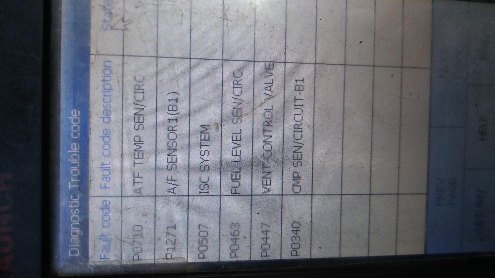

I got this 04 sentra with a stalling problem the first time it got here it had the same codes. All i did was pull code for him and I was asked that code should he worry about i said we need too look at p1271 and p0507. Customer went too a junk yard and got a A/F sensor and i installed it, it did not fix his problem. At this time i did find a vac. leak I fixed it and the stalling was more frequent . Question here is can a bad A/F sensor cause the car to stall ? How do i check the A/F sensor ? Where should I start?
Thank you for your help

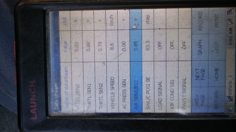

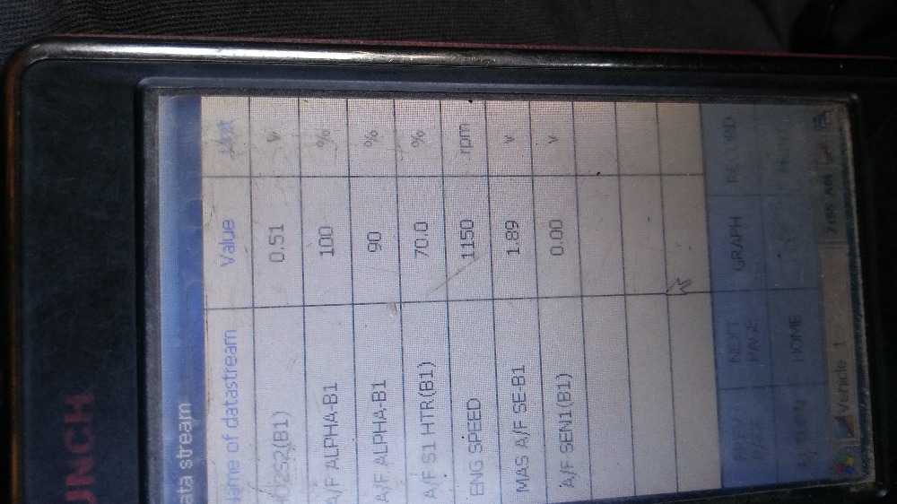

Today I chased the MAF sensor wires after i did repairs. From the PCM to the plug i had continuity and when I start the car I get thees readings on the blu/red 1.115 v, red/wht 5.16 v, bk/wht 94.9mv,red/grn 14.25 and on the yel/grn 3.165v can anyone tell me if thees are good and I need to replace the sensor?

Mr. Monde thank you brother for your respond. Brother how can I tell if it's a ground that wire go's to the pcm and it don't say. Is it grounded in the pcm?

Thank you Monde, so the yellow and green is the 5v for the temp sensor. So do you think I should replace the maf sensor, will a bad cause the A/F sensor to read rich?

Hey Monde I checked the blu/red wire and it didn't rise when i rev.the engine. I called a bad maf and replaced it and it fixed the problem.
