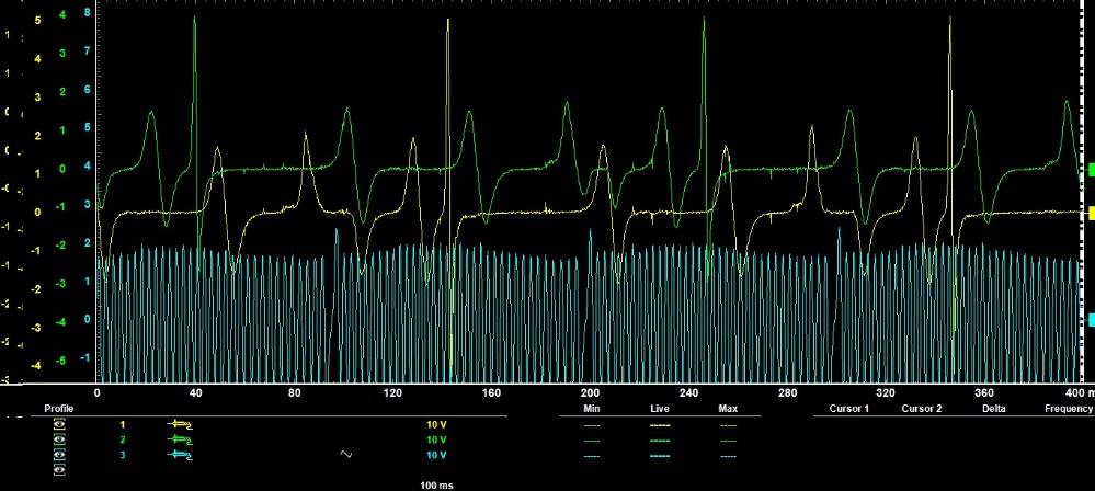

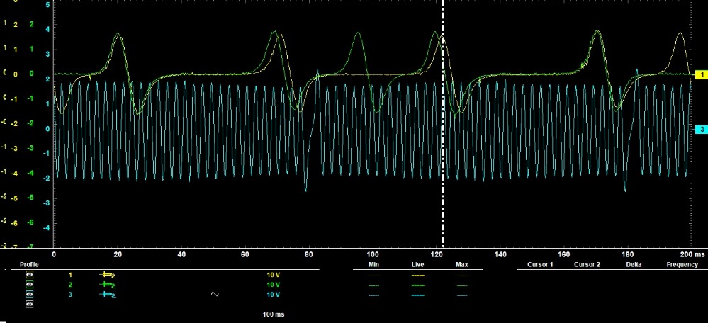

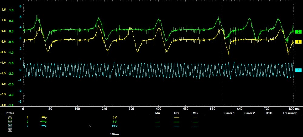

Hi Guys,
I have a 2006 Ford F150 5.4L that came in with a stalling issue and the CEL was on. I can't remember the code number but it was Cam Position Sensor Circuit Bank 2.
During a test drive the truck started up and ran great minus a slight studder or misfire. Nothing to noticeable. It had plenty of power and only acted up when come to a stop once in awhile. It stalled 3 times on my 25+ minute drive. When it stalls the engine starts to misfire, knocks like hell, sounds like its tearing itself apart inside and eventually stalls. I can get it to repeat in the bay every time under very very light throttle after power braking the engine. It will actually stay running some times but it sounds like its going to explode.
I checked the oil level since the oil change was just done at our shop and its fine. I thought maybe the oil level was low and it was loosing oil pressure. I have not verified oil pressure with a gauge. Only indication that oil pressure should be good is from the cluster
I did a CMP / CKP Correlation test and I can't believe what I am seeing. I have attached 3 pictures. Some suggestions would be great.
My next move is to get approval to remove the valve covers to see if I can get an eye on the chain. Not sure if I can I haven't had to do a chain on a 5.4L before. I know some engines removing the valve cover doesn't expose the chain. I am leaning on chain and components as the timing is certainly off but in the back of my mind thinking something else might be going on too.
Signals taken at PCM
Yellow: BANK 2 CMP
Green: BANK 1 CMP
Blue: CKP
Cranking Waveform
Engine Running "OK" Waveform
Engine Running - Big Problem Waveform
THEORY: Crank and/or cam chain tension is gone causing the chain to slap or tighten up at time causing the cams to spin much faster creating the high spikes on both banks?

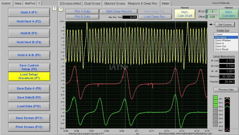

Known Good from IATN that I am comparing to.

Did some more data gathering. While this happens I can see the VCT timing PIDs go erratic. Timing ranges from 0 deg to 60+ degrees on which ever bank is effected at idle with no throttle input. Mostly bank 2. the CEL did come back on this morning when it acted up again. Yesterday I had it acting up at least 7-8 times with no CEL but I also noticed on the scope that sometimes it was bank 2 and sometimes it was both banks.
P0340 Cam position Sensor Circuit Fault
P0345 CMP sensor A Circuit Problem Bank 2
I am thinking are false circuit codes. Mainly due to the fact that the oscilloscope showed both CMP sensors and the CKP sensor working fine during the events yesterday with no CEL. I also swapped the CMP sensors from one bank to another and the CEL came back on for bank 2 which is the side it mentioned before I swapped the sensors.
The phaser issue seems to go away when reving the engine above 2000 Rpm a couple times. After which it will idle and run fine with a minor ticking noise that seems to get worse as the engine gets hot.
