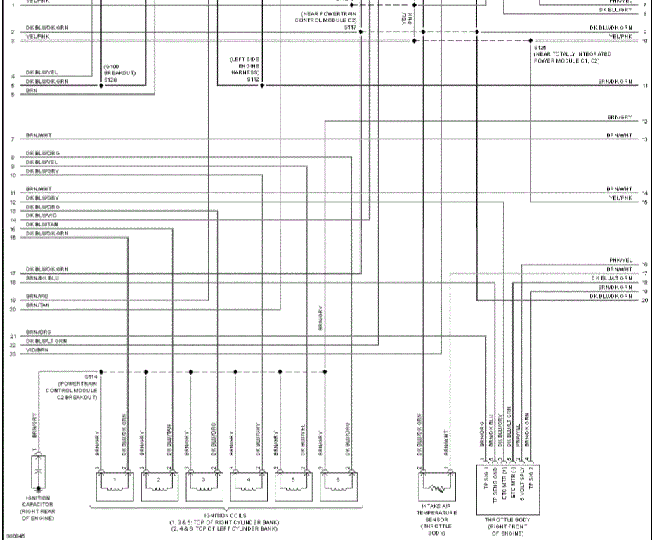

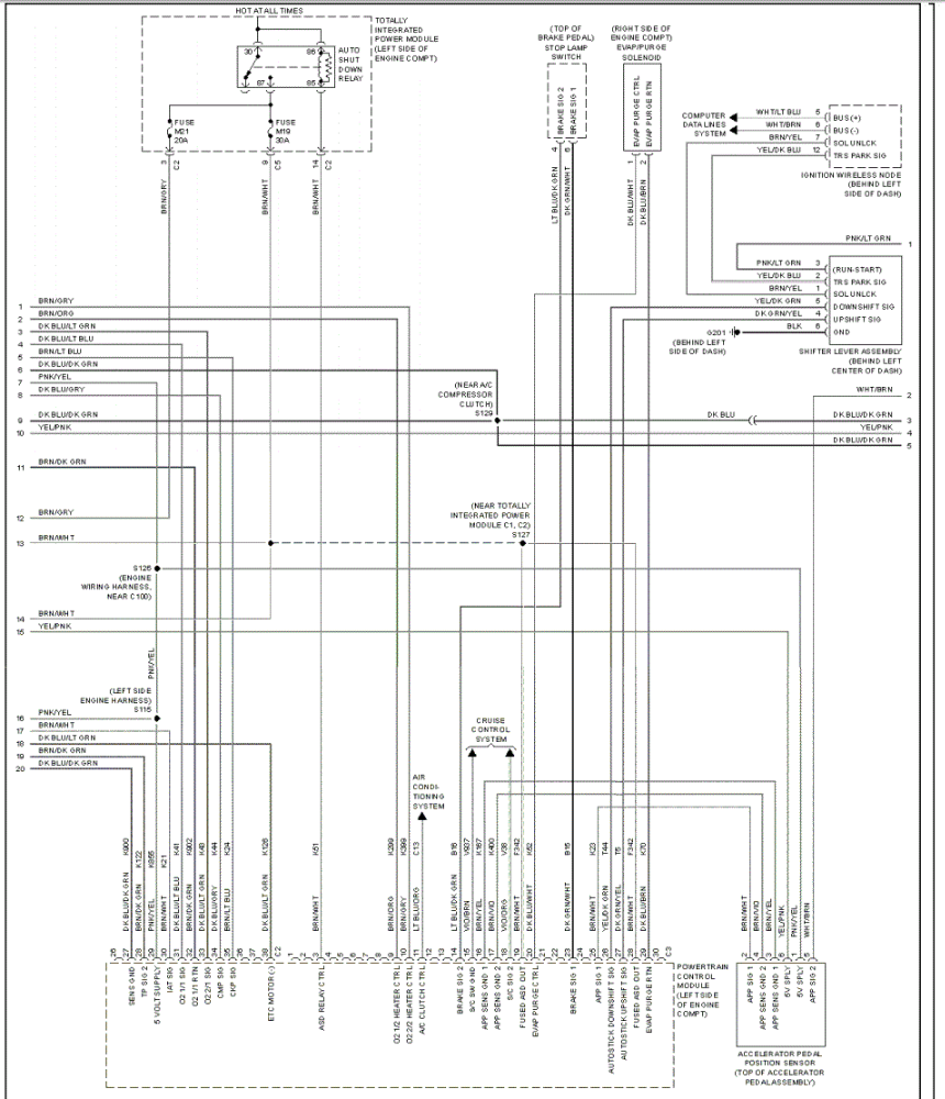

Complete wiring diagram can be found below. I took this snippet from page 66.
cardiagn.com/2009-system-wiring-diagrams-dodge-grand-caravan/
What are the next steps? I'm assuming piercing the wires without any reading at different intervals to see if I get a reading. Currently, I don't have anything to pierce the wire with and my local Lowe's nor Home Depot sold piercing probes. I'm located in Columbia, SC, USA.

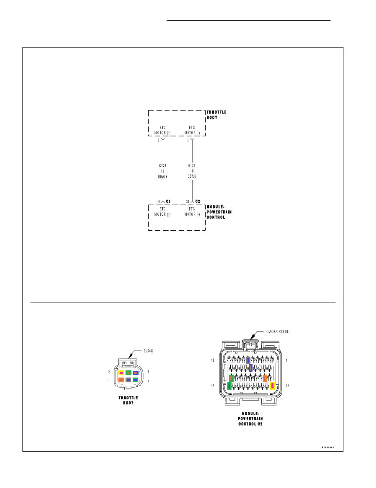

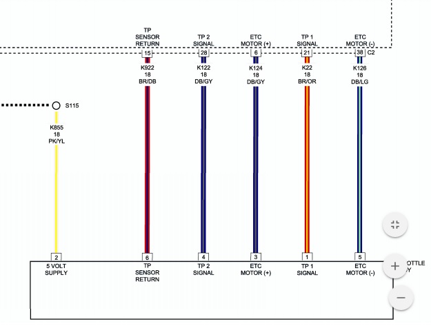

8 years 3 months ago #20664 by StupidRalph
Either I'm reading the wiring diagram incorrectly or there is a misprint. I can not correctly trace back the ETC Motor (+). On the diagram the wire goes up and to the left and is dk blu/gray wire numbered 12. On the next relevant page on the left side number 12 wire is now brn / gry and goes to fuse 21 ASD#3. within the TIPM. Any insight?
I am viewing page 66 and 68 listed here.
Page 66
Page 68
8 years 3 months ago #20706 by Tyler
I think you're missing a page? :huh: I dug up the OE diagram on BBB Industries for clarity:
File Attachment:
File Name: tcthrottle.pdf
File Size:350 KB
So pin 5 lights the test light when connected to B+... Is the PCM easily accessible? I'd suggest getting the test light connected up and lit, then disconnect the PCM. If the light goes out, you know that ground is inside the PCM. If the light remains lit, you know that wire is shorted to ground somewhere.

7 years 10 months ago - 7 years 10 months ago #24155 by StupidRalph
Where can I find a chart of the pinout for the PCM? I am signed up on BBB Industries but can not find which connector has the wires for my PCM. I believe its C2 which I'm saying is the second connector from the right. But I'm trying to identify which pin is which. Right now I'm going to try carefully front probe connector and test other end at TB for continuity.
Unable to find on BBB Industries BUT I have identified the different pins on the connector that route to the TB connector. I also found a google image of the same connector pattern and marked the locations. See attached.

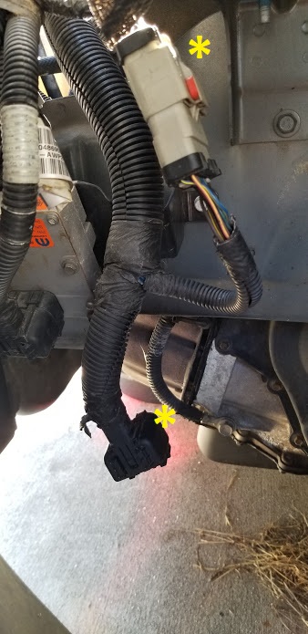

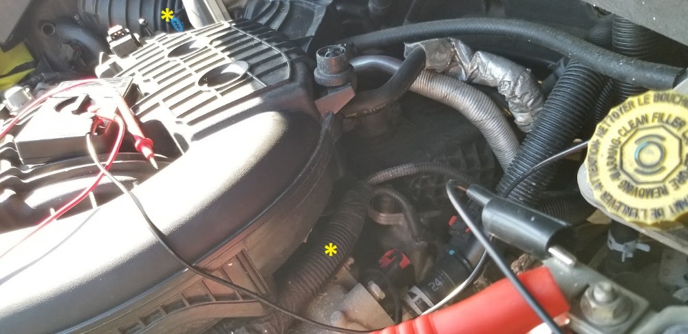

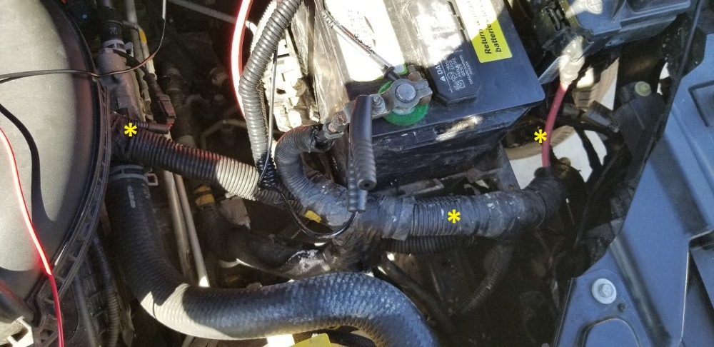

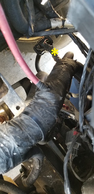

7 years 10 months ago - 7 years 10 months ago #24179 by StupidRalph
I've attached pictures of my findings.
Pic 1 is most relevant. Pic2 - 4 just show where the wire routes through the vehicle.
Pic 1 shows C2 connector hanging down but also where the cable splices out to a gray connector. When the gray connector is unplugged the short disappears at the TB AND at the C2 connector. It also disappears on the bottom half of the connector. It does appear however on the pink/yellow (5v ref) on the top part of the connector.
Pic 2 shows the above view from the hood of the gray connector and main wiring harness. I've marked them with yellow *s.
Pic 3 shows more top part of connector, and more directional wire routing.
Pic 4 shows routing behind upper intake (?) plenum(?). (told you I wasn't a mechanic :P ) and also the TB connector in the background marked with yellow *.
Last edit: 7 years 10 months ago by StupidRalph. Reason: Forgot the pix

7 years 10 months ago #24218 by Ben
So it appears Tyler is tied up with work again I'll step in while he's gone (not hijacking it from Tyler lol) so let's clarify when you disconnect the grey connected in picture 1 the short to ground goes away on pin 5 of the TB and and the PCM?
