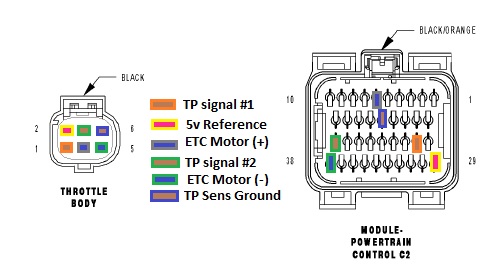

@Ben
PCM connected test light on B+ pin 3 pin 5 pin 6 light test green. Hmm...
@Tyler
I didn't read for understanding apparently first time. In essence, I'm testing the integrity of the wires from pin 3 and pin 5. Test light on ETC motor pin all the way through to pcm c2 which is grounded. Performing test now.
@Tyler

Ok Tyler.

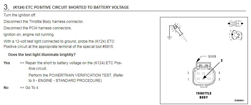

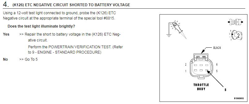

Unplugged TB and PCM connectors. Grounded the PCM connector and used test light connected to B+ on pin 3. Pin 3 illuminates green.
Performed same test changing position on PCM connector to associate with pin 5. Pin 5 illuminates test light green.

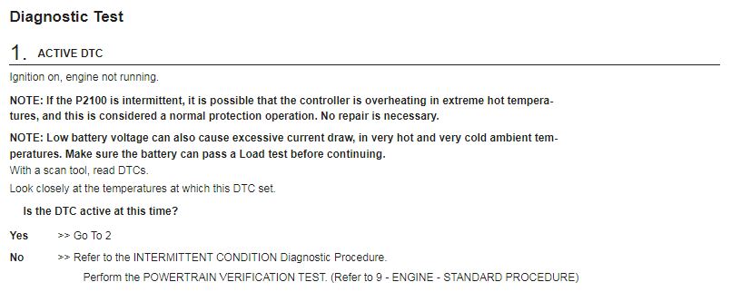

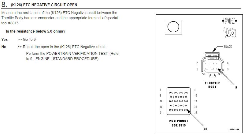

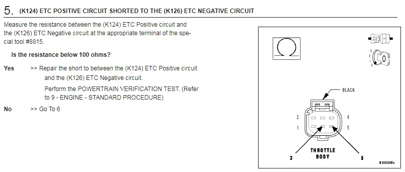

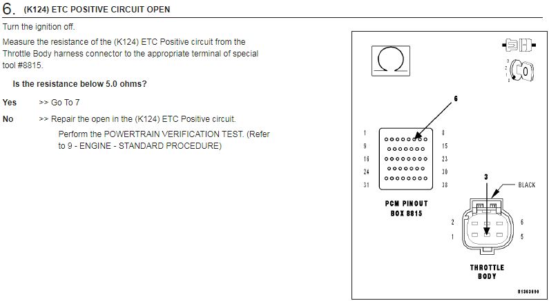

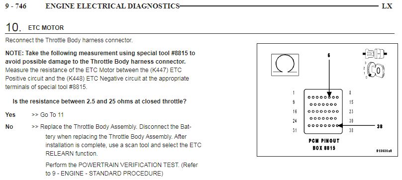

So I found a post that contained troubleshooting for a Chrysler 300c / Dodge Magnum. Different vehicles but the concepts appear to be the same from across vehicles as I see the same steps for PT Cruiser and Jeep Wrangler. Pins on the both connectors are the same. The only variance appears to be the Ohms when measuring the actual TB on step 10. Here are my results.
Test 1
pass
Test 2
pass
Test 3
pass
Test 4
pass
Test 5
No Reading (Multimeter did not change)
Edit
I'm not sure that I am doing this correctly. I have both the TB connector and PCM unplugged. Then I am connecting my multimeter to the relevant pins for ETC + and ETC - on the PCM connector. But since the connector at the TB is disconnected wouldn't that be the reason I don't have a response on the multimeter? Should I jump the pins on the TB connector? I tried this same test with the TB connector connected at it shows a resistance of 06.5 when set to 200 on my MM.
Test 1
pass
Test 2
pass
Test 3
pass
Test 4
pass
Test 5

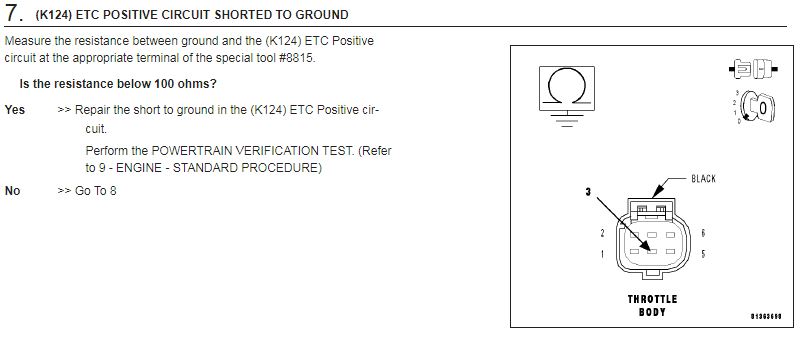

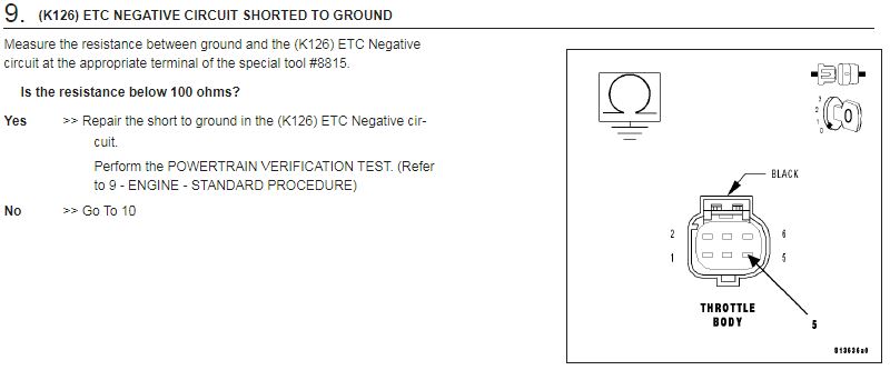

8 years 1 week ago - 8 years 1 week ago #24242
by StupidRalph
Test 6
pass (00.4 when set to 200 on multimeter)
Test 7
EDIT:Connected jumper wire from PCM ETC (+) pin to known ground on transmission. One end of MM probe on ground and other end on ETC (+) reads 00.4
Test 8
Test 9
No Reading (Multimenter did not change)
EDIT:Connected jumper wire from PCM ETC (-) pin to known ground on transmission. One end of MM probe on ground and other end on ETC (-) reads 00.4

Went back and read all previous posts to ensure I've done all steps requested. I do believe I have. I hate to jump the gun with the additional testing but only did so due to no response. Any feedback would be appreciated.
Addendum
Just wanted to add that the test may be skewed as well now b/c its no longer a hard fault as it is not giving the P2100 DTC. So for intermittent issues, I remember Paul saying to look for vibration and heat. So I didn't see any heat issues with my contact points. So I drove around and she performed without issue. I was able to turn vehicle off / on and continue to drive without issue. I then decided to locate several speed bumps and a more coarse terrain to which after I powered the car off and turned it back on symptoms reappeared.
Addendum

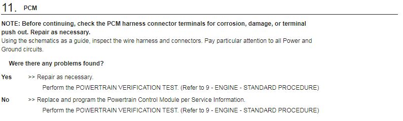

Just wanted to tie up this issue. Mechanic replaced wires and PCM. More than likely only issue was with PCM based on previous test. I now have a check engine light but no longer in limp mode and accelerates normally. Hopefully they'll clear up the few DTCs and I'll be on my way.
