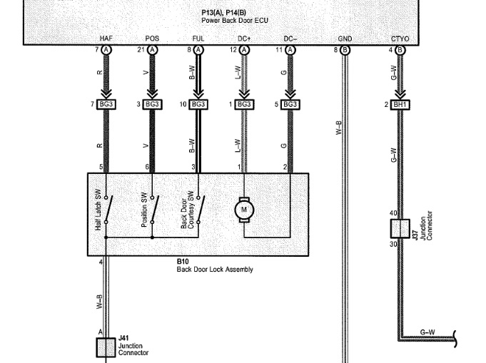

anyone who has a wiring diagram for a 2011 Toyota Sienna CE/LE 3.3L rear trunk switch/lock mechanism? Thank you in advance.

10 years 1 month ago #2246 by Tyler
Replied by Tyler on topic rear trunk lock switch diagram
Tried to find one here at home, nothing for a 2011 :( The best I could come up with was a 2009:
The body style changed in 2010, so this probably won't be any good... I'll take another shot at this tomorrow.
10 years 1 month ago - 10 years 1 month ago #2252 by 1mouse3
Replied by 1mouse3 on topic rear trunk lock switch diagram
I can only one up you but what I see for the other locks on a 11 it might not be right as well :dry:

10 years 1 month ago #2258 by robert.lesaca
Replied by robert.lesaca on topic rear trunk lock switch diagram
thanks a lot Tyler...something to start with and I'm pretty sure even if altered per model year it wil exhibit the same configuration. Awesome and a million thanks again !!!

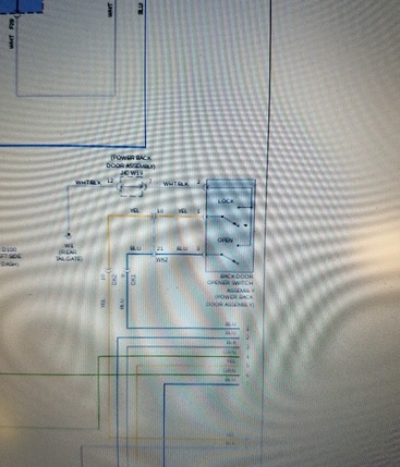

10 years 1 month ago #2290 by Tyler
As if this wasn't confusing enough, here's a shot I grabbed from Mitchell yesterday:
Apologies for the quality. This was the only mention of the rear door lock that I could find ANYWHERE in the four page diagram. Couldn't see an actuator or a module :unsure:
