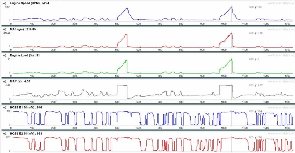

Looking at your data captures, and I'm somewhat confused. It lists short and long term trims for B1 and... B3? That might make sense if they meant B2, but no engine that came with the 2000 Malibu has bank-to-bank fuel control :huh: In the North American market, anyway. What is the engine size?
The values associated with the trim PIDs are unusual, as well. At one point I saw 97% on a long term? No fuel control strategy is gonna allow for that much correction. It may be that those trim numbers are actually Global-specific PIDs related to the O2 sensor signals. I can grab some data off my car and explain these PIDs better later on.
I'm also thinking along the lines of a plugged catalytic converter, especially considering the misfire history and possible rich condition. Scan data could definitely help point us in the right direction. If you can, use the Enhanced data to capture some PIDs during a WOT acceleration through first and second gears. Here's a ScanShare link to a known good capture with the stuff we're interested in:
www.scanshare.io/share/PthKNw1SfUGJnZW7S...1,2,3,4,5,6,7,8,9,10
In case that doesn't work, we're looking for MAF, MAP, TPS, engine speed, Load, upstream O2 sensor, and fuel trims. Watching those PIDs on a WOT run will definitely expose a breathing problem if there is one.
This ScannerDanner video also explains the test we're doing, and what the results mean. The make/model and problem are different from yours, but the test itself is the same:

As far as the WOT throttle test, I have a few questions/ issues.
In the Enhanced functions on my scan tool * android phone with blue tooth adapter and car gauge pro*, I can only see fuel trims for bank 1. I have always gotten * NO DATA* for bank 2, and the banks are properly labeled as such * B1+ B2* in the enhanced functions, its only oddly mislabeled as Bank 3 ( bank 2) in the global parameters.
Also, There's a TPS parameter to view however its stuck at *0 %* no matter throttle position. My engine size is a 3.1 V6. I also thought the values for the parameters were odd, as I thought the max correction allowed is no more than 25 percent. Also, good to know about those codes.
I have access to maf freq, maf airflow- gms/s, map pressure, map voltage, engine speed, load, half of fuel trims and O2 values.
Also i'm not getting any O2 sensor data for bank 2, only bank 1, with an os2s2 value as well, i take this to be the downstream o2 sensor.
if I am ok with these parameters, Can I give it a shot? WOT in 1st and second gears....??
ALSO, why is it important that we perform this test during 1st and second?

This is part of the reason I was somewhat confused earlier - this engine doesn't use bank-to-bank fuel control, so there shouldn't be any fuel trim data for bank 2 OR bank 3. By bank-to-bank, I mean that this engine doesn't have separate upstream O2 sensors for each bank of the engine. One upstream O2 for all six cylinders, one downstream O2, one short term and one long term fuel trim.
That's odd, too. No offense meant here, but I'm pretty suspicious of that Car Gauge Pro software now. I've heard good things about Torque, maybe give that a try?
Perfect. The MAF frequency, MAP voltage, engine speed, Load, fuel trims and the upstream O2 would be ideal for the WOT test.
Good to go B) Safely, of course. Doing it at WOT in first and second is important because it heavily loads the engine, asking a lot of the fuel system AND the engines breathing ability. The overall idea is to determine if a lack of fuel is causing the hesitation/poor acceleration, or a breathing problem. It's not a pinpoint test, but it will point us in the right direction for further diagnostics.
As an example, here's a shot of a known good '01 Silverado 5.3L doing the same test:
www.scanshare.io/share/PthKNw1SfUGJnZW7SEl4Og#0,1,2,4,5,6

Here;s a really brief video showing the parameters during WOT ( or kinda WOT). I really didn't feel comfortable doing this test given the age and condition of the car. . Hopefully its enough. RPMS sky rocket but the car takes a second or two or 3 or four to respond it seems. The car does a lot of gurgling and stuttering, really struggling to get out of its way. Seems like its misfiring..

at the 24 second mark your at 4700 rpm's and the maf g/s is only at 95. seems low

9 years 10 months ago #2506 by cheryl hartkorn
Replied by cheryl hartkorn on topic 2000 Chevy Malibu acceleration issue
are you doing a w.o.t test in a lower gear? or just in drive??
  • Donnyten
  • Donnyten's Avatar Topic Author
9 years 10 months ago - 9 years 10 months ago #2508 by Donnyten
Replied by Donnyten on topic 2000 Chevy Malibu acceleration issue
Yes I am. doing it fro ma dead stop at a stop light. switching from gears 1-2 as suggested ( not manually, but letting the car auto change gears of course)
Last edit: 9 years 10 months ago by Donnyten.
9 years 10 months ago #2510 by Noah
Replied by Noah on topic 2000 Chevy Malibu acceleration issue
.Hopefully its enough. RPMS sky rocket but the car takes a second or two or 3 or four to respond it seems. The car does a lot of gurgling and stuttering, really struggling to get out of its way
Uh oh! The delayed engagement sounds like a transmission problem.
Have you checked the trans fluid level and condition lately?
That could also account for a "no power" scenario. If the car is stuck in say 3rd gear on take off, or doesn't kick down under acceleration, it will just bog right down and not get out of its own way. A transmission slipping will have very poor acceleration as well. The RPM will continue to climb, but you won't be gaining any speed
