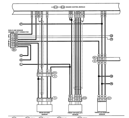

So I looked up the wiring diagram for your '03 Outback, and was very surprised to find a wideband air/fuel upstream sensor.
Depending on which wire you were probing, that 300mV reading you saw may be entirely normal. It sounds like you were on the sensor signal wire based on your description. :huh: I'm not super familiar with Subaru A/F sensors. Where was your scope ground connected?
At this point, I think you'll need scan data to make a definitive call on your P0420. :( If that's not an option, then you can try observing your downstream O2 signal wire during a highway cruise with the engine warmed up. If you see the downstream signal switching rapidly, then it's game over for the cat. That also means that you're very likely to be in closed loop, since the downstream sensor wouldn't be able to switch across stoichiometric if the fuel trims weren't keeping the mix there.

I'm not sure that wiring diagram is correct - my upstream sensor has four wires. It does appear to be a wideband sensor though. It's a Denso, PN on it is 22641AA140, which corresponds to Denso 2349015.
I used an all purpose digital storage scope and probed the two signal wires (white and blue) taking one of them as ground. I tried it again last night with a DVM, same result, 300mV between the two signal wires. I did measure each signal wire to ground; 1.9V and 2.19 V, using the intake manifold as my ground. The difference voltage across the two signal wires did change when disconnecting a vacuum line from the intake manifold, increasing, then settling back to 300mV with the vacuum line still disconnected.

8 years 5 months ago #20911 by Tyler
Replied by Tyler on topic Conditions for Closed Loop
Nice, thanks paulsomlo. B) That's what we needed to know. It's definitely an A/F sensor, just not the kind shown in the diagram.
