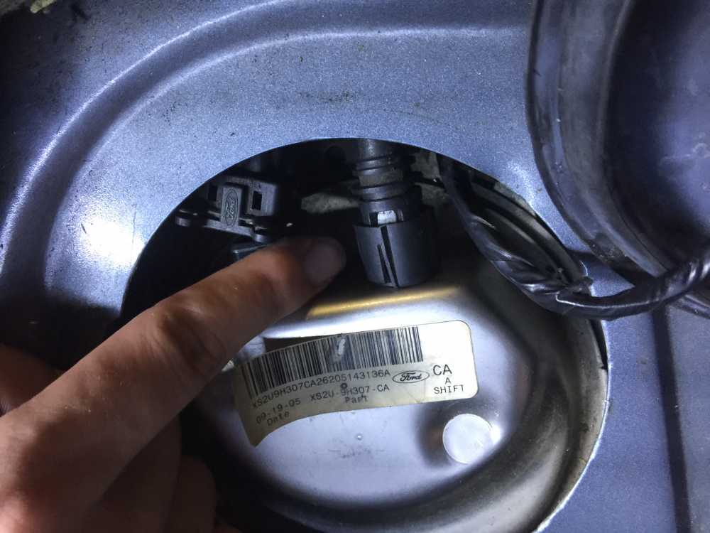

Hi Guys,
My son is working on replacing the fuel pump in his car (we confirmed using SD's diagnostic techniques that fuel pump is indeed bad). One problem he has run into is he cannot figure out how to disconnect the fuel line without breaking the connector (see pic). He is squeezing the tabs, and prying firmly (but not TOO firmly) on the plastic connector. It will slide out about 1/4 inch, but will not release. I am concerned if he pries too hard he will break the connector. Is there a trick or special tool needed for getting these off?
Thanks, Ron

9 years 11 months ago #2274 by Noah
Sometimes it helps if you press the line in as far as it will go, then squeeze the locking tabs, then pull the line out. I use a slight twisting motion when possible as well.

I like what Noah suggested. You can also try spraying a little lube into the connector to help get things moving.

Thx for the idea. Tried it, and as with all other techniques I have tried it will move just a bit and then it will not budge. It feels like something in there is just not releasing. I am concerned if I pry on it too hard I will break it, and then really have an open can of worms.

9 years 11 months ago #2313 by Noah
Just noticed the date on the sticker, second go around for this fuel pump.
North American market?

Yeah I noticed the sticker on the fuel pump also. Could be whoever did it previously did not clean the fuel tank.
9 years 11 months ago #2343 by Noah
Do you a have a small pick tool you can probe around inside the connector? You may be able to feel the releasing mechanism and gently release it/them while wiggling the line.

I ended up paying a mobile mechanic $75 to come over and disconnect the thing. In the end it was a matter of squeezing the tabs with the collar properly oriented, and wiggling and pulling until it came off. Yeah I had to spend a little money, but it was worth it because I likely would have broken it.

Yes, there are two different engine and two different fuel systems on these cars according to what I have read. The connector type on my son's car is, I believe, associated with the returnless fuel system. The dual, colored connectors are associated with the return system. But yeah, I had gone through quite a few videos online and never did find a situation with my exact setup.
