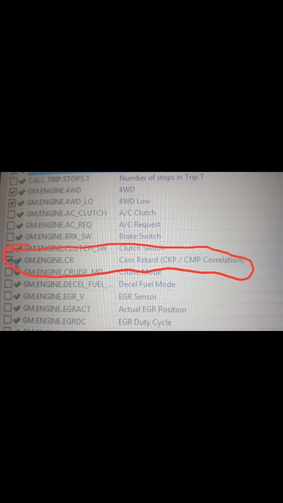

I have an elmscan 5 that I use with my laptop. I think I found the pid for adjusting the can retard , but wanted to verify. Got the suburban up and running , but this value says the timing is at 24 degrees !

I think that's the one. :cheer: Don't forget to raise the engine speed above 1000 RPM to update that PID during adjustment.

Tyler wrote: I think that's the one. :cheer: Don't forget to raise the engine speed above 1000 RPM to update that PID during adjustment.
It is set, only took 3 tries to set it properly :lol: It actually ran with timing that retarded.
