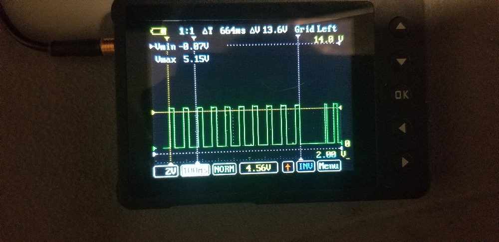

Long story short, I have a 1996 Firebird Trans Am with a p0336 trouble code. I have checked the power, ground, and signal coming from the sensor. The sensor has good power and ground going to it, and the sensor is producing a square wave like it should. I was wondering what the next step would be to diagnosing this problem, I am stumped. I have read on forums and some have said this can be due to a distributor fault, but I wasn't sure how to proceed from there. I don't want to rip the front of the engine apart without knowing for sure. So, if you have time in your busy schedule, I would be grateful for any guidance you are able to give... Thanks!

Did the wave look good on snap throttle tests?
