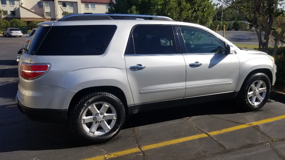

8 years 5 months ago #20993 by mjninke
Subject: 09 saturn outlook 3.6L GM LLT
Comments / Questions: I am out of options. I do not know what to do.
I drove my vehicle 1800 mi on a trip. I parked it 5 weeks and it will not start.
It has good battery, turns over fine, good fuel pressure, no codes.
It will not fire.
So I believe it is timing or ECM.
There is 150 psi in one of the front cyl that was tested.
I am sorry to bother you, but this car is 1200 mi from my house and I am at a loss what could have happened while parked!!!
Thanks in advance!!!
