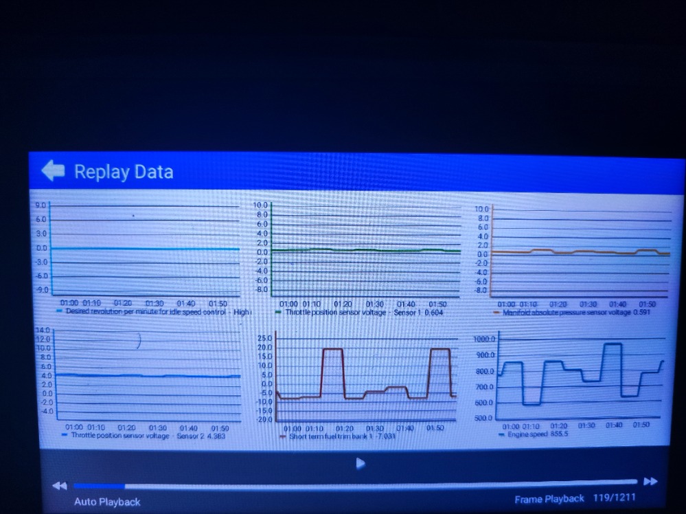

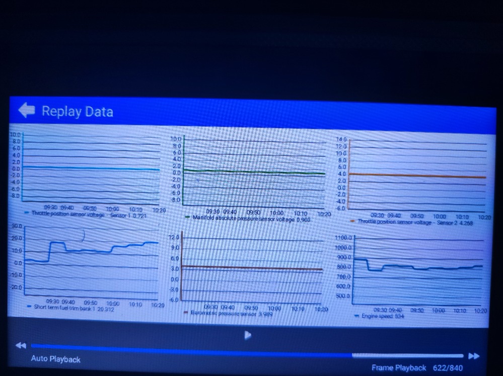

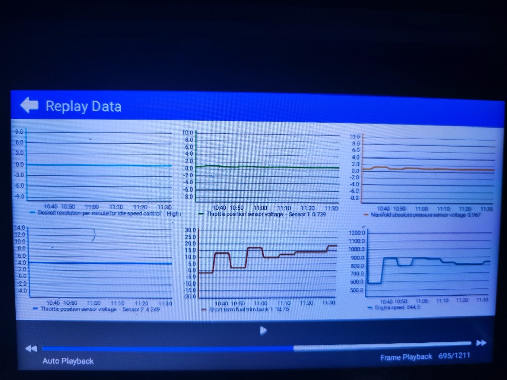

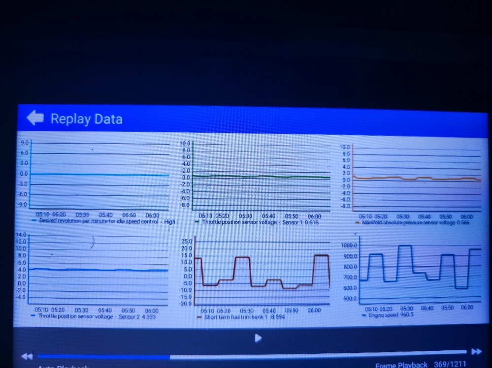

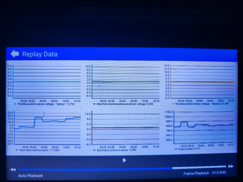

Hi! Thanks for getting back to me. Yes, I have access to scan data. I will drive around and look at the live data for those data points and report back. Thanks again.
- 23klicks
- Posts: 5
1 year 8 months ago #82744
by 23klicks
Replied by 23klicks on topic P0505-27 and P0420-00 2016 Land Rover Discovery Sport 2.0 Ford Ecoboost Engine
The only thing I'm seeing is the short fuel trim rising to +14, +17, and +20 and at the same time the Engine speed is rising. My guess is that the fuel trim is rising because the idle is surging and RPM's are increasing. The other PID's, are not spiking and they are just a flat line even when the idle surge is happening.
My scanner can only show 6 data points at once so I couldn't show the desired idle speed and the long term fuel trim. Also the desired idle speed did not have a value for me and it remained at 0...I think this is due to the limitations of my scan tool.

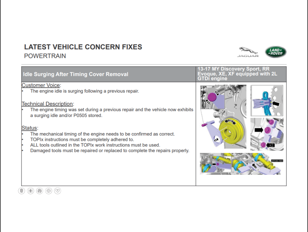

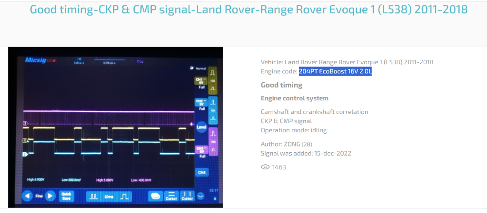

Tyler posted above that when the timing is incorrect on the 1.5 and 1.6 the idle surge happens.
Plugging Tyler's advice in Google revealed a Land Rover TSB re surging idle and the P0505 code. The TSB doesn't say P0505-27 but it does have the year of my Disco, 2016, with the GTDi motor, which I'm pretty sure is the Ford 2.0 Ecoboost.
I'm going to check the timing and compare it to a waveform I found on the net. You said the dealer already confirmed your timing was good? Well in that case I really don't know what else it could be.
