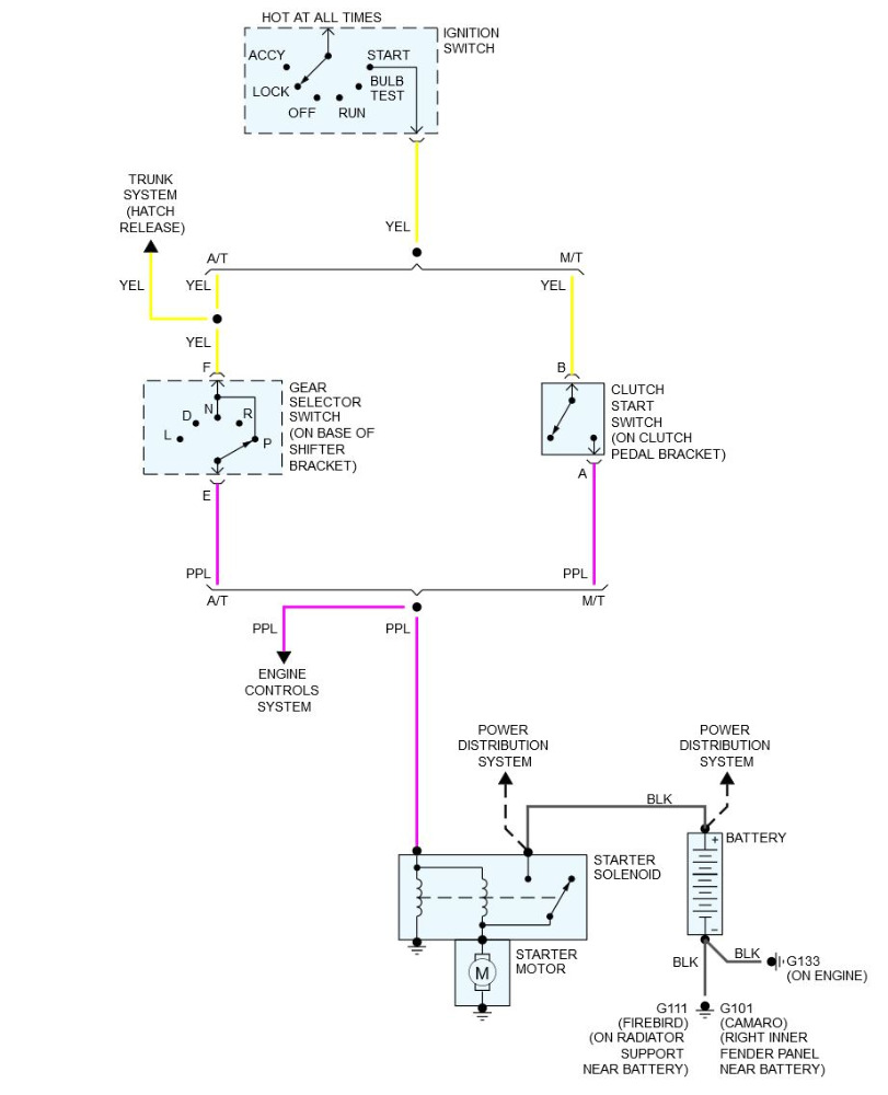

Are you sure this has VATS. I'm not seeing any reference to it in that year Camaro. Most models, other than Corvettes, didn't get VATS until 1989, I think. I'm sure there are some exceptions. Here is a Starting Circuit diagram. Maybe this will help you get cranking.

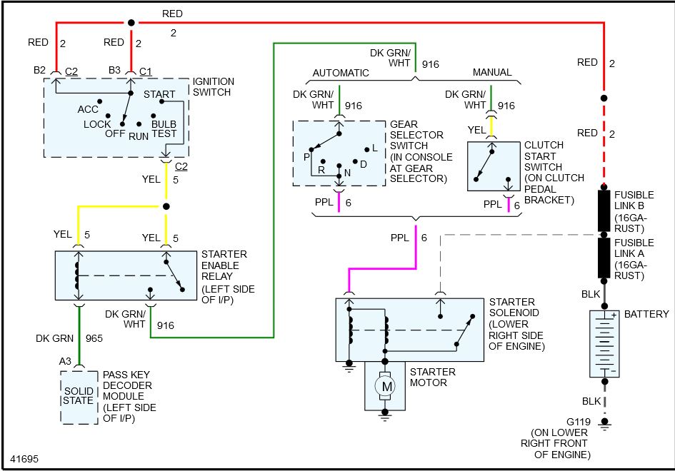

It looks like all you will have to due is eliminate the Starter Enable relay. I could be wrong, but I don't see where there is any fuel disabling involved. The hardest part will be to get to the relay. I have by-passed it on other GM's and it is very hard to find, if you don't know where it is. I can't say what you have, but on early 90's models, the relay is hidden behind the instrument cluster. The best way to get to it is thought the speaker hole on the top of the dash, below the windshield (even if there is no speaker). And even then, you have to fish for it. Looking at the schematic though, you should be able to activate the relay by grounding circuit 965.
Here is the schematic for 1989

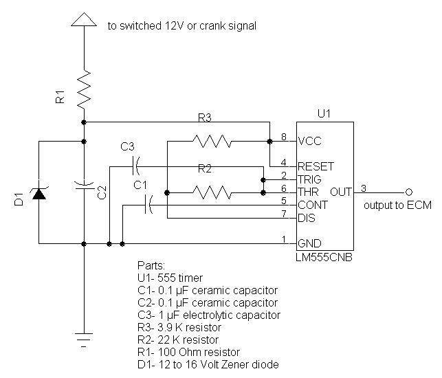

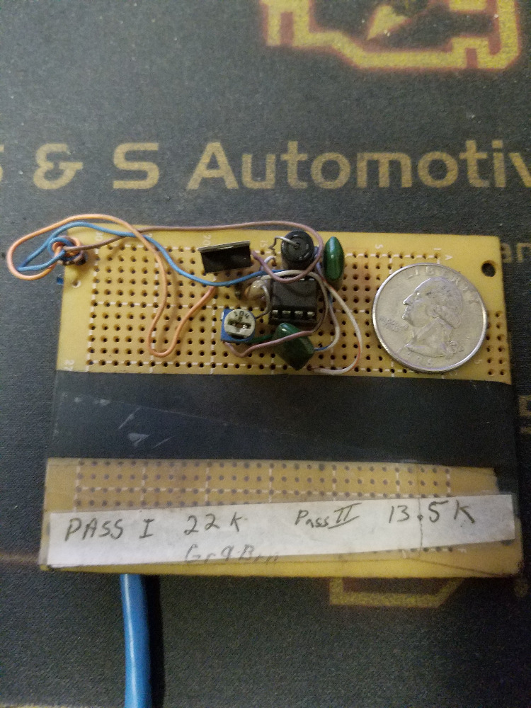

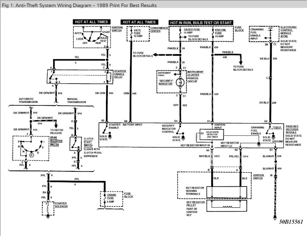

I can't find a complete Vats Diagram, but I see that it DOES have Circuit 229, a DK BLU wire. This is the Fuel Enable circuit. The ECM sends 5 volt ref to the VATS module. If everything checks out, the vats module pulses the 5 volt ref to ground at a frequency of 50 hz. With a 50% duty cycle, you should read 2.5 volts circuit 229 with a volt meter. That is the first thing to check. If you have 2.5 volts on circuit 229, your problem is probably something else. If you have any other reading, then you can blame the VATS module. If you DO need to by-pass the VATS, I can guide you through building a by-pass module, if you are handy with a soldering pencil. Alternatively, I can give you a link to order a by-pass module from the guy that figured out how to do it.

Yes. Bypass the starter enable relay and feed a 50 hz signal into the ECM on Circuit 229. The VATS module can be tossed out.

Gday Chad firstly thank you for all your time and effort so far, yes that is a very similar diagram i found aswell, bypassing the starter is not a problem but ye the other part sounds more complicated, the problem i am facing is this car is in the country 3hrs away from me, i've been there twice checking the basics so i need to arm myself with as much info as possible for next time i go there, but the part that really bothers me is the security light not lighting up which doesn't look good for the Vats system, i can see it has a fuse i did check all fuses but need to do it again to be sure. If its not too much trouble when you have time if you can please tell me how to build this bypass module and also a link to that dude that builds them please and i'll let the owner know and he can decide what to do next, thanks again for all your help, really appreciate it.
