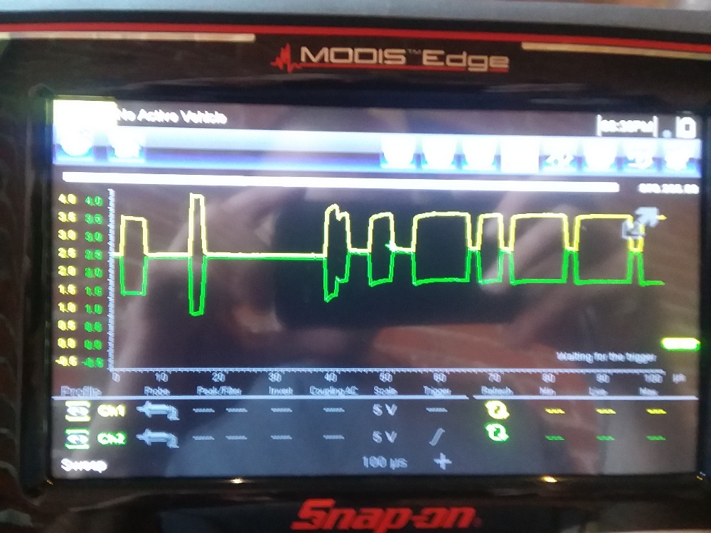

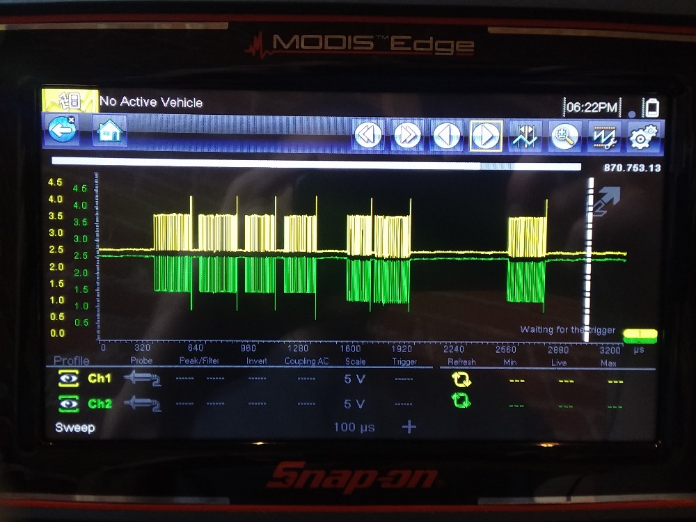

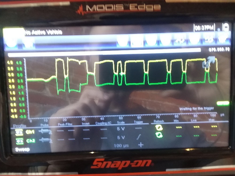

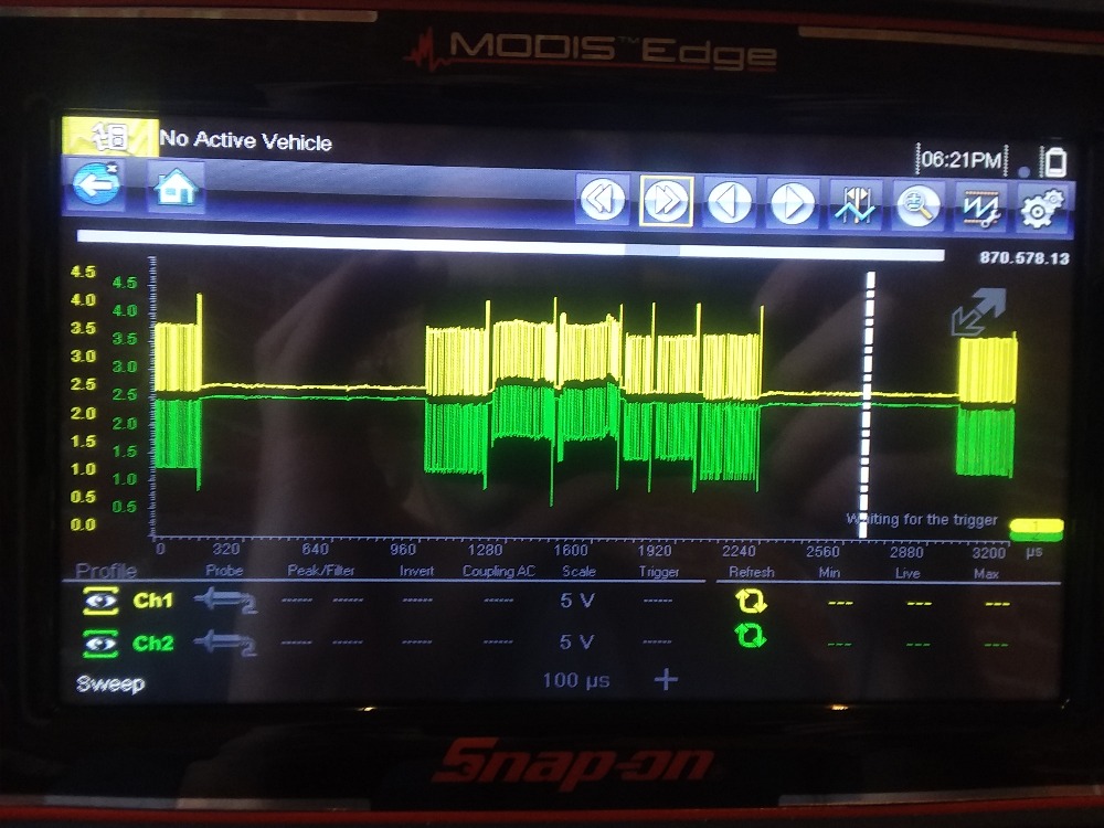

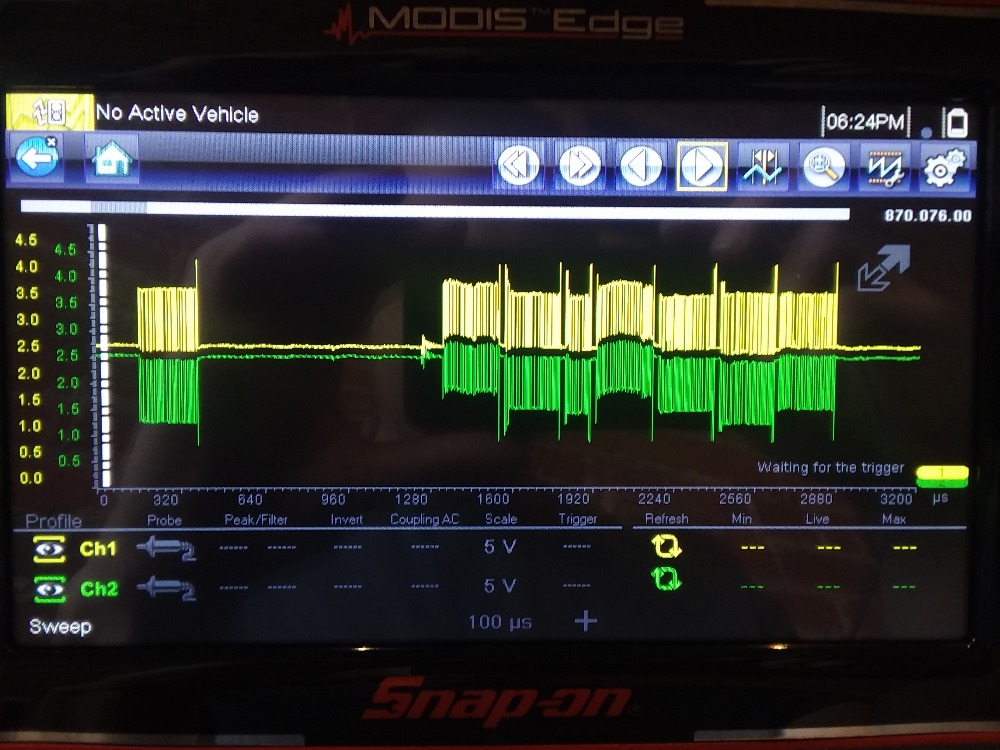

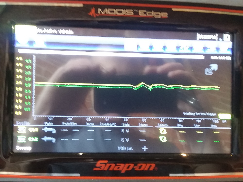

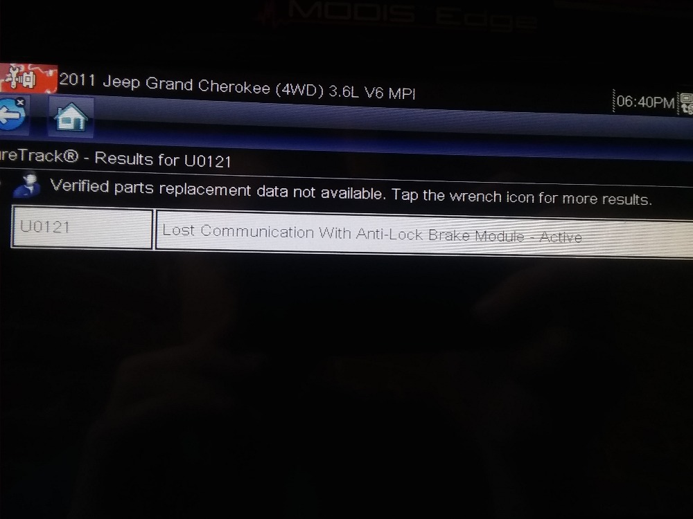

Hello everyone!

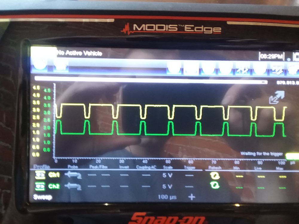

Reaching out in regards to CAN C BUS on a 2011 Jeep Grand Cherokee. I am new to a lab scope and CAN Network. ScannerDanner's CAN Network videos are what I am gaining exposure too. The shop I work at has been dealing with this vehicle for almost 2 weeks on an ABS concern. The ABS will not initialize properly to the vehicle and the ABS light will continue to flash on the cluster. ABS is unable to clear faults to adapt properly. The only fault stored in ABS is a VIN Mismatch/improper configuration. The technician has installed a new $300 ABS module and it did not fix it. Then a $900 TIPIM module (gateway) and concern is still present. SO, I took the opportunity and asked my boss if I could take a crack at it!! I am in need of some help with the CAN C network. I verified the powers and grounds for both ABS and Gateway. I am getting some weird looking CAN C signals. I also tried a cap discharge. The CAN C I am testing is communication from TIPIM and ABS. T- Resistance tested 60 ohms. Also, the PCM, TCM, SCCM, CCM, are on the same bus. Maybe try unplugging a module and monitor CAN C on scope for a change ? I uploaded some screen shots. Take a look guys! look forward to the responses!!! thanks you so much :)

To be clear, you've got an active U0121 in the TIPM, but you can communicate with the ABS module and get codes/data, correct? If so, I wouldn't sweat the network any more. IMO, those CAN signals may look a bit weird at some points? But you're also on a 100us timebase. Everything will look weird at 100us. :lol:
What are you using to initialize the new ABS module? The Modis Edge? If so, that may be part of the problem. I've had to initialize new and used ABS modules with my Modis before, and it's either an uphill struggle or didn't work at all. :silly: I bet that if you fix the VIN mismatch code, you'll fix the U0121.
Also, did the part numbers between the old and new ABS modules match? It sounds like a Captain Obvious thing, but the wrong module WILL bolt up and work, but never work properly. Ask me how I know!

8 years 5 months ago #21220 by bruce.oliver
Where are you tapping into the network for your CAN waveform?

bruce.oliver wrote: Where are you tapping into the network for your CAN waveform?
I am backprobing at the back of the TIPM connector. I also tested same CAN lines at the back of the ABS connector and had the same waveform reading.
