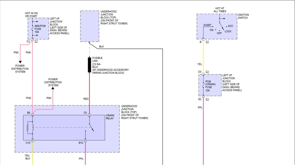

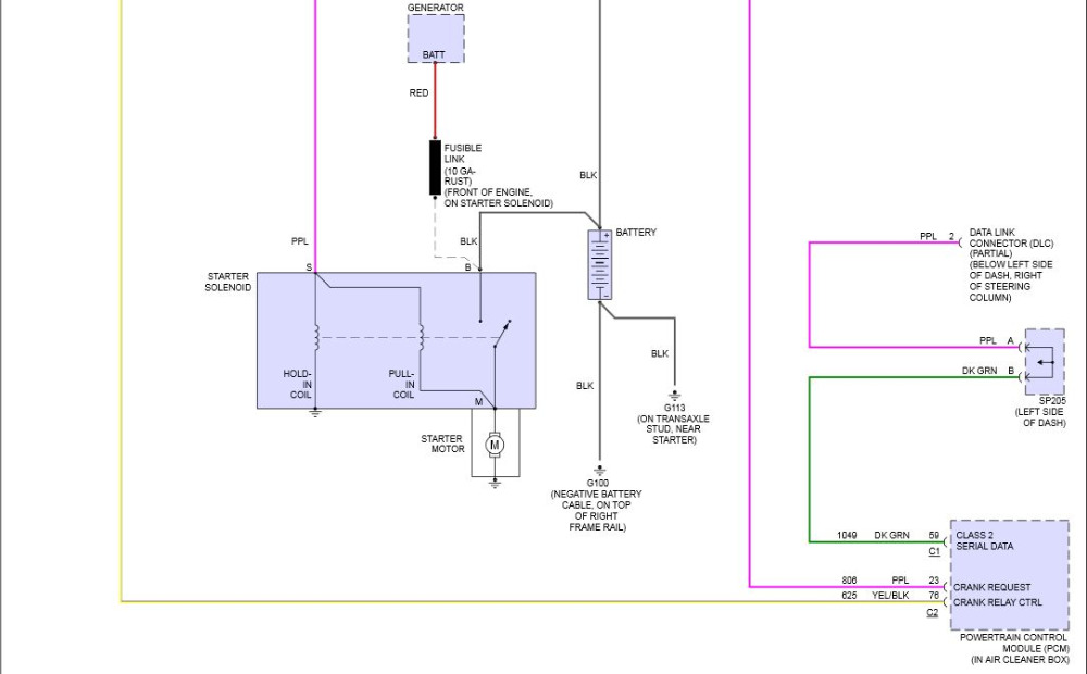

2005 impala ss 3.8 super charged no crank no start. when i got vehicle ignition had been replace for lost key wires for passlock had been cut not sure what all was done there were jumper wires not connect under hood and on floor under ignition switch . ran scanner no pcm codes one code for font wheel speed sensor can not communicate for srs. tested all fuse had bad fuse for fuel pump replaced ignition lock switch and housing from know good parts from 2004 grand am with bad timing chain try to reset security light for new key will not reset. starter turn if jump at tarter car wont star can hear fuel pump when key turn on tested crank fuse in left dash fuse box has 12v when in start position tried different crank relay under hood still no crank try to bypass crank relay not sure if done right still no crank car has no radio gauge cluster has light do not know if gauges work with no start not sure how to test bcm any help would be appreciated

do you have 2 power feeds at the relay? 1 hot at all times and a keyed one. also are you getting a switched ground from the pcm?

I have 12v cont 12v with key in start poss no ground switch signal from not sure if from bcm or pcm do not not were to check for ground switch circuit

thanks to all for replay I found yellow wire for resistor in key was broken fix and did key relearn and car started
