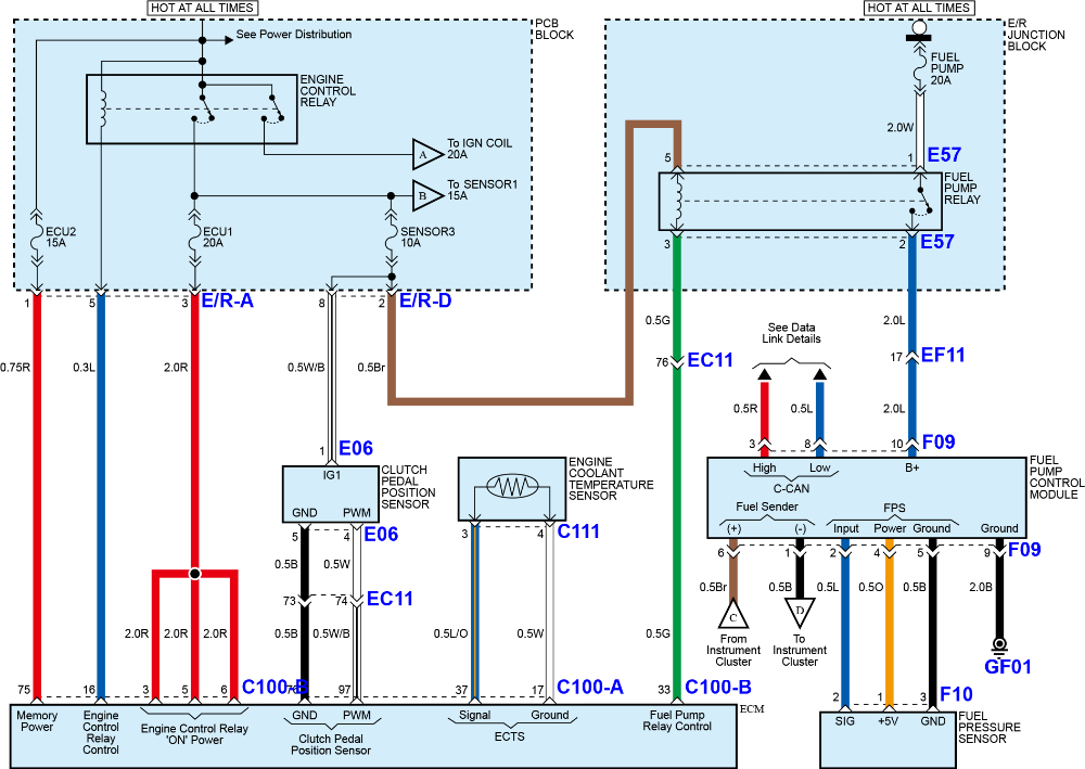

Replied by Noah on topic Readiness monitors won't set
Because the monitor will complete and then report not complete on the next start up, it sounds like the PCM is possibly missing a power feed, essentially resulting in a battery disconnect everytime you cycle the key.

1 year 8 months ago #83622
by ferris48
Returning back to this ECU 2 fuse. If the fuse is hot at all times according to the diagram, a voltage drop must be present across the fuse with the key out of the vehicle to retain the memory. If the voltage drop is zero maybe it's a broken wire to the ECM.

So I just checked the fuse and it's reading 11.8 volts with the engine off
