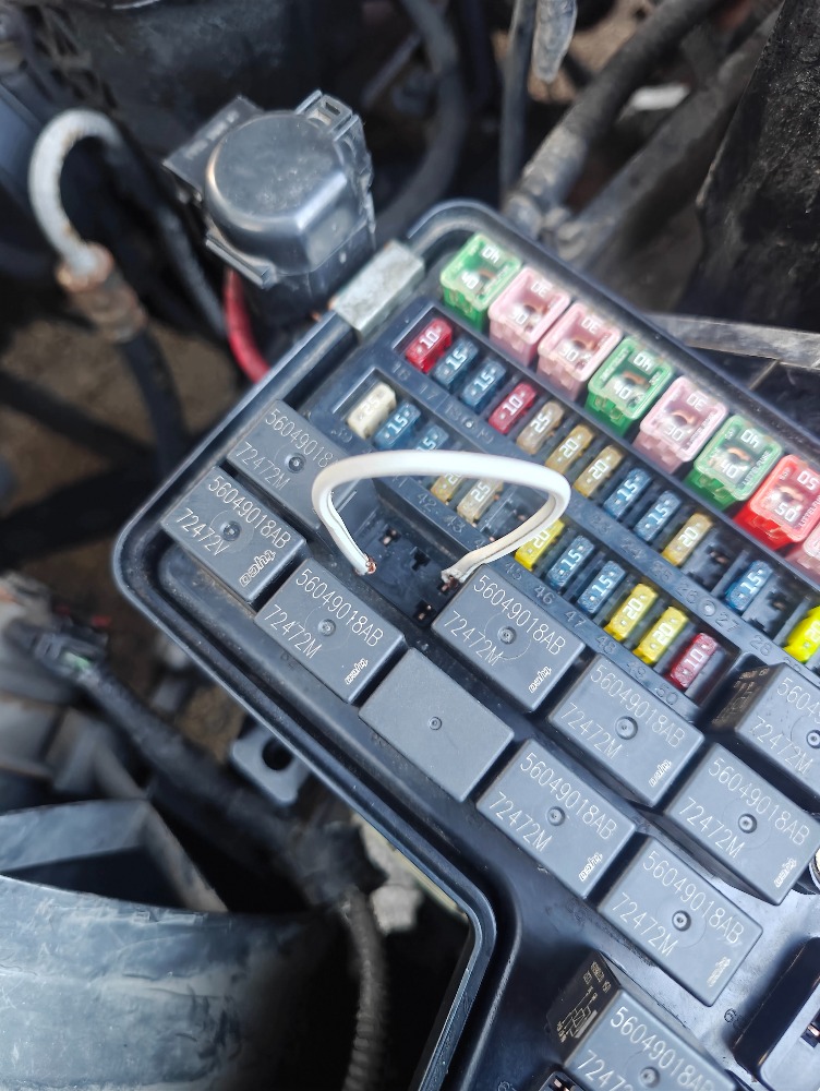

I then decided to jump pin slots 85 & 87 with a wire. The gauges all work and the truck starts. I removed the wire and truck stops. I know I'm getting close. Weather is bad in Chicago/cold. I work in spurts then run in the house to thaw off. Not sure what cables to check next as I have no diagram. Trying to get one from my mechanic. I'm not sure at this point if it's a cable, tipm/fuse box, or PCM/ECM issue.

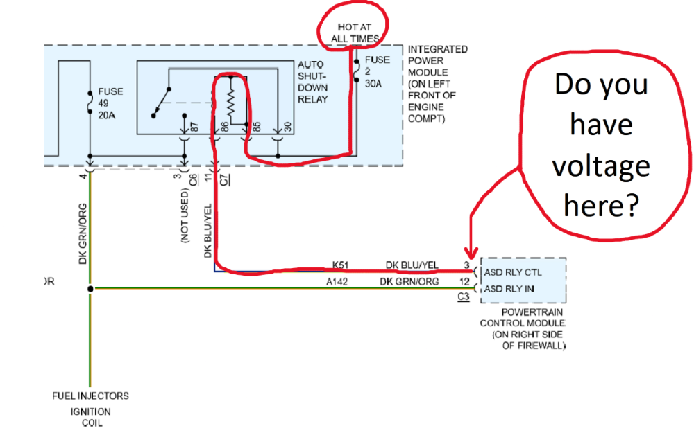

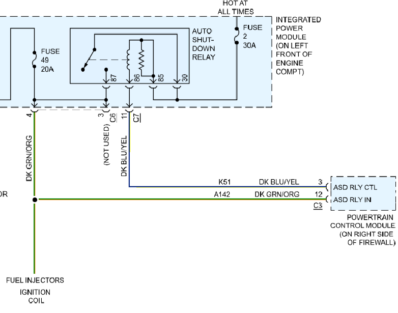

The problem is between terminal 86 of the ASD relay socket and pin 3 at the PCM C3 connector. The PCM should provide a ground for 3 seconds at key on engine off, then switch off, and a full ground while engine is cranking and running. I don't believe you have a crank sensor issue otherwise your fuel pump would not run.
KOEO and terminal 86 inside the relay socket should light a test light connected to battery positive for 3 seconds. If that doesn't work, check this wire at the PCM. If you install the ASD relay back in, the battery voltage should make its way back to the PCM pin 3, C3, if wiring integrity is good from the fuse box to the PCM.

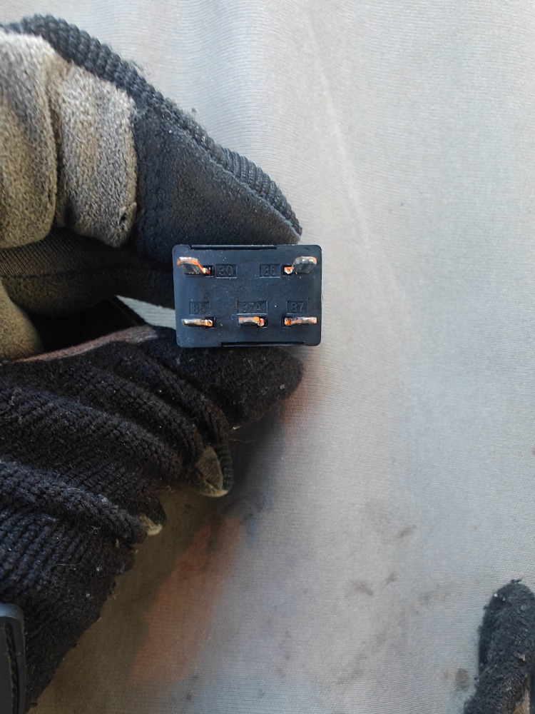

I also want to add that I just realized the pins I bypassed or jumped with the wire were pins 30 to 87 on relay #57. Not what I had above. I'm not sure if this changes everything but I needed to add this. Also, when I tested the pins in the TIPM/fuse box pins 30 and 85 power without ignition on. With ignition on pins 30, 85, 86 power with pin 87 nothing/ground.

1 year 8 months ago #83403 by ferris48
Replied by ferris48 on topic 2002 Dodge Ram 1500 5.9L Crank no start
Were those tests done with a test light or multimeter and was the relay out of the box?
86 should not have power. If you had the relay installed, remove it and check 86 again. If the relay was removed, how many volts did it have and can it light a test light?
I've condensed the wiring diagram for easier viewing.

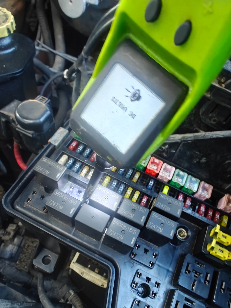

1 year 8 months ago - 1 year 8 months ago #84165 by Brainfriedtoo
Replied by Brainfriedtoo on topic 2002 Dodge Ram 1500 5.9L Crank no start

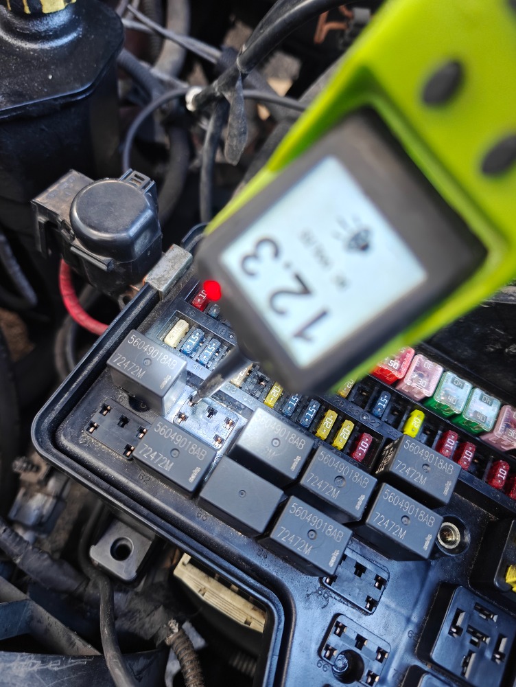

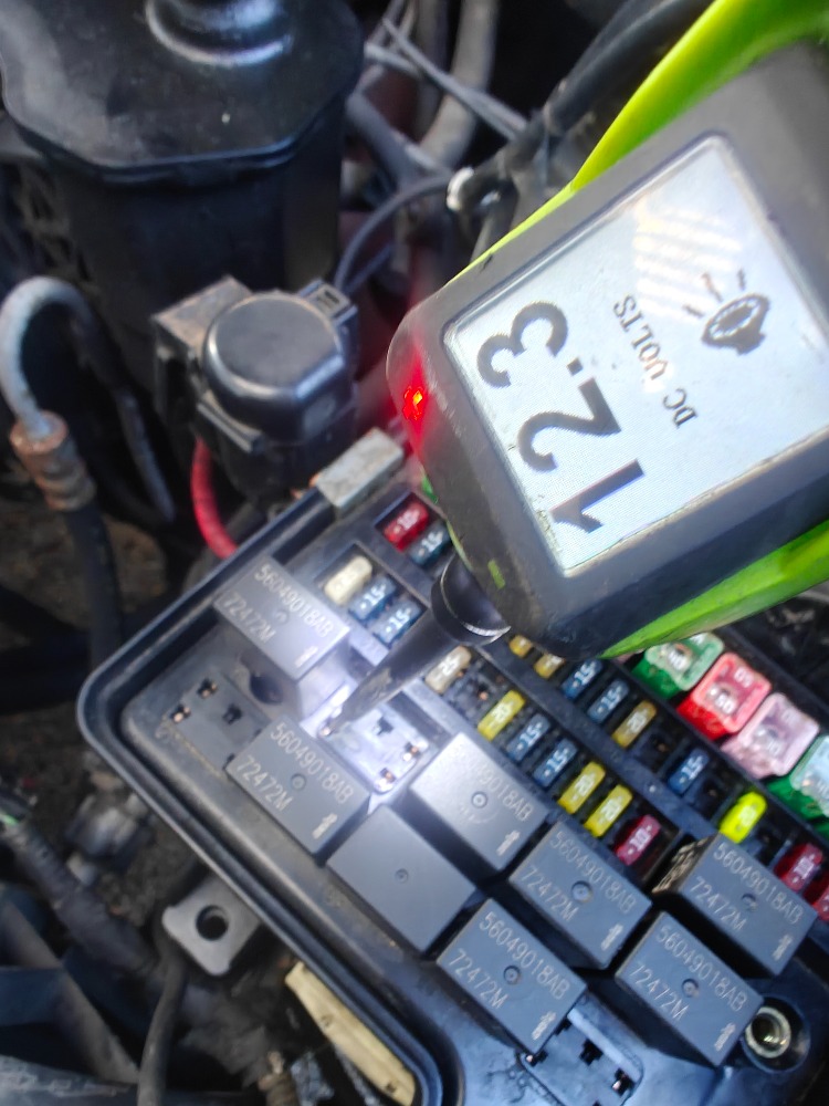

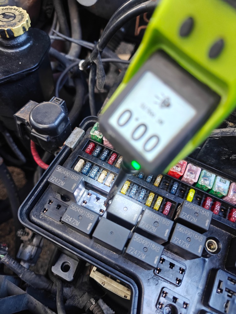

@ferris48 I'm back and confused now. I used a test light without relay installed. Tested Pin 30 & 85 light up with ignition off. I then turned it to the on position and no light on pin 87 where I did before. I moved the light cable to the positive side of the battery then tested pin 86 and nothing.
I then used a power probe . Tested pins 30 & 85 power 12.3. then tested pin 87 which showed 0 beep ground. Then I tried pin 86 and got nothing even while trying to crank it
I'll add pictures. Hopefully this makes sense. I wanted to add an update. I'll look at your diagram next.
Also, I want to add that I tried another fuse box and got the same results. Only works when I use wire between pins  30 & 87

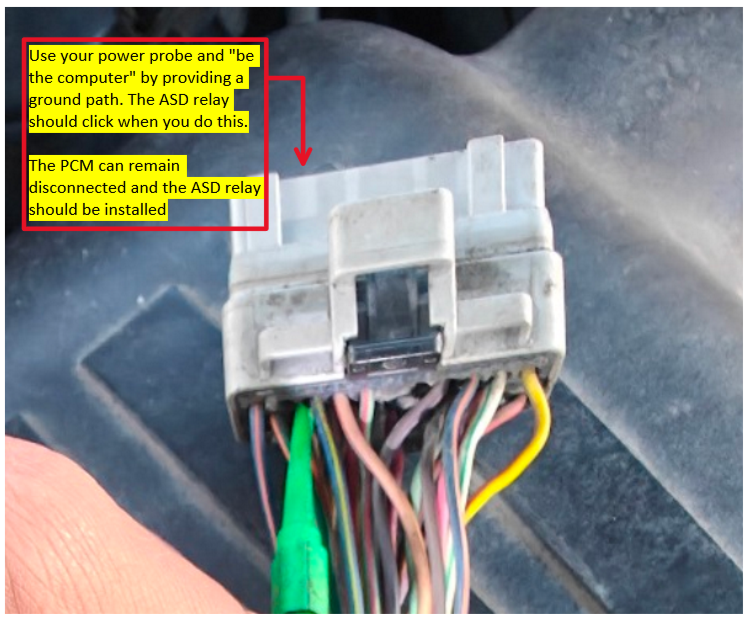

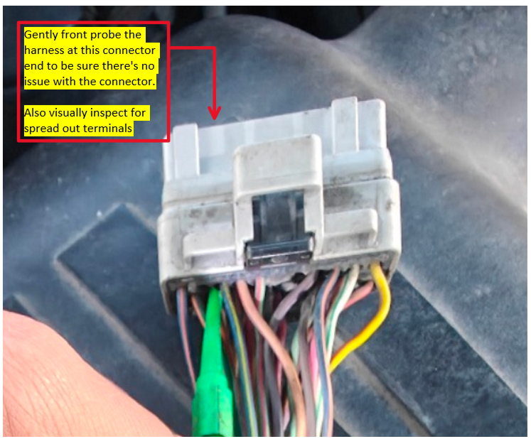

1 year 8 months ago - 1 year 8 months ago #84180 by ferris48

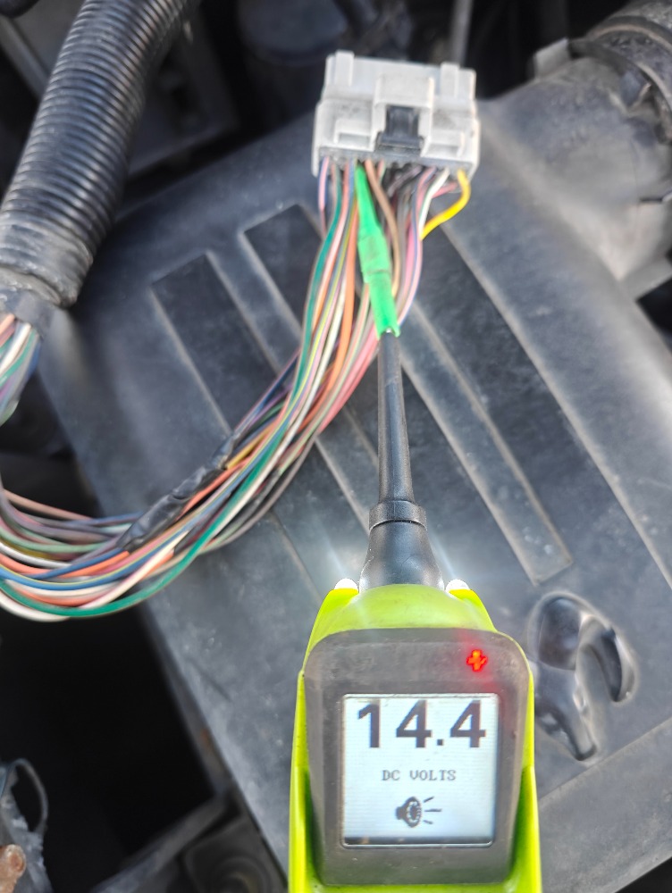

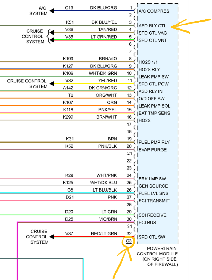

With the ASD relay installed and the key out of the truck, check for voltage at the PCM C3 connector (Service info says C3 should be a gray connector), terminal 3, a dark blue wire with yellow tracer. This wire should have voltage on it at the computer until the computer provides a ground. We can use this to check if the wire is intact all the way back to the engine computer. You can disconnect the engine computer for this test and you can front probe, back probe or use wire piercers for this check. Once you've identified the wire, and it has battery voltage on it, which it should, it should go out if you remove the ASD relay if you've correctly identified the wire at the PCM harness.
Last edit: 1 year 8 months ago by ferris48. Reason: added pcm pic

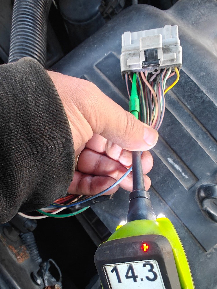

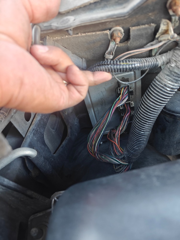

1 year 7 months ago - 1 year 7 months ago #84411 by Brainfriedtoo
@ferris48 sorry for the delay with work and weather not cooperating I finally was able to check this out. I believe I was able to locate the cable. I have power on the blue/yellow cable on gray connector going to ECM pin 3. When I remove the relay I get no power at pin 3. So I believe I found the correct cable per your instructions. Not sure on next step? Bypass still works when I use a wire. I will add pics. Thanks!!! Oh and my connectors are gray, white, and black top down on ECM
Last edit: 1 year 7 months ago by Brainfriedtoo.
1 year 7 months ago #84421 by Monde
Replied by Monde on topic 2002 Dodge Ram 1500 5.9L Crank no start
14.4 v with key off? Are you using a battery maintainer?
Do you maintain the voltage with key on or in the start position? If yes, the PCM is not controlling the relay.
Does the tach bounce or does the scanner show an increase in RPM during cranking?

Hello, and thanks for the feedback. I did have the battery connected to a battery charger. I forgot to remove it before testing. The key was also in the off position. So the voltage seen is with the key off. When I get home I will try with the key on and crank to see if numbers change. I will also check what numbers show when the key is in the on position.
I will post results soon.

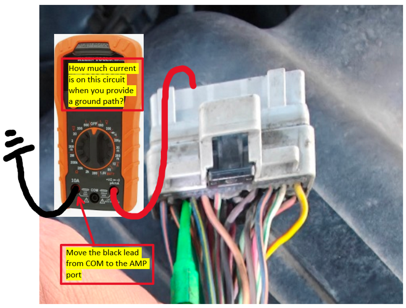

1 year 7 months ago #84437 by ferris48

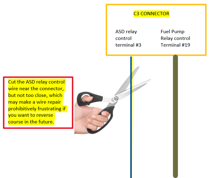

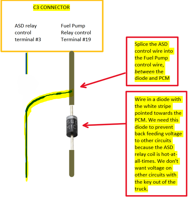

Let me state that i'm not a mechanic by profession and the following is not an approved form of repair. From what I'm reading so far your engine computer's bad because it's not grounding the ASD relay. I posted a wiring diagram and powers are on Connector C1, pin 2 and 22. Grounds are on pins 31 and 32, same connector.  Check those. Give the harness a good shake and make sure any reading you take stays rock steady. I know it's a shitty repair job but I think this hack job of a repair may just work.
Here's the link to the wiring diagram again: pdfhost.io/v/dcpD9Daid_2002_Dodge_Ram_1500_59L

1 year 7 months ago #84444 by ferris48
Well Connector 3 was the one you were working on, Connector 2 is the one in the middle, so Connector 1 has got to be the other, other one, right? :)
As for which diode to get i'm not sure either. I'm just familiar with the electrical symbol on the schematic I never had to handle one myself. My guess is to pick one that's rated for the current draw on the circuit. Would choosing a 10 amp diode for a 1 amp circuit be overkill, i don't know.
Anyways, I don't know the current draw of the control side of a relay coil off the top of my head. Perhaps your current reading will tell us exactly how many amps is on the ASD control circuit. Then take that number and multiply it by 2 because the fuel pump driver will be doing double duty with the addition of the ASD relay in parallel.

1 year 7 months ago - 1 year 7 months ago #84446 by Brainfriedtoo
😉 I figured this would be the case after I sent the reply. I'm going to reply in one as @Monde also provided feedback
@Monde I removed the battery charger and tested again o c3 pin 3 with a 12.5 reading. When cranking the reading dropped to 11. Nothing moved with the rpms. On the dash I see the rpm needle move from below zero to Zero when the key is turned to the on position but does nothing when cracking.
@ferris48 I checked the connector and pin 3 looks fine. I did add a ground as you suggested and I could hear the relay clicking. I also tried to get amps but not sure if I did it correctly. I'll add pics but I wasn't getting a reading.
I also tested connector c1 pin 2 has power pin 22 showed numbers around 11 but my probe didn't beep like it did with pin 2. I think I need to spray something on this connector as I couldn't even push a pin into it. Pin 31 was ground but I don't have a port 32. The connector only goes to 31.
If it's the PCM then I'll try the diode. Maybe my mechanic has one I can have.
I'll wait for directions in order to make sure I tried everything before moving on to the hack 😆 it would be cheaper than looking for another PCM... Thanks again

If the truck runs when you ground the ASD relay, you may have to replace the PCM due to a bad transistor ( driver). The inputs are there. If not, the truck would have not run when the ASD relay were grounded.

Yeah, when I bypass pins 30 & 87 on the fuse box with a wire the gauges and fuel work and I'm able to start it. So does it sound like I should try the diode? I'll also check if I can find a repair place for PCM or a replacement of the PCM.... Thanks!
