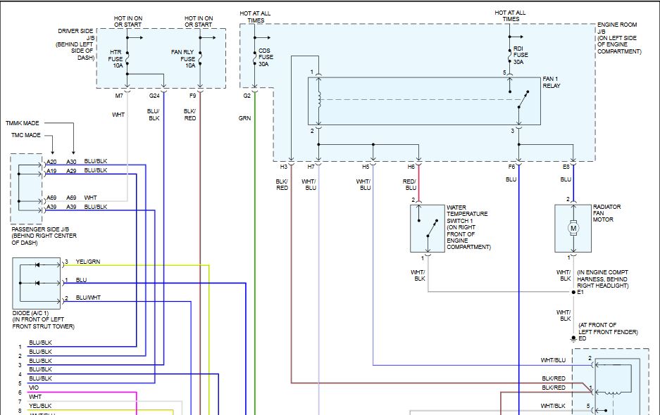

I’m looking for an A/C system wiring diagram for an 03 Toyota Camry v6. I’ve looked on BBB industries and their wiring diagram is trash. Any help would be greatly appreciated.

Replied by Chad on topic 2003 Toyota Camry V6 A/C Wiring Diagram
Automatic, or manual climate control?

Replied by ShrimplyPibbs on topic 2003 Toyota Camry V6 A/C Wiring Diagram
Manual climate control
