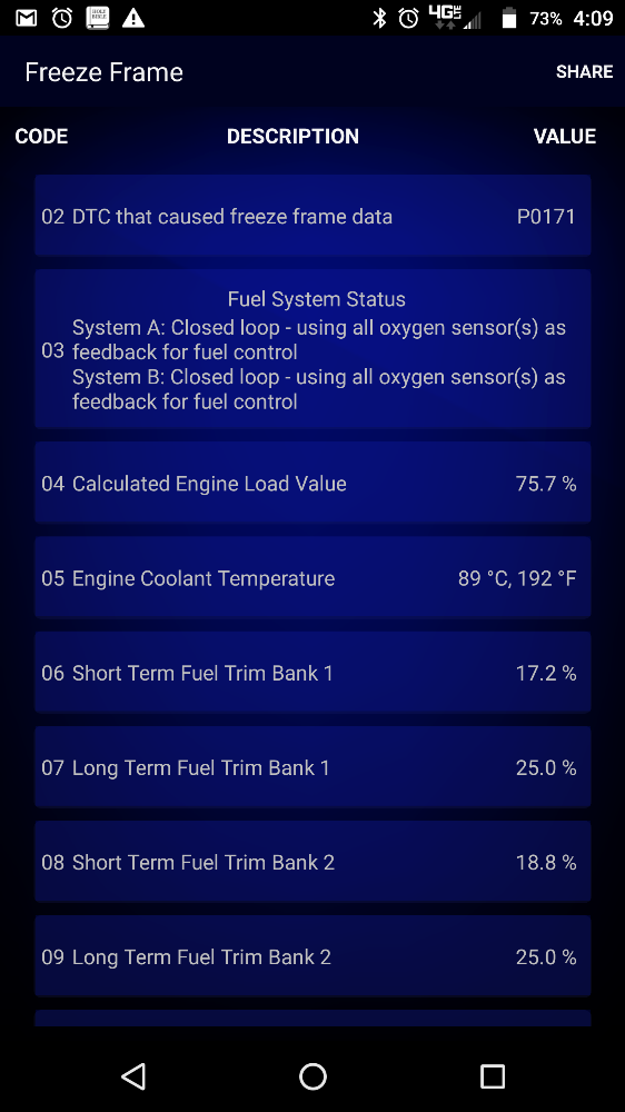

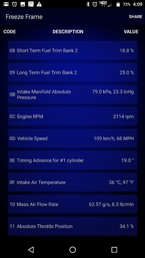

8 years 4 months ago #21492 by Wverwolf
2006 Silverado . 5.3 L. Below is the freeze frame for most recent, using blue driver. Truck will sputter when the temperature outside is above 80, and fuel level below half a tank, in drive or neutral. Will not sputter in park or reverse, has a smooth idle. Afew weeks ago it started, I stopped at fuel station, filled up and problem stopped. It doesn't always through a code. I checked all the intake hookups with ether, cleaned mass air flow, new gas cap, new air filter, throttle position sensor, gas pedal.
I've heard possible intake gaskets but with specific scenario when vehicle acts up has me confused. I'm thinking fuel system, either dirty injectors or weak fuel pump, being it quit after a fueling while vehicle running. alas I don't know how to interpret the freeze frame data.
Any help appreciated.
~craig
8 years 4 months ago #21494 by Ninjaxchicken
Replied by Ninjaxchicken on topic 06 Chevy intermittent p0171 and p0174 codes
Holy shit look at this fuel trims.... long term on both banks is buried and short term is almost there lol... no this is not s intake leak bc that freeze frame is at 2000 rpm under load and being bad.... both banks .... fuel delivery id say 100%% check ur fuel pressure... start the engine and rev it up high and watch for crazy drop outs

try pinching off ur brake booster hose and watch ur trim numbers. if no change it is quite possible you have clogged injectors on both banks .. although i dont think putting fuel in ur tank would help them possibilities . is that a returnless system ?

It really fits a fuel delivery issue, the fact it improved when the tank was filled with cool fresh fuel is a pointer, fuel pressure check would be a good move I would also look at the pump and filter . Because it dosen't occur in reverse or idle I would also closely examine the wiring harness to the injectors and ignition for any opens or shorts that might be caused by engine movement.

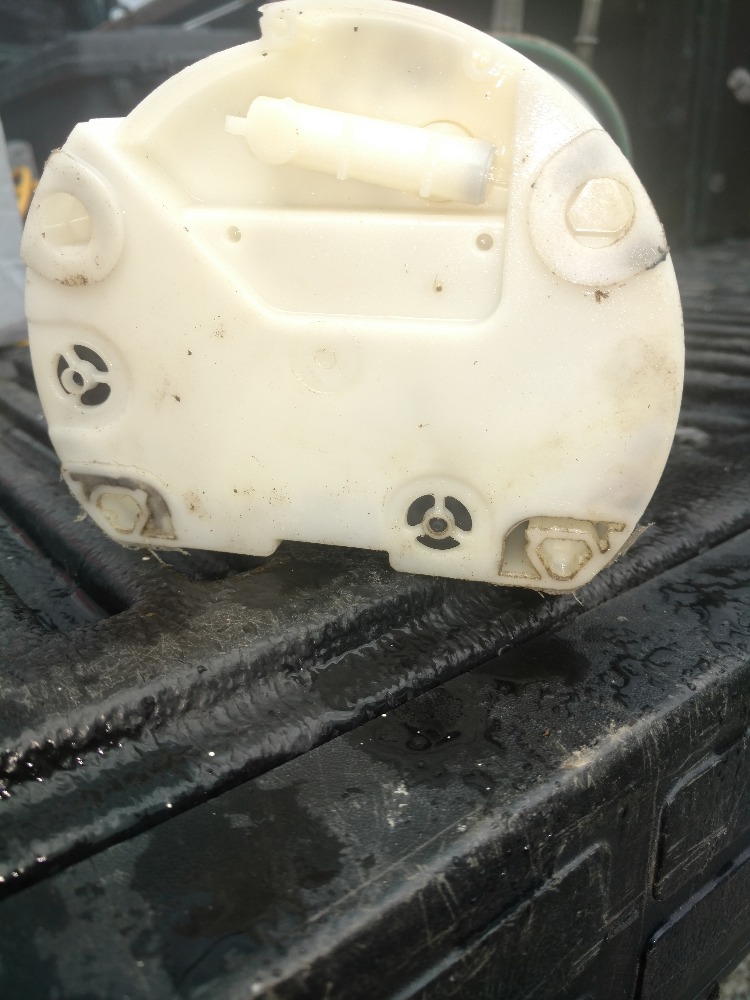

8 years 4 months ago #21638 by Wverwolf
Replied by Wverwolf on topic 06 Chevy intermittent p0171 and p0174 codes
Ok, thanks eveeyone, got the new pump in and it's working fine. I drained the fuel out of tank and replaced with cleaner fuel. Running fine. Will have to see if issue comes back in coming weeks. Old pump had a hole in the bottom of it allowing large debris to enter the bucket and get to the sock, the sock was completely covered with trash. If it happens again I'll check the ground and make sure it's secure and clean.
