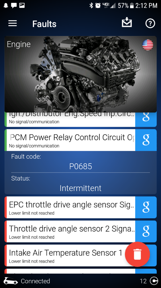

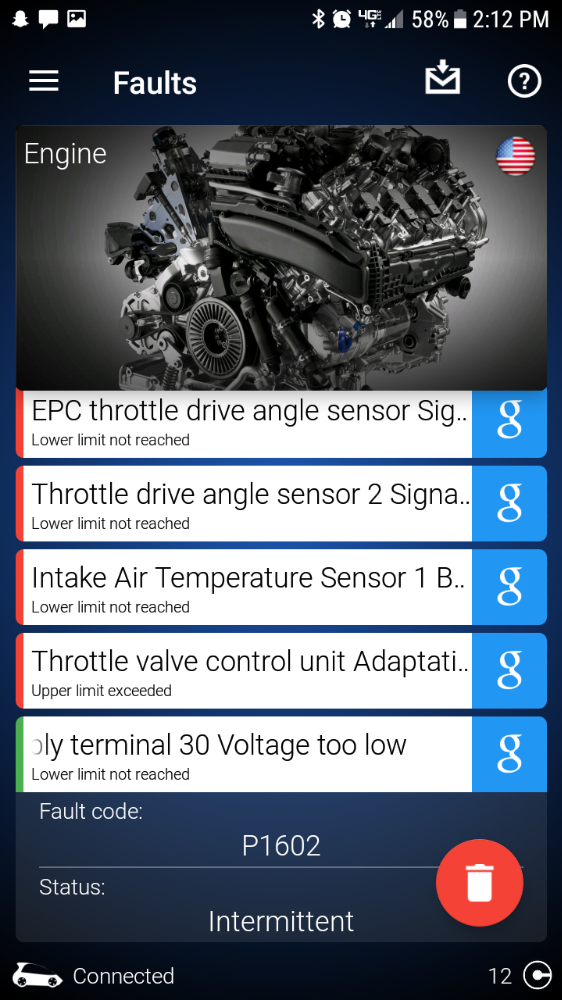

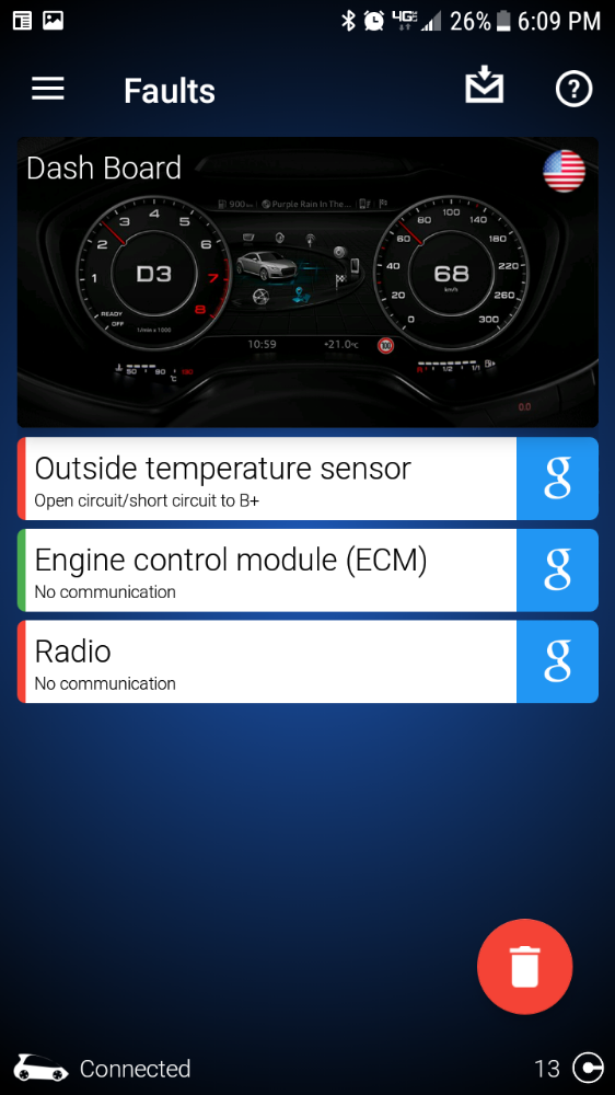

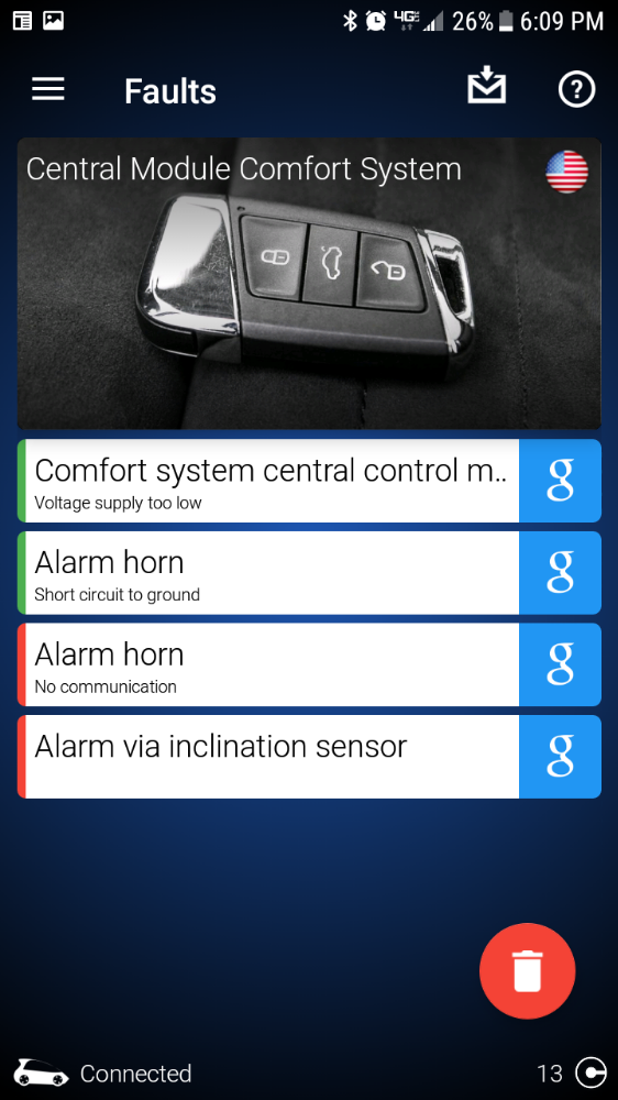

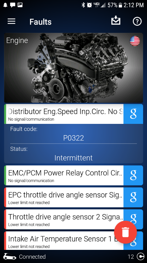

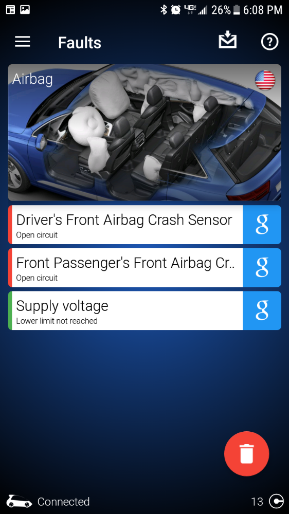

It has no codes through regular obd2 only has codes using obd11 scan tool. The main one I saw was low voltage to ecu and the fuel pump doesn't sound.

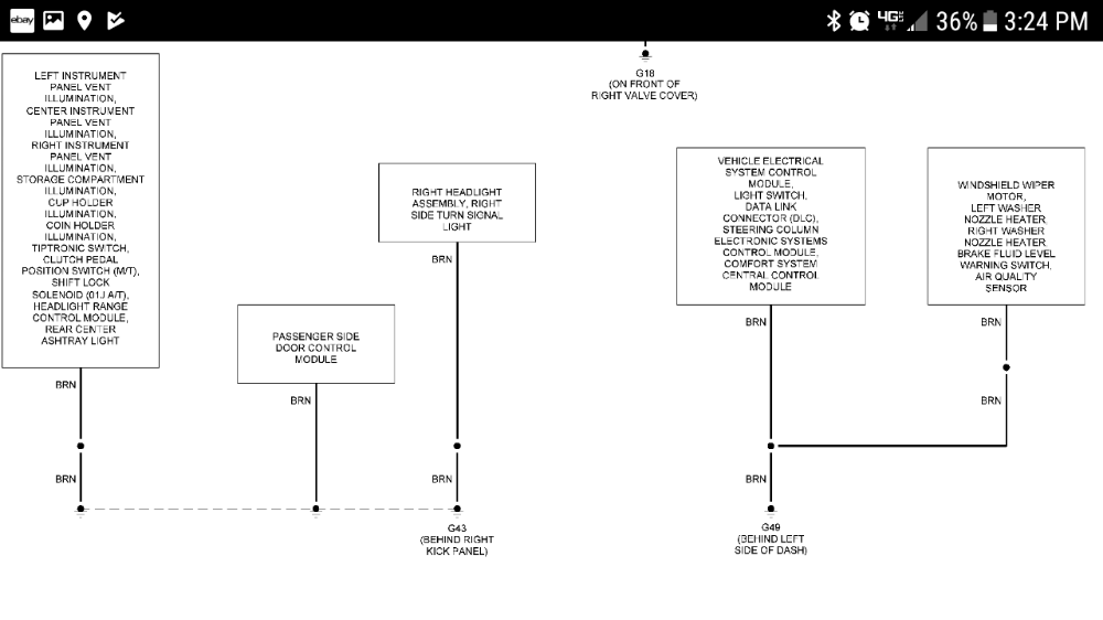

8 years 4 months ago - 8 years 4 months ago #21581 by Chad

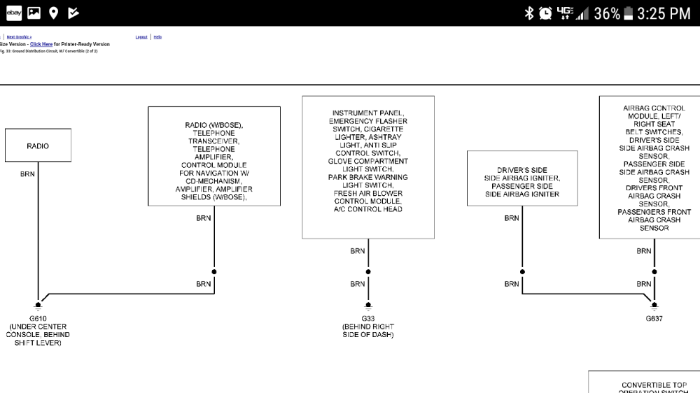

Replied by Chad on topic Short or bad ground problem

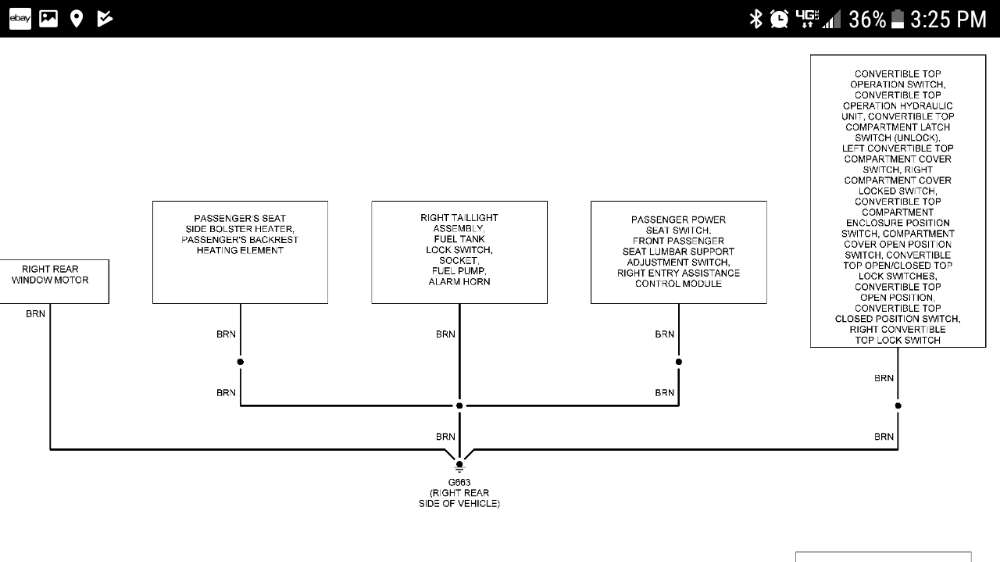

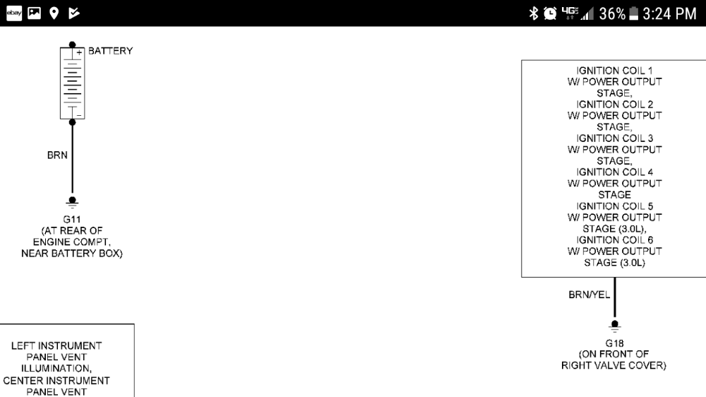

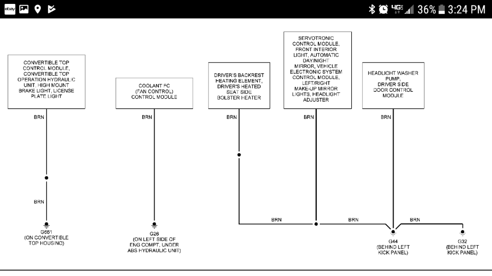

Do you have a ground distribution diagram? I think you have burnt 1, or more, grounds. You must have put the battery cable on very quickly, and completely, to avoid being showered with sparks instantly. Since you mentioned no sparks, I can only assume that smaller ground wires were burnt and acted as fuses.

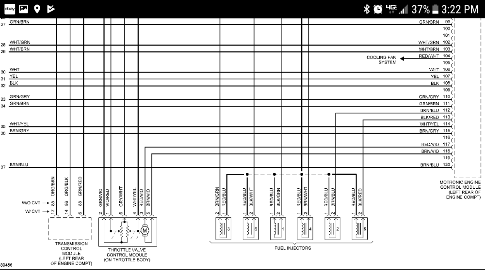

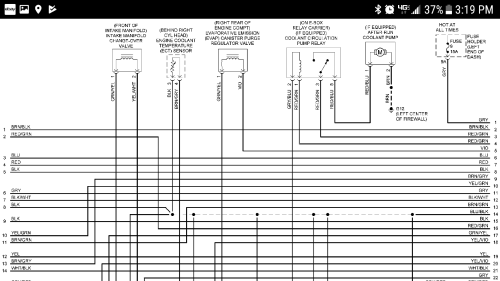

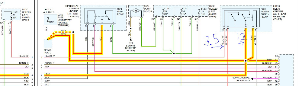

Only ground diagram I could find on Mitchell's but I have another I could post from another manual if this isn't good enough. I'm wondering would a bad relay cause a voltage drop? With the ecu relay unplugged I have a 12volt signal, the second I plug in the relay I get a drop to 3.52 volts when commanding the relay to close. Thanks for your interest in my problem!
8 years 4 months ago #21601 by Chad
Rotatingrotar89 wrote: I'm wondering would a bad relay cause a voltage drop? With the ecu relay unplugged I have a 12volt signal, the second I plug in the relay I get a drop to 3.52 volts when commanding the relay to close.
Yes, a bad relay could cause a voltage drop and it sounds like you have a bad relay. 12v going in and 3.52v coming out? On the load side?
8 years 4 months ago #21602 by Chad
Like this?
Or, are you saying the 12v going in on pins 1 and 2 is dropping to 3.52v? If the 12v on pins 1 and 2, of the relay, are losing voltage, then the problem is not the relay. The voltage drop is happening BEFORE the relay.
If the 3.52v is on pins 5 and 8, with 12v holding on pins 1 and 2, then the problem is the relay.

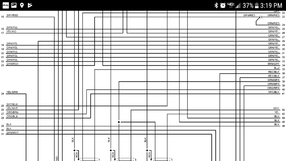

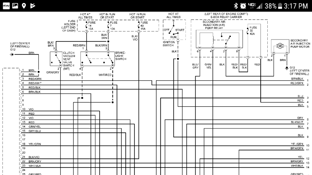

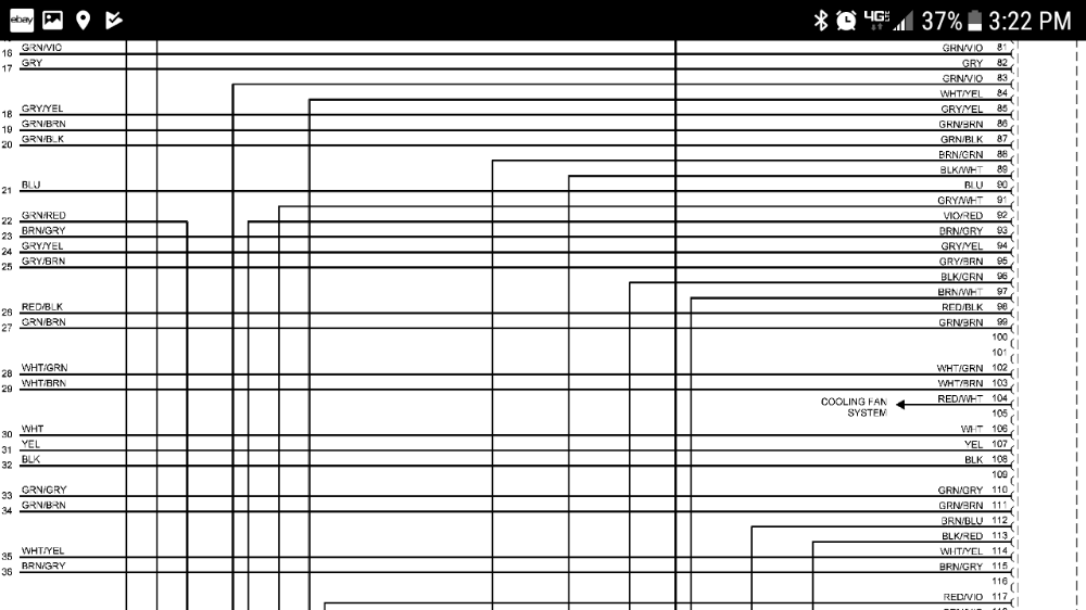

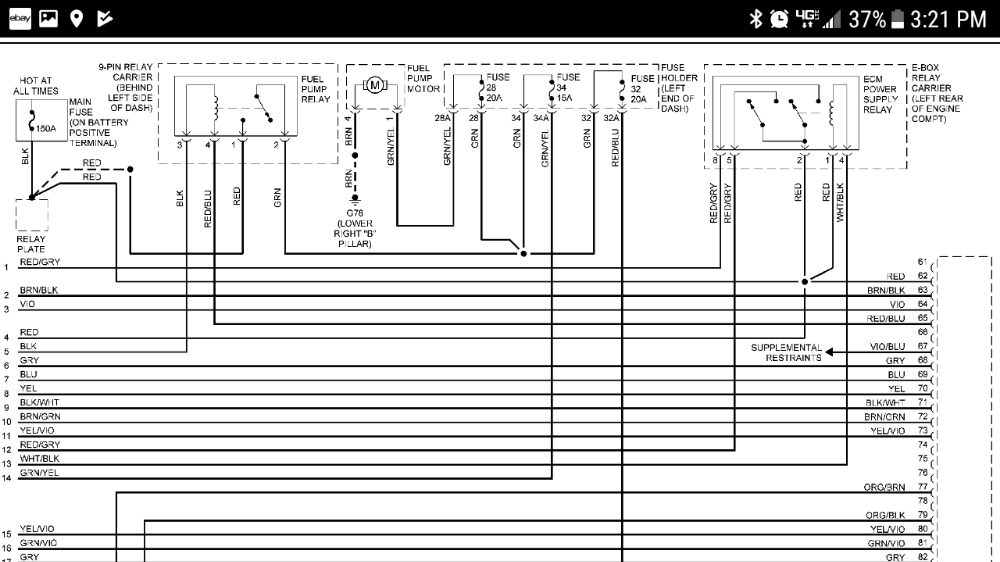

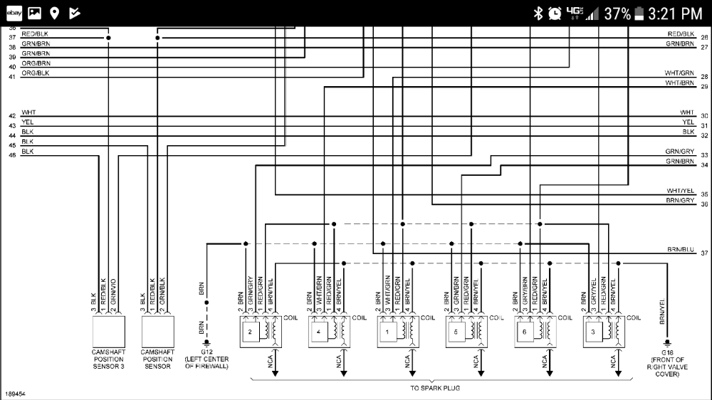

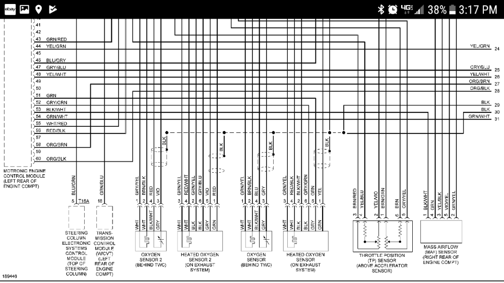

3.0 v6 engine performance schematic page 1 and 2 out of 4
Voltage drop on ecu relay when grounded with a test light
When I wired the starter incorrectly I did have sparks on the negative batt terminal and heard sparks or electrical circuits near the starter
I already replaced the started and solenoid.

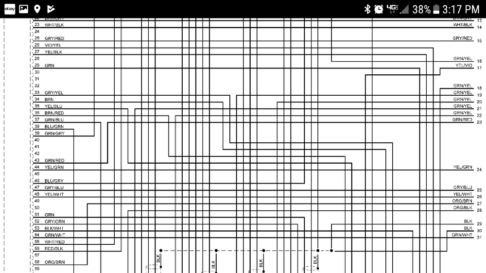

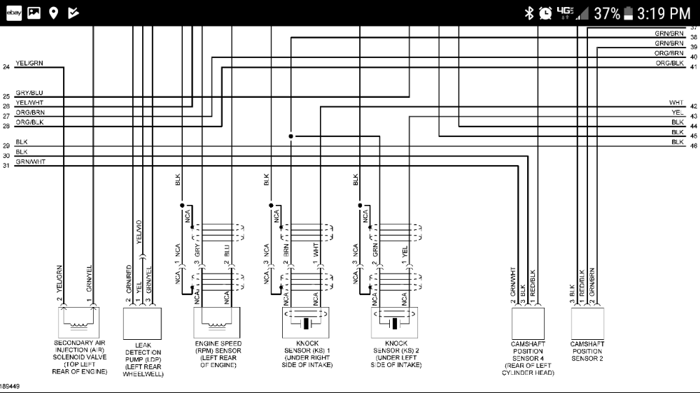

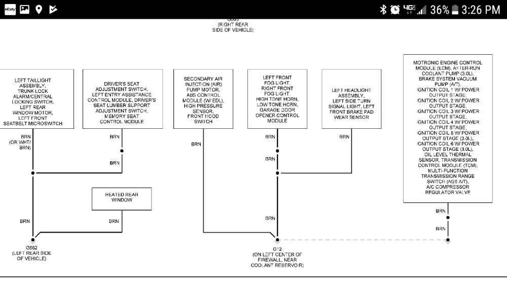

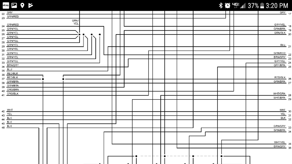

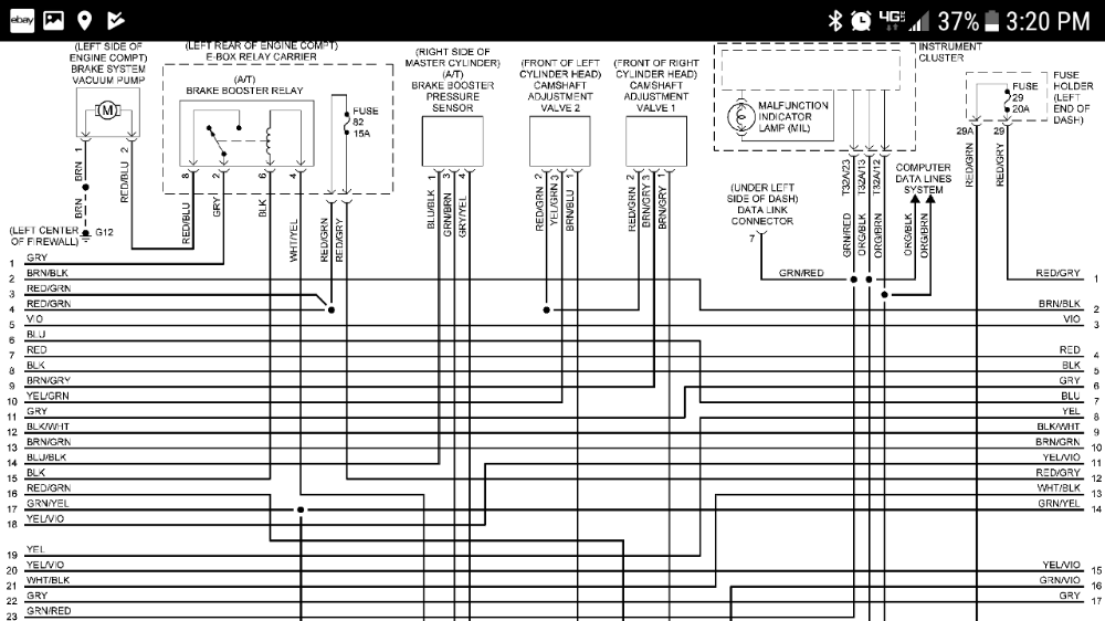

3.0 engine performance schematic pg 3 and 4

Thank you pole71! Just gives me a little more confidence that it's the relay I mean I tested it... it clicked...did a continuity test and it passed. Just kinda curious on why it would be causing such a drop or how the relay failed. Opened up the relay had no markings burn etc.
The low side of the relay 1 and 2 are good no issues there but yes you understood perfectly the high side of the relay5 and 6 is dropping once grounded out by the ecu or with a test light. I'll purchase a relay and let ya know if it fixed my situation
