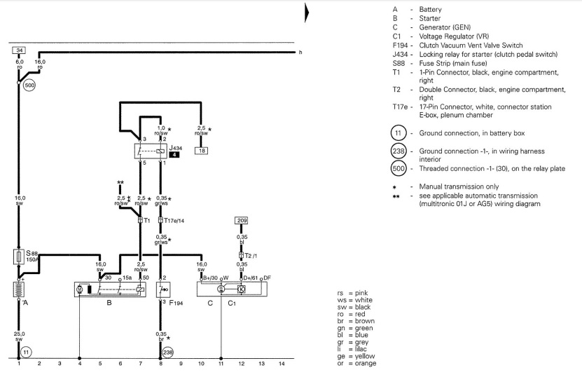

Okay so I am working on A 2004 audi a4 convertible w/ a 3.0 v6. Problem is I caused a short. Had the entire top end of the engine torn apart for a valve job. Then put it all back together only I made a huge mistake!! it's European and I'm use to working on domestic and jdm cars.... Well I accidently plugged a hot wire going from the starter to the alternator into a block ground. That wire should have been plugged to the alternator but I hot confused as blk can also be ground on the cars. Well any way the car started after realizing my mess up. Only started twice though and on the second time it shut off and just cranks sometimes it won't crank though.
It has no codes through regular obd2 only has codes using obd11 scan tool. The main one I saw was low voltage to ecu and the fuel pump doesn't sound.
I also noticed with a test light after unplugging negative terminal from batt...batt post[neg] to any ground on the car gets voltage it lights up....
The second I put the test light on the negative terminal of the vehicle and plug it to the negative battery post the light goes away
Some other strange things I noticed when I unplugged the vehicle computer and set my test light to ground when touching the wht/blk wire on the computer harness I would get the ecu relay to activate with the key out of the ignition. Also noticed when I activated the relay I checked the voltage only had 3.52 volts with a voltage drop of 8.89volts
I have plenty of schematics if someone with more knowledge is willing to help me out and teach me something or point out what I'm missing been working on this self caused electrical issue for a month now this is where I'm at
8 years 4 months ago #21582 by Tyler
Replied by Tyler on topic Short or bad ground problem
Hey Rotatingrotar89! Sorry to hear this one didn't go well. :( I grabbed a battery diagram for reference:
There's a ton of different direction you could go with this, and I'm hopeful others chime in with their thoughts. For me, I'd chase that battery > starter > alternator circuit and the intermittent no crank first. A voltage drop from the B+ post (not the cable end) to the alternator B+ post would be a good place to start. When the engine is a no crank would be best. If you find excessive drop, work your way closer to the battery until you start getting good readings.
A quick voltage drop across that main 150A fuse would be a good idea, too.
