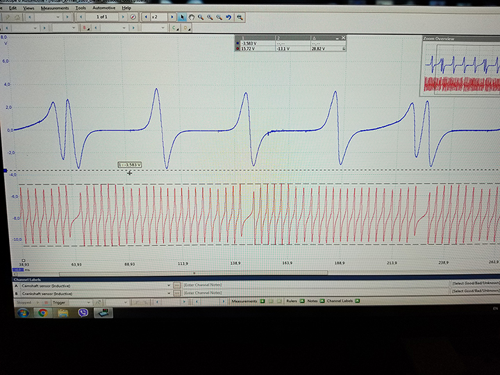

After the start up everything is fine , good amount of power , smooth running engine , no black smoke etc. Ofc there is no fault codes stored in the ECU . I readed the live data while the car is cranking and there is rpm reading and fuel pressure . The owner already has change the timing chains , crank and cam sensor , the high fuel pressure pump valves , the fuel pressure sensor on the rail ( actually not 100% what the hole history of the repairs , several shops worked on this car ) . I checked the wiring to the ecu of the cam and crank sensor and its OK . But i'm starting to think there is something wrong with the timing chains cuz he told me , when they change it some parts left from the kit , cuz there were not for this car , the camshaft sprocket gear were different ... If someone can provide crank cam waveform for this engine ( both sensors are inductive ) , i will be greatly thankful .
And one more question , is it matter on an inductive sensor , 2 wire sensor , if you rotate the wires ? Wire 1 goes to pin 2 , and wire 2 goes to pin 1 .

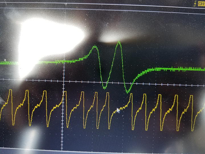

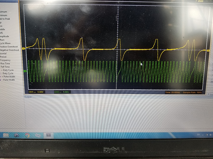

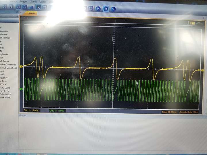

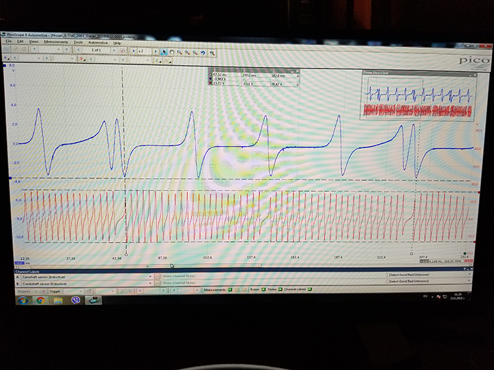

The leak-back fuel on the injectors are under the valve cover , like D4D engines on Toyota . Out of the valve cover goes out one main house which is for the leak-back fuel . So i decided to block it with pliers and ... no effect . Interesting fact is that while the car is cranking there is almost no activity on the rpm tacho . When the tacho start to move the car starts . But it takes some time this to happen .. Thats why i want to check the cam crank waveform .
