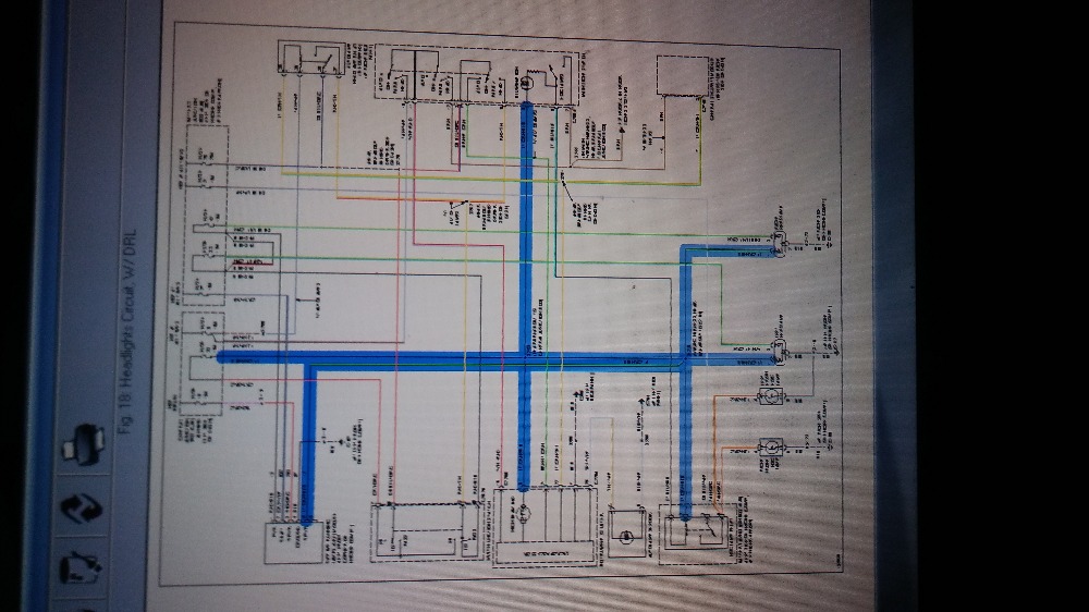

I have this 04 explorer sport trac with the lights that just don't turn off. I pulled fuse 33 off and the lights turn off if i turn the truck on the lights turn on normal. Can someone please tell me what I should check explain the wire diagrams.

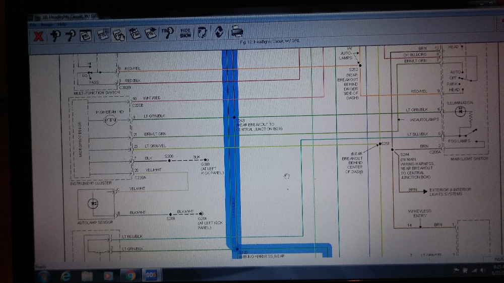

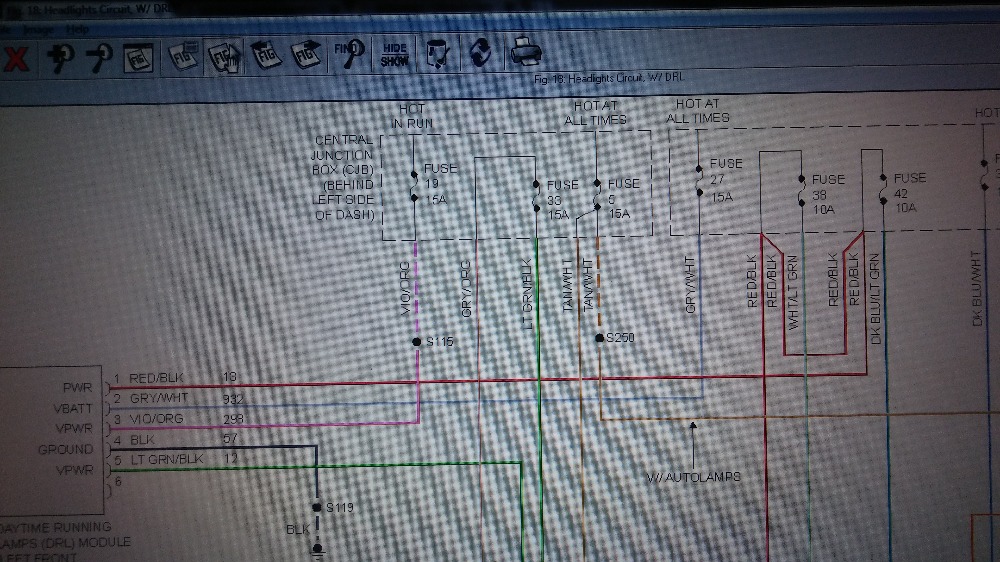

Fuse 33 is the one I have highlighted on the diagram that I posted. Do I have the wrong diagram?
Thank you for your help.

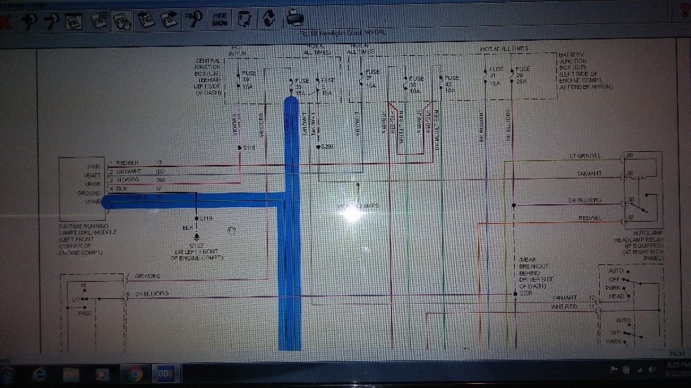

Thank you Monde for replying I'll post another pic may you can see it better. Can you please post the puc you are looking at. Thank you

Hey Gilbert! So it's the high beams that stay on? Even with the key out?
I found a different diagram, if it helps anyone:
That fuse #33 (F2.33 in the diagram, I think) should only get power from the multifunction switch in the high beam or flash-to-pass positions. So if you're pulling that fuse and making the lights go out, then that'd suggest a stuck switch, OR voltage is backfeeding into that circuit from somewhere else.
I'd probably go to the multifunction switch next. Or, C219 if you can find it, probably at the base of the steering column. If you can disconnect the switch and make the lights go out, and the switch is in the low beam position, then that switch sucks.

8 years 4 months ago #21674
Replied by Tyler on topic 2004 ford explorer sport trac lights stay on
I'm with Monde, it really shouldn't be the DRL module. Thinking the circuit from F2.33 to the DRL module is an input, rather than an output, letting the module know the high beams are on. But I've been wrong before! :silly:

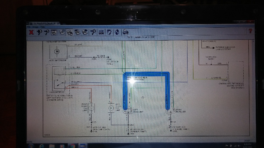

8 years 4 months ago - 8 years 4 months ago #21677
by gilbert
Replied by gilbert on topic 2004 ford explorer sport trac lights stay on
God bless you my brothers and sister's.
Monde thank you for responding. So like I said if I unplug one switch at a time and the lights go out I found the problem . At least on which circuit the problem is on. On my diagram the DRL has power all the time. Is it possible that the module is bad inside? Thank you for your help.

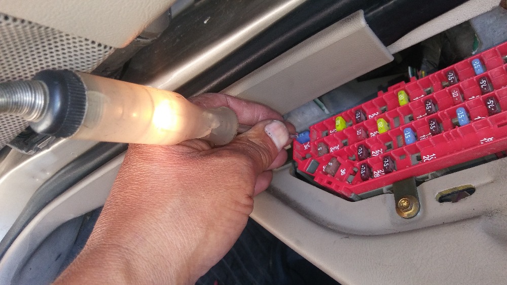

8 years 3 months ago #22161
by gilbert

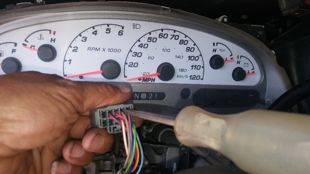

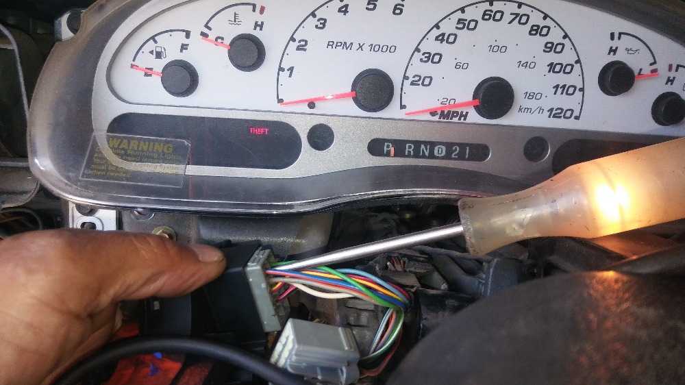

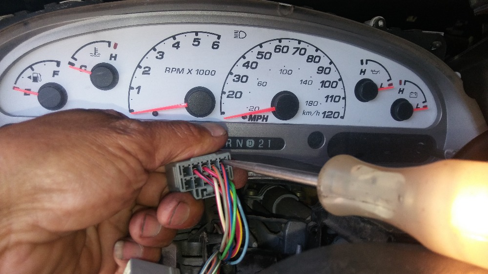

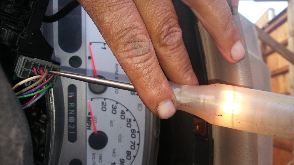

The the customer finely brought the truck back and I disconnected the multi. switch and lights went off. With the switch disconnected I have no power on fuse 33 as it should be. When I plug it in the high lights turn on and the ignition switch is off dose this mean that there is a short in the multi. switch? Here are some pics when plugged in and unplugged to. When plugged in the grey and orange wire is the one that get power when plugged in and that wire go's to fues 33 the high lights. Can I call this switch bad? Thank you for your help.

8 years 3 months ago #22394
by gilbert
Replied by gilbert on topic FIXED 2004 ford explorer sport trac lights stay on
Monde and Tyler you were right it was the combo switch customer took it somewhere else but it was a fix.
THANK YOU VERY MUCH.
