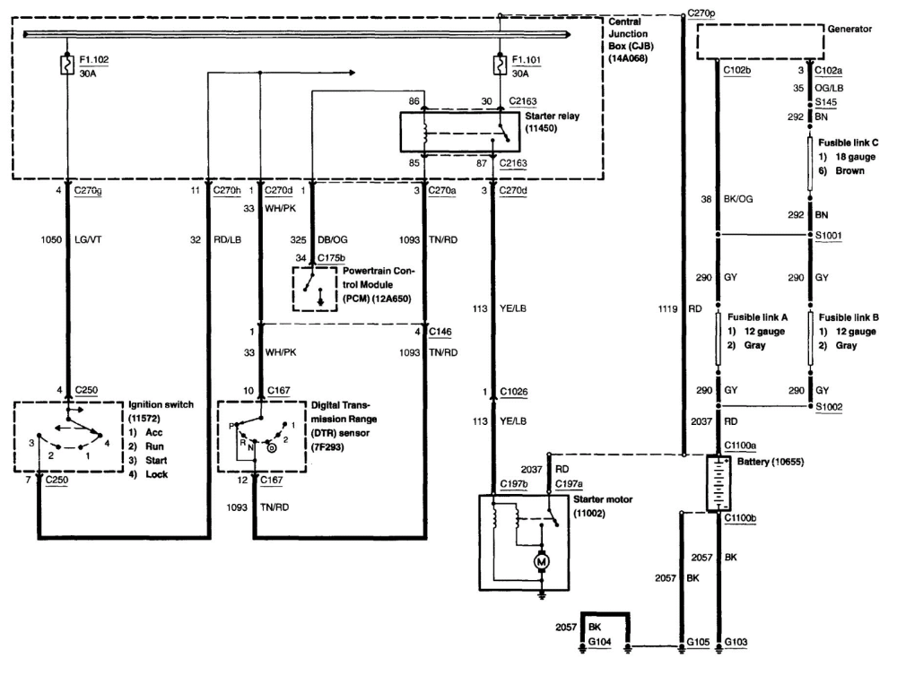

HELP HELP PLEASE 05 Nav WILL NOT START and NO THRUST POWER
I have an 05 Navigator that was running well, HECK I just came for WACO a day before this happened.
The last drive was a short drive to the store. On the was back I ran over a railroad track
that was bumpy as HECK. SOON after rolling over this bumpy bumpy ride(I did not slow down much)
thought I could roll right over.
After rolling over the tracks I lost power, tapped on the gas but no go, I could only go about 5-7 miles per
hour, SLOW for about 1 block til I got to my house. That's when I cut the engine.
I noticed that the "check AdvanceTrac" symbol came on solid after I went over the train tracks.
NOW I just won't say any thing when I attempt to turn the key to turn it on.
THINGS I HAVE VERIFIED:
The Battery - All lights come on, the horn honks, the lights in the cab do not go dim with attempting to start. (NEW BATTERY as of 06/20/18)
The starter - I ran a wire from the starter solenoid(thin wire) to the positive of the battery - it started with
low idle but with no thrusting power. I put it in gear and it goes very slow forward and backward.
I thought it may be the collision air bag sensor. I read somewhere that it might be in collision mode....I don't
know Im reaching.
I'm also reaching out to all who might know what I can do to DIY and or who might have a resolution, solution,
and just plain old FIX.

I dnt know if you can follow a diagram but heres the starting diagram for you car... what i do recommend is dropping it down into neutral and see if itll crank that way.. otherwise lookover this diagram and check the fuses involved

The starter relay (see picture) should have constant power on pin 30, constant ground on pin 87, power on pin 85 when ignition is in start position. The ground on pin 86 is provided by the PCM (why is ground provided by PCM? Maybe ignition is being affected by some input to PCM? Not sure about this)
So when key is in the start position, the starter relay should have two power feeds (on pin 30 and 85) and two grounds (pin 87 and 86)
Pull out starter relay, take a test light to ground, set ignition to start position (probably need someone to hold it in that position), and check each terminal from where the starter relay was in. Two pins should have power.
Now connect test light to battery and do the same thing with ignition in start position, you should have two grounds.
The ABS tells PCM, and PCM can control engine timing and injector pulse. Maybe ABS is malfunctioning, try pulling out the ABS Control Module fuse (see picture)
Oh, and do you have any trouble codes?
