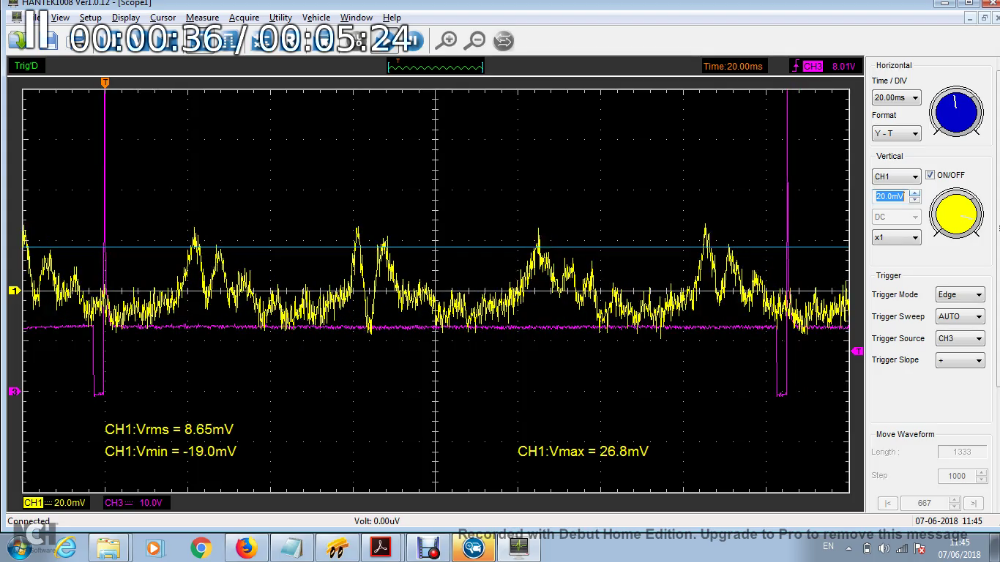

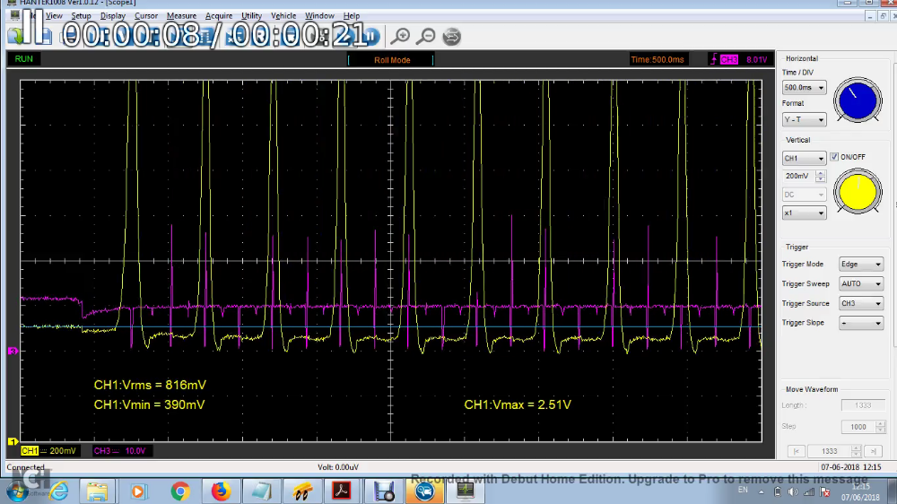

So now to the main point. I got to run some more tests on this car, and took some intake manifold and in cylinder pressure waveforms. The reading were taken at 930 meters above sea level.
Average intake vacuum: 17.9 inHg. This is the same reading I got with a mechanical gauge. Spec is minimum 18 inHg at sea level I assume.
Mechanical compression readings on all the cylinders were about 197 psi dry, 210 wet, after multiple cranks, with throttle held open.
On the scope, cranking with throttle closed, I'm seeing about 123 psi peaks consistently, and max vacuum of 19.85 inHg.
The first thing I noticed that looked strange was that I'm seeing quite a bit of vacuum in the cylinder during the exhaust stroke. Also, the vacuum in the cylinder when cranking is higher than in the manifold when running. I'll get back to this. Waveform attached at bottom.

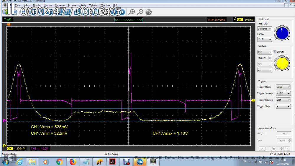

Running is were things get really weird.
Running compression is about 44.4 psi, and max vacuum is a whopping 26.26 inHg. What is super strange is that I'm seeing about 5.4 inHg vacuum in the cylinder during the exhaust stroke!
I triple checked my readings, and saw the same thing on two non-adjacent, non-companion cylinders.
Unfortunately I didn't put up 720 cursors and check measure cam events, and it'll be about two weeks before I can get my hands back on this car.
The solid blue lines in the in cylinder captures represent 0 psi.

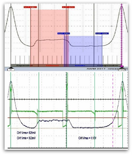

8 years 4 months ago - 8 years 4 months ago #21685 by Andy.MacFadyen
Cursors at TDC end of exhaust - start of induction reveal a lot
Known good typical 1.8 litre 4 cylinder 16 valve engine on top your with capture pasted on bottom. Look around 360 degree mark, valve timing looks about 1 or even 2 teeth late.

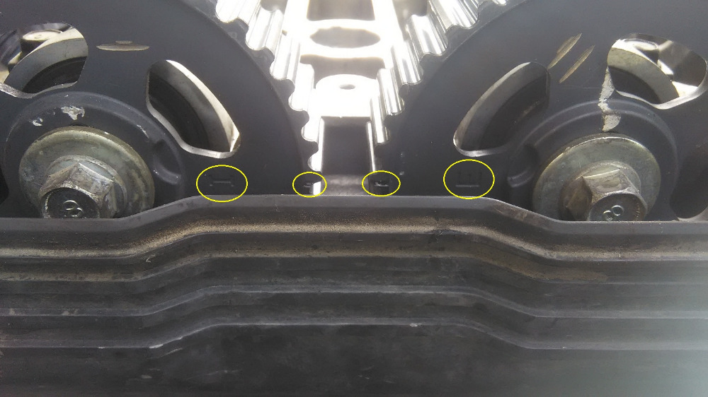

First, how did you overlay the cursors? Second, this car has always had this problem, and I replaced the WP and tbelt myself. You can see here that the timing marks line up perfectly:
There's an I and a E pointing towards each other, and you can see the timing notches lined up straight across from each other, each circled in yellow.
Also, the cam and crank signals line up correctly, or at least the same as an example I found on iatn.
So, I think whatever the explanation it's something more complicated than the timing belt being off a tooth or two. Just from poking around, I have a feeling this engine may have been out and apart at some point. So I'm wondering if something weird might have happened, like they used the wrong intake cam, or put the sprocket on the cam wrong. The sensor is on the exhaust cam, so the intake could be messed up some how, yet still have good cam / crank correlation.
I just can't think of any explanation that would allow me to have good compression, yet result in poor manifold vacuum, and excessively high vacuum during exhaust and intake strokes...

Well, if anyone is interested, I was able take some measurements and got the following ( I'm still new at this )
EVO 34* BBDC Measured as soon as pressure starts rising
EVC 14.8* ATDC Measured as soon as pressure starts dropping
IVC 40* ABDC Measured as soon as pressure starts rising
I'm new at this, but those numbers seem reasonable, although without a spec I can't be certain.
