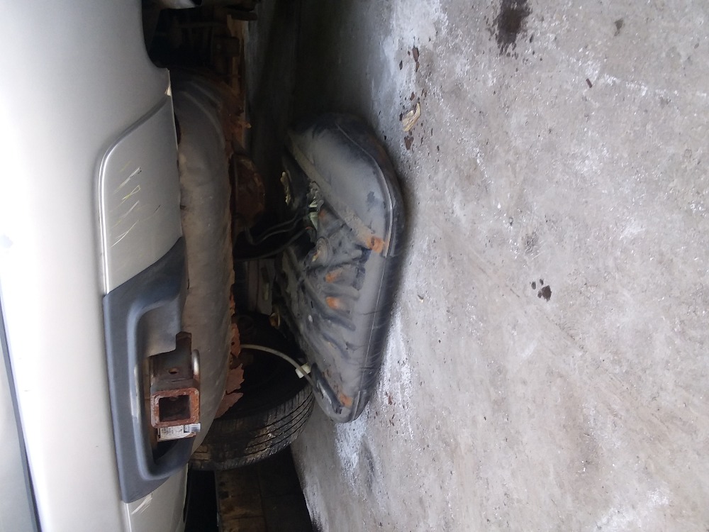

8 years 4 months ago - 8 years 4 months ago #21847 by Noah
Replied by Noah on topic How Much is Too Much?
I just put a tank skid plate in an 04 Grand Cherokee today too.
Hope you don't work in the rust belt!
I lifted the Jeep and the tank stayed on the floor of the shop!
Trailer hitch adds a degree of difficulty...
But yeah, the Jeep filter isn't on the sending unit like the Dakota
Last edit: 8 years 4 months ago by Noah.
