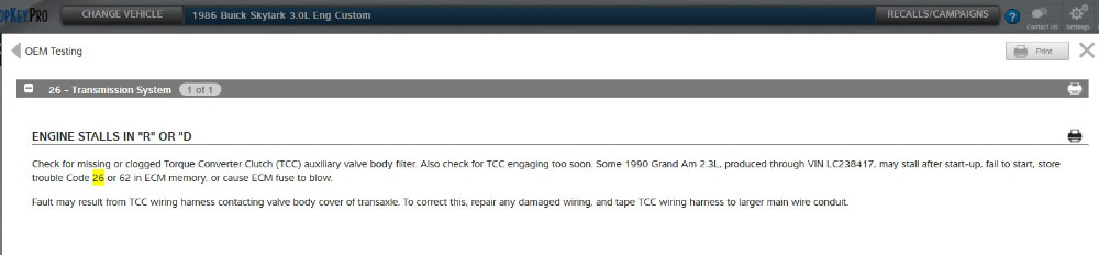

1986 BUICK skylark 3.0 can't find the quad driver codes in alldata for that year. Found for 1991. Anyone know where I can find out info I need for diagnosing these three codes? They are not listed alldata but with flash diagnostics they are stored in the ecm.
8 years 3 months ago #22029 by Chad
Replied by Chad on topic Codes 26 27 28
I found this on ShopKey.
