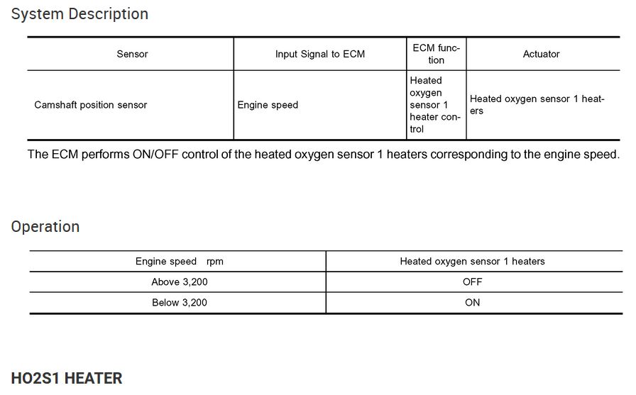

I pulled this from all data:

8 years 3 months ago #22015 by Tyler
pole71 wrote: ^^^Hopefully, someone else will chime in on this. This doesn't sound right, to me. 300mv seems a bit high for the ground circuit.^^^[/attachment]
I guess I'm OK with this as long as it's a pulse width modulated heater? :huh: Otherwise that does seem a bit high. Still, I'm not sure a heater circuit fault on an upstream sensor will cause this.
Any fault codes? What are the fuel trims doing when the switch is on and off?
