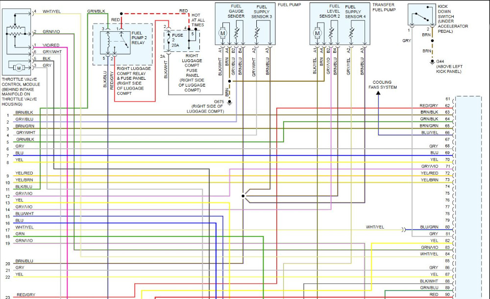

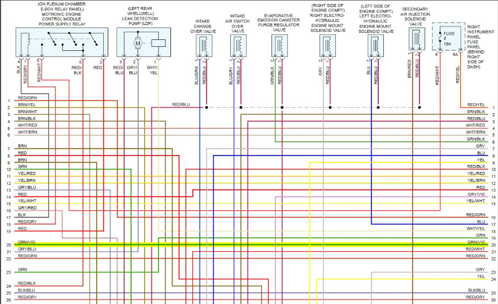

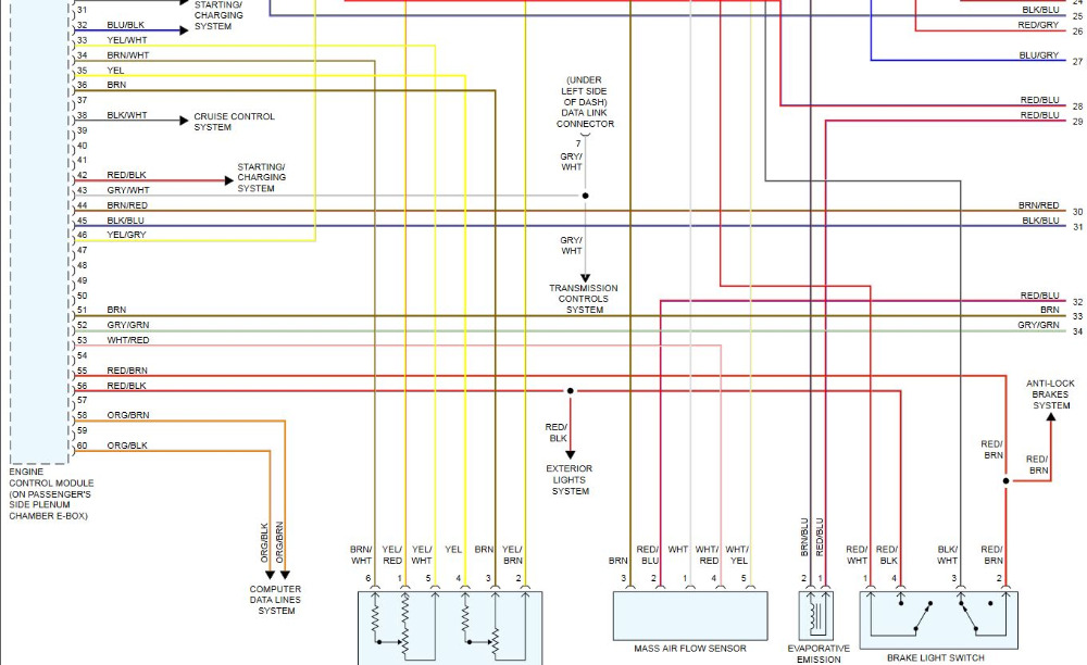

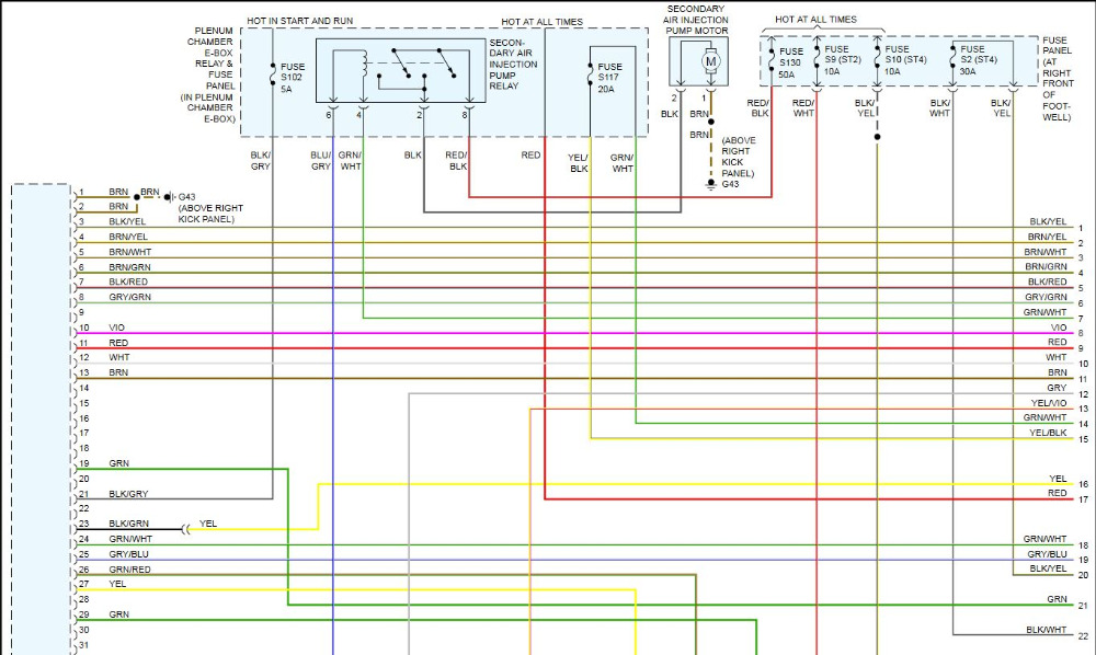

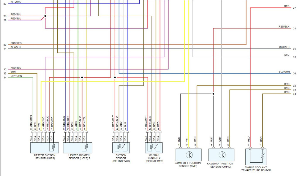

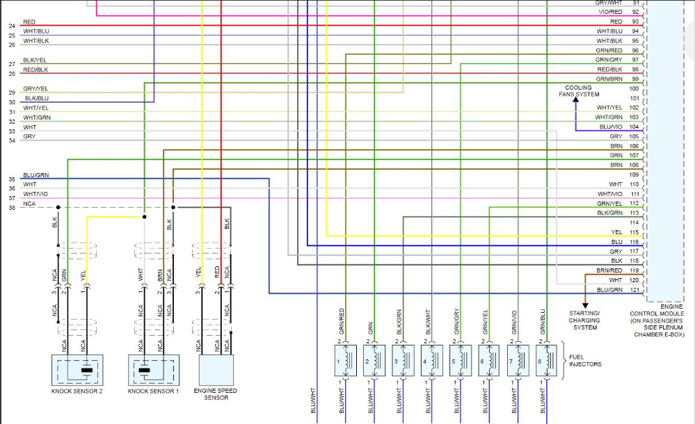

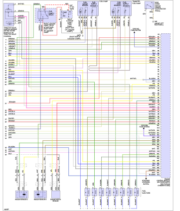

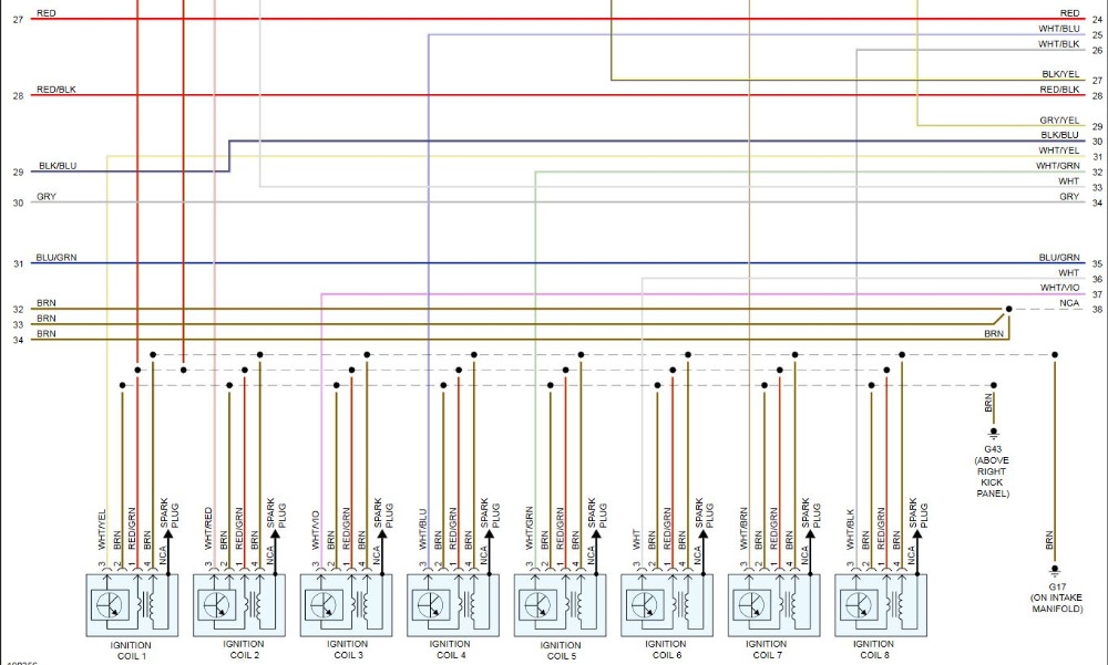

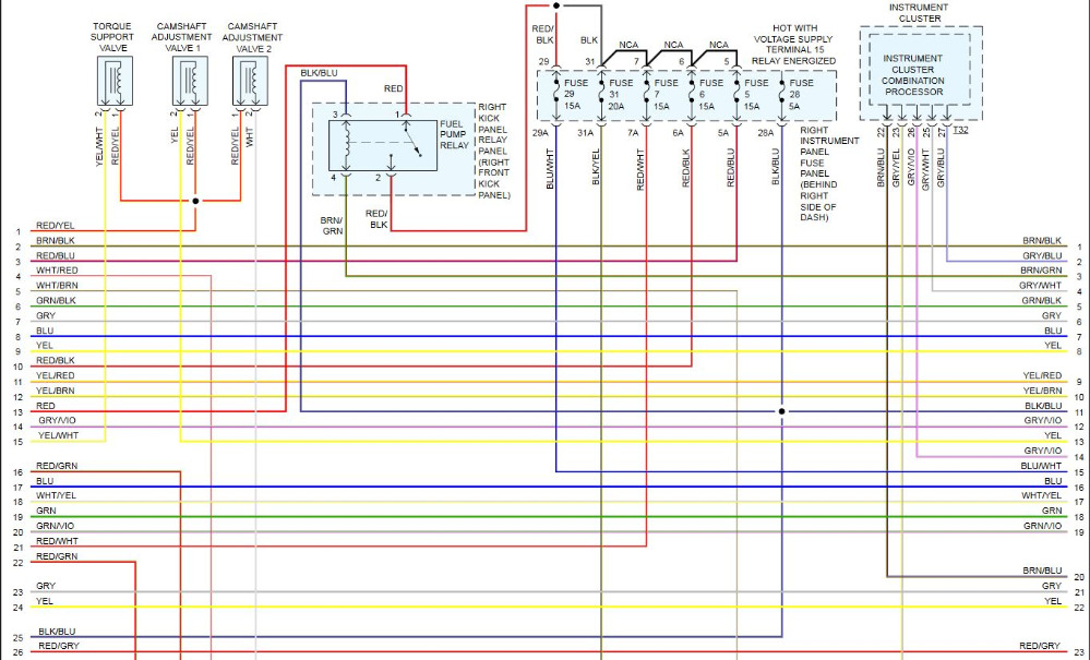

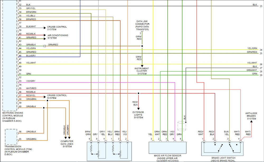

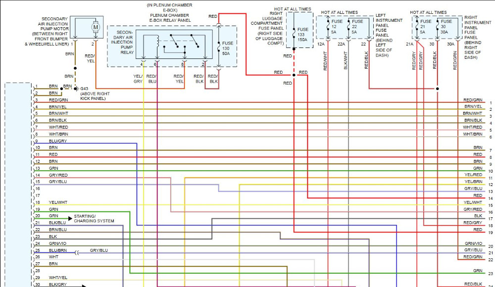

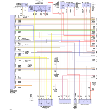

2004 audi a8 4.2l d3 need the ecm pin out chart wire schematic need to attempt to back check wire for break open circuit camshaft position sensor bank 2 3 wire ground comes back just no voltage reading.... please help. Audi dealerships treated me absolutely horrible had to do everything myself Thanks Guys also purchased repair manuals online.... just got a bunch of garbage...

Thanks for the reply.... trying to make out the images.... they're very blurry.... anyway we could get a clean image

Pole 71...... i Really thank you for reaching out......i got the pictures... been beatnnn myself over the head all the wires on this ecm are totally different colors seems like the schematic is wrong... the ECM is a Bosh 4E0 907 560
4E0 910 560A. 070. Me 7.1.1
PLEASE help...Thanks guys
- Posts: 2223
8 years 3 months ago #22134
That is the only schematic I see for 2004. This is 2003. Does it match up any better?
Replied by Chad on topic Mayhem
Indoblaze wrote: been beatnnn myself over the head all the wires on this ecm are totally different colors seems like the schematic is wrong
