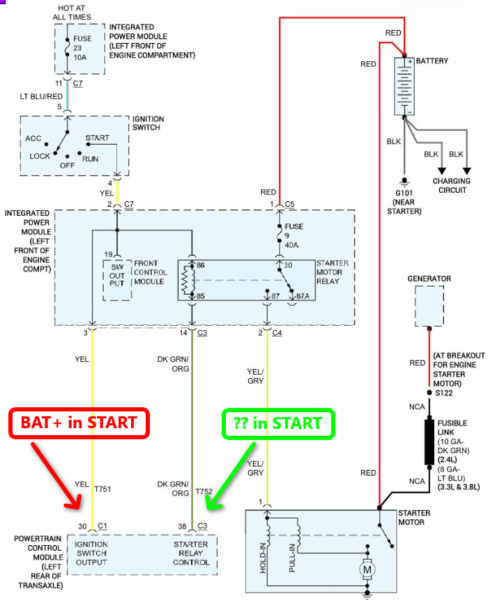

I get a click when trying to start
What is clicking?
Does scan data have a starter/crank request?
Go to the PCM and check for BAT+ on Connector 1, Pin 30 when the key is in the START position. ... It should be a yellow wire.
If you get BAT+ on Pin 30, go to Connector 3, pin 38... Dark Green wire with an orange stripe. What do you get on this wire when the Ignition is in the START position?
This point is a "Fork in the Road"...If there is BAT+ we are turning Right. If there is a GROUND we are turning Left.

I get a click from the asd or starter relay. I have b+ on the yellow and grn/org wore (neg test lead to ground and pos to wire with connectors plugged in to PCM and ipm)
If the starter relay is clicking, but not engaging the starter, and...
jumped 30 to 87 at starter relay and starter turns
... this suggests a bad relay.
However, if the starter relay is clicking, I would expect to see a GROUND on the DK GRN/ORG wire of Connector 3,  PIN 38 when the key is in the start position.
Since you have BAT+ on the DK GRN/ORG wire of Connector 3, PIN 38 when in the START position, it is probably safe to assume that the starter relay is NOT clicking.
Assuming that you have no codes or dash lights indicating a security/key problem, I would use a jumper wire to short the DK GRN/ORG wire of Connector 3, PIN 38 to BAT Negative, while holding the key in the START position, . This should engage the starter. If the engine starts and runs, it would be a safe bet that the starter relay control driver inside the pcm is bad. If the engine cranks, but does not start, we will have to take a look at the SKREEM...(Sentry Key REmote Entry Module).

Ok. It turns over but does not start. I'll wait for instructions. Thanks again for your time

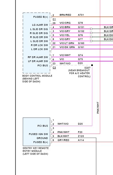

Use your scan tool to look in the BCM for the SKREEM status.
Check the SKREEM for POWER on pins 4 and 6. Ground on pin 5

I tested 12v at pins 4 and 6. Pin 5 is grounded.

The skreem status was
0 DTC's passed

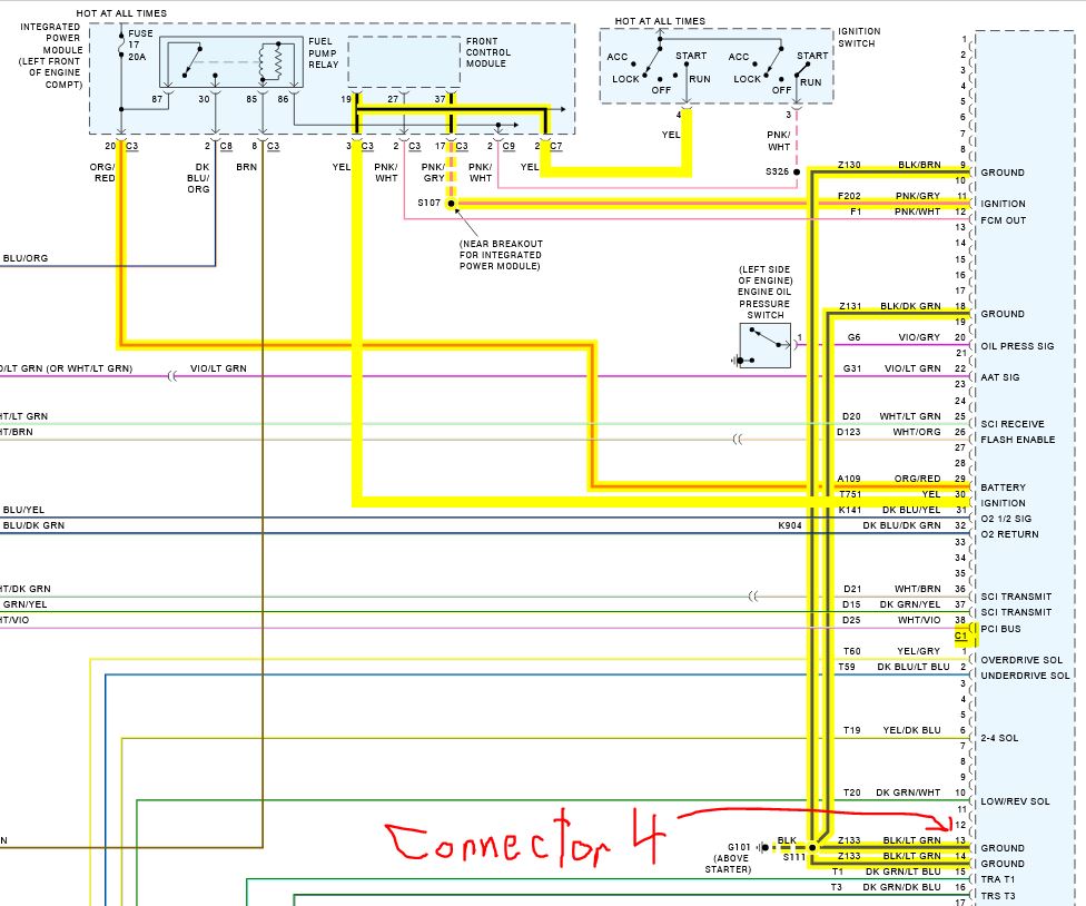

Does the fuel pump run for a couple of seconds after the key is turned on?
Check the Powers and Ground of connector 1  and the grounds on connector 4.

The powers and grounds were good with voltages on the powers and continuity to ground for ground connections. The fuel pump powered on with the asd relay jumped but I could not hear the pump now due to traffic. If I connect a test light or bulb between gas pump fuse connectors would that be a good way to test?
Checking continuity to ground is NOT a good test. Simply, having continuity to ground does not mean that the ground is good enough to carry a load. You should connect a test-light to Battery + and use the ground to light the test light. Do this at the PCM connector(s).  A good ground will illuminate the test light, brightly. A bad ground may illuminate the test-light, dimly. Or, not at all.
