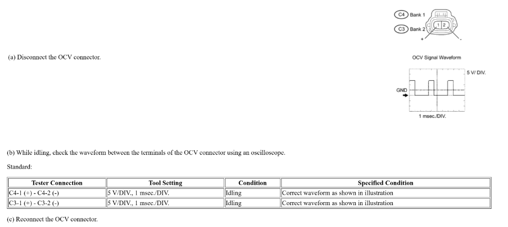

1 year 7 months ago - 1 year 7 months ago #84927 by Johnaldregan
So the leak ended up being the fuel injector insulator on the #1 cylinder. I replaced the intake
Manifold gasket and found that out because istill had the issue. used a straw to focus a little water directly into the insulator area. worked pefectly. So now working on replacing the lower fuel injector insulator on #1 cylinder. since the (fuel injector) upper o-ring is new and the lower o-ring cushion is also new. Also I now got have a code p0010 for the bank 1 vvt solenoid. I tested voltage with car on but not running. And only see .57 volts I watched another video testing that connector for the vvt solenoid and they had upwards of 8 volts. Could this be an issue also?

1 year 7 months ago #85168 by Tyler
So the leak ended up being the injector one cylinder. I replaced the intake
Manifold gasket and still had the issue. So working on replacing the lower fuel injector seal now. since the (fuel injector) upper o-ring is new and the lower o-ring cushion is also new. But the lowest one that the cushion sits on wasn’t replaced and that’s where it is sucking\leaking from.
Awesome! Great find.  I've had troubles with the lower injector seals on Toyota products before, as well. A vacuum leak at the injector seal would very neatly explain the misfire on cylinder #1 and the fuel trim values you posted.
Also I got code p0010 for the bank 1 vvt solenoid. I tested voltage with car on but not running. And only see .57 volts I watched another video testing that connector for the vvt solenoid and they had upwards of 8 volts. Could this be an issue also
No offense meant, but are you sure the VVT solenoid connector wasn't left unplugged at some point during your testing/repairs? I can't recall ever having problems with the 2.7L VVT systems.
The VVT solenoid on this engine is power side switched, meaning that you'll only see power at the solenoid with the engine running and the solenoid commanded on. Toyota service info indicates that it'll be a 12V pulse width voltage.
I had tested the vvt solenoid also and the actuator for the solenoid is working peoperly moving up and down. But the ohms reading was 7.6 and I saw somewhere it said it should be 8 ohms or above. Does my vvt solenoid sound ok or needs to be replaced also ?
Solenoid resistance can change depending on temperature, so 7.6 ohms is close enough for me. I'd leave the solenoid alone for now and check the circuit.

1 year 7 months ago - 1 year 7 months ago #85190 by Johnaldregan
Thank you this was what I needed. I think the issue I'm having is in the wire coming from PCM I believe. I tested the votlage at terminal connector with key on but not engine running. I should have tested the OCV(oil control valve) terminal connector with engine running. I appreciate the fast feedback and I will update as soon as resolved and post my findings.

1 year 7 months ago #85196 by Johnaldregan
the OCV was unplugged accidentally due to the broken terminal connector for at least a day, sadly it was hidden under electrical tape from previous owner which is where I believe the code originated from.

1 year 7 months ago #85223 by Johnaldregan
well it was a failed PCM after back probing and checking the wires. wires were fine. PCM needs replacement. thanks.
