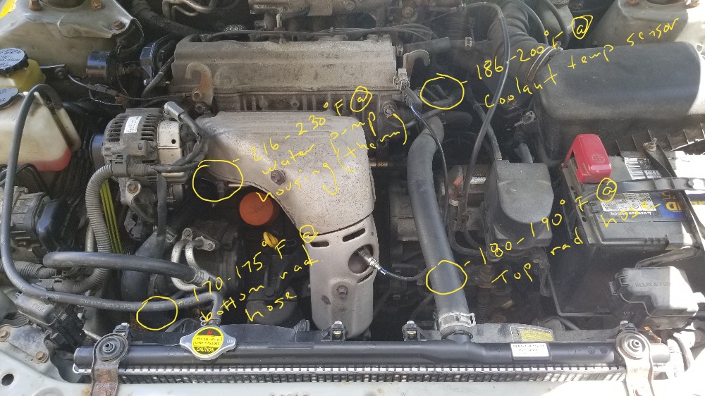

8 years 3 months ago #22132 by amstrum
2001 Camry LE w/2.2 liter overheating was created by amstrum
Hi! This is my first time on the forum. I have done most of my own car work for many years, but have recently been trying to improve my diagnostics skills--then this (seemingly simple) issue came along and I am stumped:
I have several Camrys--this one is a 2001 LE with about 180K miles on the 2.2 liter. It began overheating while my daughter was at an internship in Florida. She took it to a shop where they put a thermostat and a radiator into it...still overheating. She drove it home (about 350 miles) with the heater turned on the whole way to keep it from overheating...
The engine was running ok, but seemed kind of loud, so I thought the worst--head gasket. But as I listened, I realized the water pump was making most if not all of noise. The timing belt was a little loose too, because of the play in the pump shaft, so I thought I had found my problem. While I had everything apart, I replaced cam, crank, and oil pump seals, oil pump gasket(there were some leaks!), timing belt, water pump, and the water pump housing. Put everything back together...and it's still overheating!
Here's what happens: It comes up to normal operating temperature, then floats up until the temperature reads about 213F, then the fans come on and cool it back down--then the whole cycle starts all over again. This is when it is just sitting idling. When driving, it never quite recovers; it stays hot, fans come on to cool it some--but not much--it creeps back up, then the fans come back on, etc.
Other than the overheat issue, it seems to run fine. My daughter said it lost power on hills while she was driving home, but while driving it as I have been testing it, I haven't detected a serious power issue...So, I made sure I had no air pockets in the cooling system, pressure tested the cooling system (20 lbs--held fine), checked for CO2 in the coolant--none, checked compression--all 4 cylinders between 210-225, checked for white smoke out the exhaust--none, spark plugs were not perfect, but looked ok--no ugly deposits, and no obvious coolant in the oil.
FYI: I was really careful installing the timing belt--I always am--but I checked it afterwards with a timing light just to be sure--5 degrees BTDC at idle, right within spec.
My daughter did say she thought she lost coolant during her trip, but I"m not sure that's accurate--and I don't see any evidence of coolant in the oil or exhaust anyway (and the coolant pressure test did not indicate a leak).
Oh, and I checked for exhaust back-pressure--just in case it might be a catalytic converter issue. I checked this by using both a vacuum gauge and by installing a pressure gauge in place of the B1S1 AF ratio sensor--negative. I also did a leakdown pressure test, which proved inconclusive--I don't believe my equipment is working correctly. I will be trying that again. But even with my faulty results, I definitely did not see any air getting into the cooling system.
What am I missing? I don't pretend to be an expert--or even close. But this seemed like an easy diagnosis and (though time consuming) fix. I have now run out of ideas! I don't want to take the head off if I don't have to; none of my tests has absolutely condemned it or the head gasket.
I don't have a sophisticated scanner or a lab scope, so I feel like I looked at everything I have the capability of checking, given the equipment I have. Could it be something I'm not even looking at or thinking about? Any thoughts would be greatly appreciated...

What is the temperature of the coolant entering the radiator, and what is the temperature of the water leaving the radiator? There should be approximately 10 degrees difference.
If the temperature of the coolant exiting the radiator is say 30 degrees cooler than what is entering the radiator, then that indicates a flow problem. The coolant is staying in the radiator too long, thus giving off more heat. But at the same time the coolant is staying in the engine too long and thus is not able to cool the engine. The cause of this could be a possible not fully opening thermostat or a faulty water pump impeller.
If the coolant exiting the radiator is close to the same temp as the coolant entering the radiator, then the radiator is not able to shed the heat of the coolant. This is usually caused by poor airflow or clogged passages in the radiator. If this is the issue, check the AC Condenser for cleanliness. If it is clogged with debris, it will result in poor airflow through the radiator. Also check for the plastic shrouds to be in place. They channel and force as much air as possible directly through the radiator. Also check the impeller on the plastic fan blades.
If the coolant entering the radiator is 190, and is leaving the radiator at 180 for example, then you probably dont have an over heating issue at all but is most likely a sensor issue.
This should give you a direction of what is actually happening.
I have seen many issues with overheating after radiator / waterpump replacement and they were pretty much all caused by air in the coolant system. A couple ways to verify no air in the system is to check the heater tubs and make sure they are both hot. If one is hot and the other isnt, there is air there. The air has to be bled out. I have raised the front of the vehicle over three feet in the air with the rear tires on the ground. This helps to make the radiator opening the highest point in the system and the air pockets will move more readily to the radiator. Another method for this is to use a vacuum fill tool.

The temps I'm reading are using my scanner and using an infrared thermometer. Things are definitely getting hot when the gauge floats up (which happens fairly quickly)--so i believe the gauge and sensor. The thermostat i did not replace myself but is new and seemingly reacting the same way as the old one. I do, however keep thinking about it--constantly!...

Temps are definitely high--especially the water pump housing at the thermostat (and at the coolant temperature sensor). I compared them with one of my other Camrys.
The water pump housing gets up around 230 degrees before the cooling fans come on (compared with around 205 on my other car). Also, temp at the coolant temperature sensor gets to nearly 200 degrees whereas my other car is at around 180. All temps were taken with an ir thermometer.
Flow issue (therm or wp)? Or coolant temperature sensor? Or something else?
Im looking at all suggestions. I'm nervous that new therm or wp could be faulty--but obviously not good enough at this to decide what direction to go next.
New radiator (air flow is fine)
Thermostat is new (I didnt install)
Water pump is new
Temps are definitely higher than normal
Fans are working
No (apparent) combustibles getting into cooling system (I will be rechecking for a third time)
No (apparent) coolant in the oil
All testing/measurements thus far have been on idling engine.
Is there a definitive way (besides rad. temps) to prove good coolant flow?

Gauge floats up to indicate quite hot. The water pump housing temp reading is REALLY high compared with my other car. Scanner readings are in the same neighborhood--reads about 216 before fans come on ( versus 205 in the other camry). I just tested the coolant temperature sensor according to the manual (should have no contiuity up until 183F) and it failed--but I dont see how that would produce the effect I am seeing...
