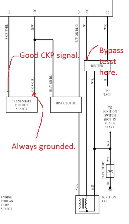

I have a 96 Camry with no spark , I did a bypass test on the igniter and I can make the coil spark , but cranking I have no signal on the white wire. I measured the pickup and had good resistance . And have signal on 1 of the crank sensor wires but the other one has ground always ! Is that normal ground ?? Or probably a short?

5s-FE is the engine . And yes Mr Tyler I did the bypass with the test light to B+ on the white wire of the igniter and actually got shocked :( jajaja but was happy I got spark and got the igniter and coil out of the way . The CKP I had the normal ac waveform on the red wire and on the green I had just 0v and tried giving it 12v with the test light while looking at the oscilloscope and the test light turned on but the oscilloscope stayed at 0v kind of weird result. Thanks Tyler! When I get home I will post the wiring diagram and draw where I was connected !

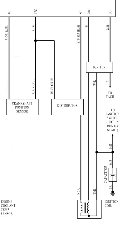

9 years 10 months ago #2777 by Rukerin
Replied by Rukerin on topic 1996 Camry no spark
I had no injector pulses Mr Danner . Here is the wiring diagram where I did the bypass test. And where i got the crank waveforms. Thanks!

9 years 10 months ago #2778 by ScannerDanner
Replied by ScannerDanner on topic 1996 Camry no spark
Nice job so far! Check for a 5v reference on one of your main sensors next.

9 years 10 months ago #2780 by ScannerDanner
Completely normal to have one side of a VRS grounded inside the computer. You need to check the VRS signal wire at the PCM next. Also give us the amplitude of the signal during the test.

9 years 10 months ago #2781 by Rukerin
So both the crank sensor and the pick up at the distributor are VRS and share the ground ?! It makes sense to me :) . I will post the waveform with the amplitude of the waveform. Thanks a lot! I actually learn a lot every time I have a car that I can't fix , this forum is the best school I ever had.

9 years 10 months ago #2787 by ScannerDanner
Rukerin wrote: So both the crank sensor and the pick up at the distributor are VRS and share the ground ?! It makes sense to me :)
Exactly and that ground is internal to the ECM. Some VR sensors will use a floating ground and others will use a constant ground. One key piece here is when you see two different VR sensors sharing a wire/circuit, you can be sure that it is a constant ground.
