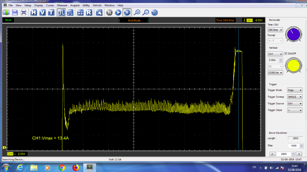

So I took an amperage waveform rolling the window up:
It goes to about 13 amps at the start, oscillates between 4-6 amps while rolling up, and when it hits the top spikes to 13.4 then quickly levels out at about 12.6 amps.
When I take a waveform when the window is stuck down, it's a constant 12.6 amps, with a slight downward slope.
Maybe when the window is rolled all the way down it's getting physically stuck somehow? Like maybe the top edge of the glass goes slightly under the edge of the frame and when I smack it that frees it up?

8 years 3 months ago #22427
Replied by Tyler on topic Loose wire on Window Regulator?
Wow, 12 amps when stuck down? :blink: Scratch my failing motor theory.
I think you're on the right track with the binding window or regulator idea. I'd suspect a regulator problem first, just because it moves and flexes more than the window channels.
