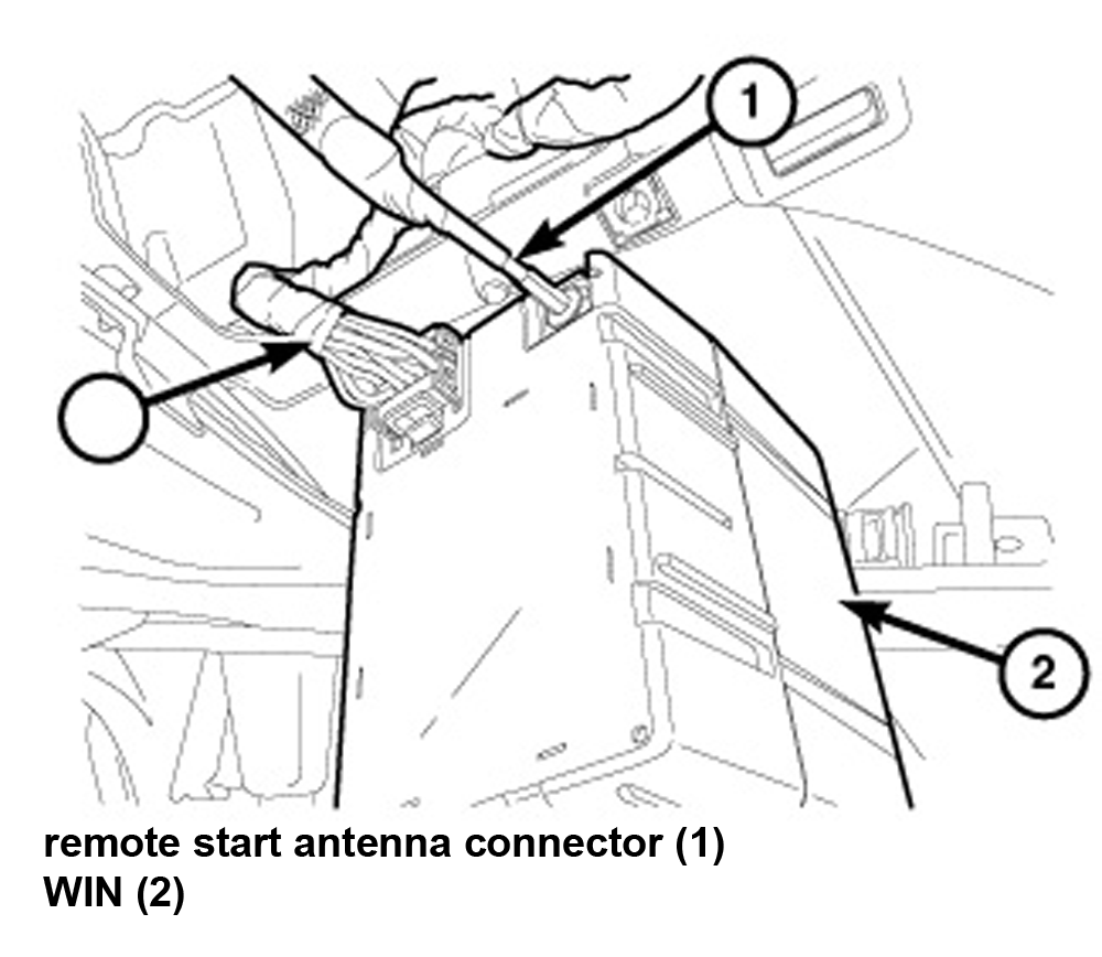

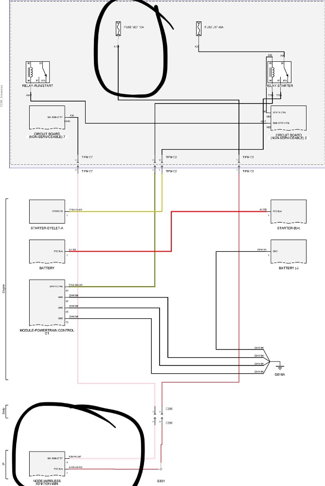

- John Curtis
- Posts: 345
- Thank you received: 111
7 years 5 months ago - 7 years 5 months ago #30267
by John Curtis
Replied by John Curtis on topic 2013 Dodge Grand Caravan Intermittent
What is the exact model?
What tests have you done?
I’ve included an attachment you might use for direction.
I’d be concerned with the WIN. Verify power on the circled fuse.
