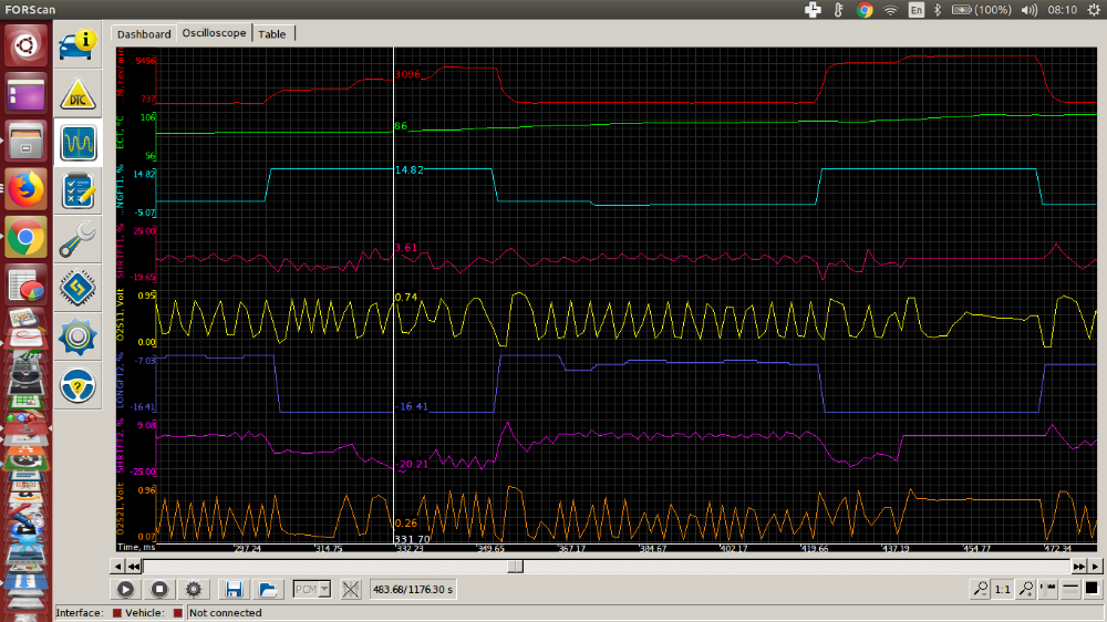

8 years 3 months ago - 8 years 3 months ago #22389 by SailorBob
MerleRezo56 wrote: Reversed O2 connectors?
Disconnect what you think is Bank 1 Sensor 1 and make sure that PID goes dead to verify.
I'm pretty sure that's not the case, just because before the bank 2 O2 starts switching the bank 2 STFT is 0. You can see here:
However, I'll take a look at that video cause it looks interesting.
Thanks!

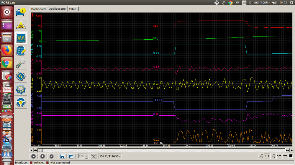

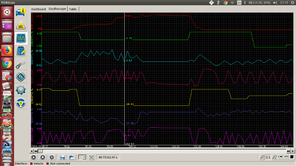

8 years 3 months ago - 8 years 2 months ago #22469 by SailorBob
OK, so things get more interesting. The guy had the water pump replaced while on vacation in a city 2 hours drive away, and in the process the guy played around with some of the vacuum hoses apparently.
I found a solenoid missing a vacuum hose, and I couldn't find a dangling one, so I just put some electrical tape over the nipple in the mean time and took some measurements. Vacuum at idle is still about 14.9 inHg, and at around 2000-2500 rpms goes up to about 17.5 inHg.
So now the fuel trims situation has changed significantly:
At idle, bank 1 FT is around 0%, and bank 2 ( the front bank ) is about -10%. Once it gets to about 2500 rpm LTFT1 stays around 0%, with STFT1 is all over the place. LTFT2 goes to -16.41 and never moves from that number regardless of rpm. STFT2 goes as low as -20%.
What's even more interesting is that at WOT bank 1 goes full lean, while bank 2 goes full rich, which can be seen in the above graph.
What I'm wondering is if there are separate fuel pressure regulators for each bank? I'm thinking maybe the vacuum hose for the bank 2 fuel pressure regulator isn't attached, but I think it's all under the intake manifold and I didn't want to start pulling it apart.
It also strange that the fuel trims no longer go in opposite directions.
There's some other strange stuff going on too. The engine is idling at around 850 rpm, while the ECU is requesting 750. The ECU is keeping the IAC at only 15%, and the spark advance around -2.5 degrees.

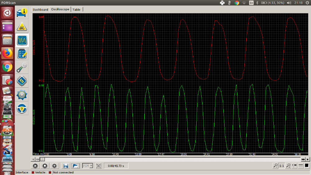

Another thing that stood out was that the bank 2 lambda is oscillating twice as fast as the bank 1 lambda:
Lot's of weird stuff going on.
