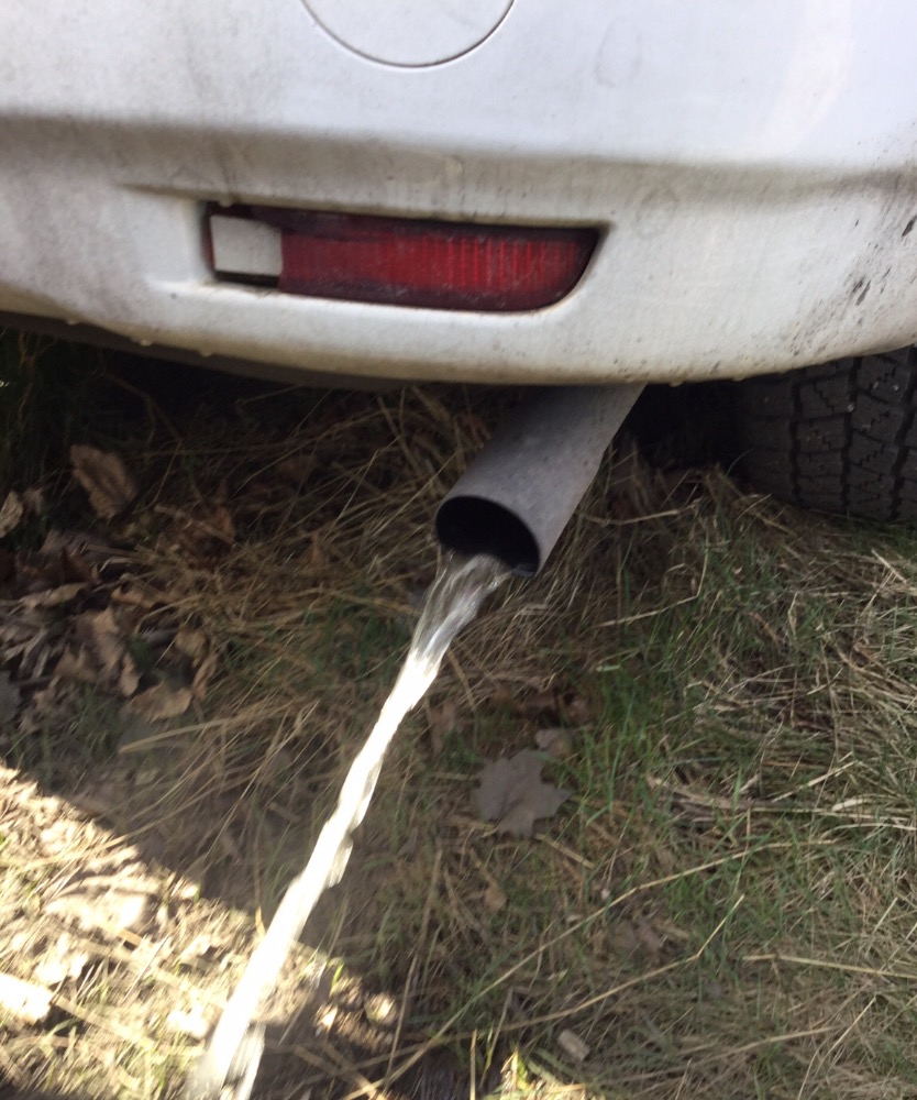

The condensed water flushed out of my tail pipe last year which makes me believe this drivability is the muffler and also why I gave information that the first owner was living in a very snowy northern Sweden where the salt water to clear it must have rusted the internal of the muffler and also bad oxygen sensors may have contributed. The external of the muffler looks good, I have gone under two other cars and it’s same look with my muffler but you could see a big map outside the muffler like water inside showing the map shape outside. The aftermarket muffler is very pricey here with 25% vat, can I drill a hole in the muffler to allow water to escape and back pressure to have some outlet? For over a year I have never seen one droplet of water coming out from my tailpipe which is weird, so water must be gathering somewhere in the muffler.
Cars should be engineered with no inter-dependencies. I need to know if my IAT and MAF readings are good and if a clogged muffler could affect the entire system from oxygen sensors, CAT, MAF etc.

That is a very large amount of condensate in the muffler but unless the car is loosing coolant it would not concern me.

I have never had to top up my coolant. I have now yanked off my muffler and the situation is still the same.

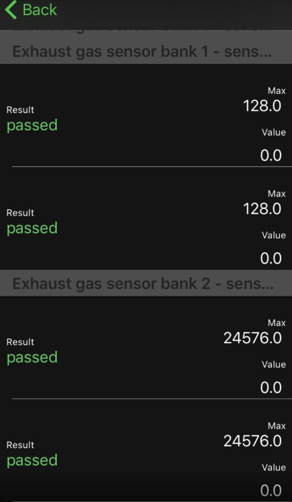

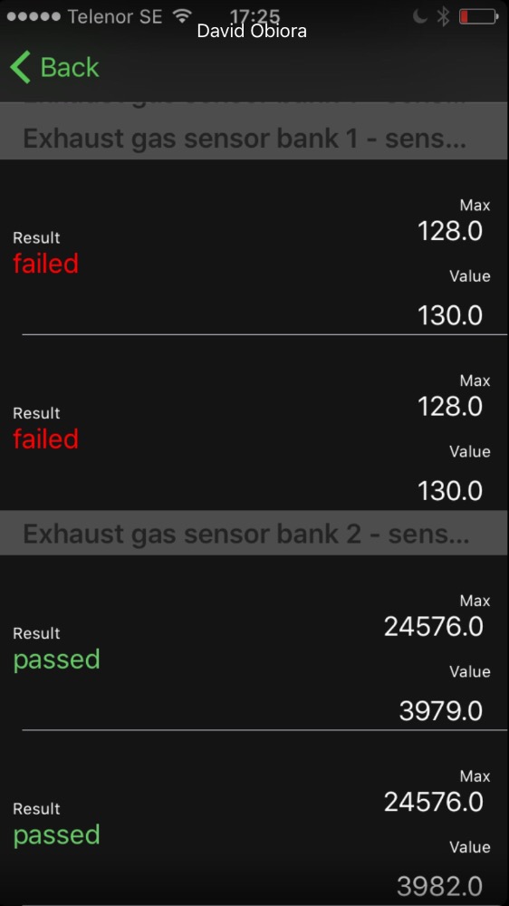

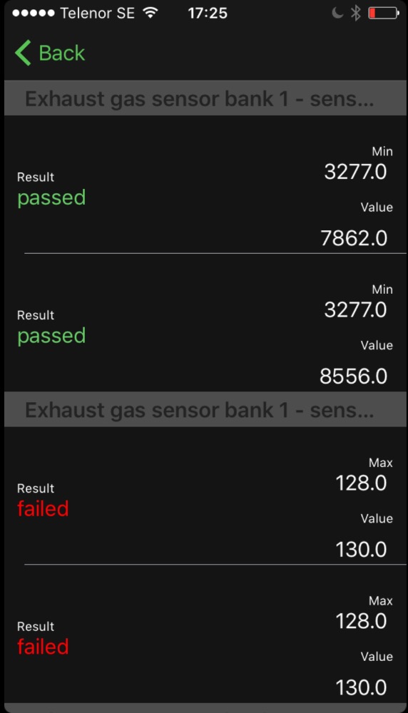

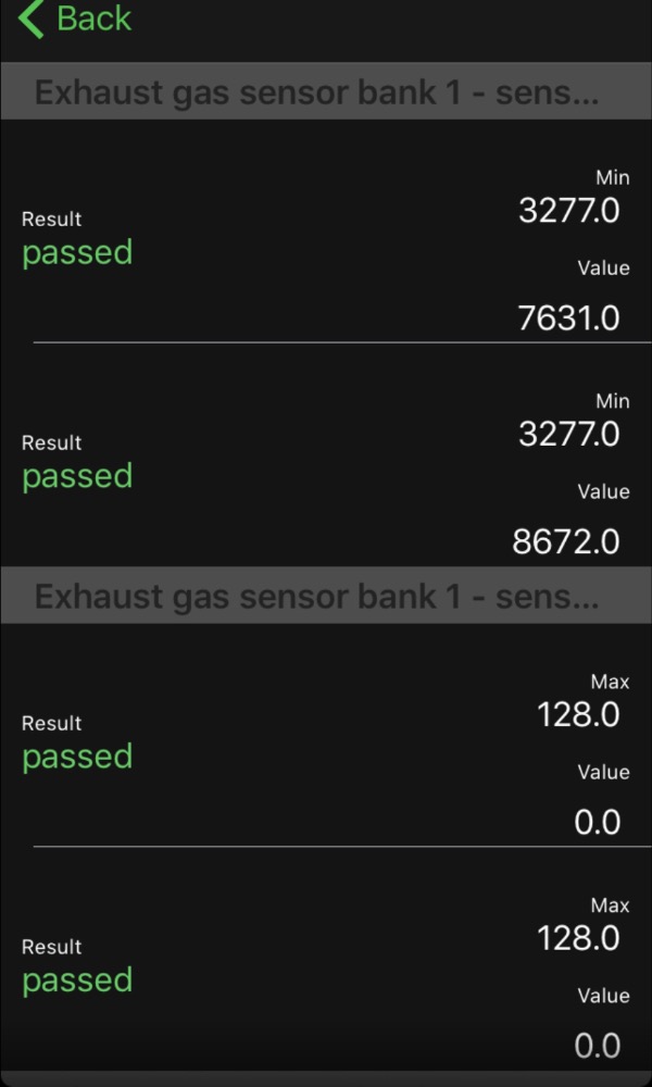

The reason I’m suspecting my exhaust I’m attaching in the images. I have odb2 WiFi and techstream, but before I created some form of air outlet in my exhaust system by pulling out one of the A/F upstream sensors and now my muffler, my OBD2 exhaust gas sensor results showed failed in 4 out of the 8 tests, but everything passed when I pulled out my A/F upstream sensor, and failed again when I put the sensor back...immediately I yanked my muffler off to release some exhaust back pressure the 8 tests showed passed again.
I will contact OBDCarDoctor to explain to give me more details on the parameters as they were not shown fully for lack of space I guess, or I use my iPad instead to get the full (Exhaust gas sensor bank 1 - sens...)
Atleast I have ruled out it’s not my muffler, money saved.
I’m suspecting creating an outlet for back pressure is enough to make the exhaust pass but then the restriction that affects drivability still lies somewhere in the exhaust system and most like after the CAT and before the Muffler (resonator).
This is exactly the drivability problem I had before changing my CAT, and now I have removed my muffler and still problem persists, that leaves the last culprit in the system which is the resonator or the rest of the exhaust system minus CAT and Muffler.
The first set of attachments will be for the failed 8 tests of the exhaust and the next will be when it passed, if anyone can help me figure out the information and label the parameters properly for me.

8 years 3 months ago - 8 years 3 months ago #22460 by babajis2010
Replied by babajis2010 on topic Drivability problem driving me crazy for 1 year

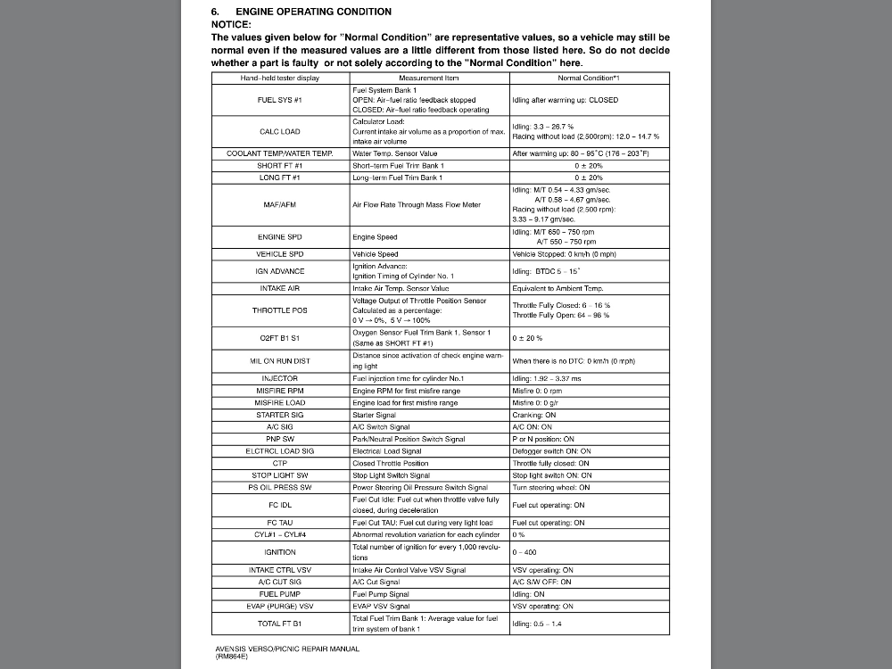

These are the passed results and also I’m attaching Toyota engine operating condition.
Although the drivability problem is still there.
For all I know my MAF is not producing what it should be producing in grams at WOT. I read somewhere MAF should give 80% of engine horse power, my engine is 150hp and my MAF should give 120grams/sec but I’m getting far less.
Which is the best and fastest diagnostic route between a MAF and exhaust. Otherwise I go and find someone who can borrow me a MAF because if I buy they won’t accept a return for electrical parts.

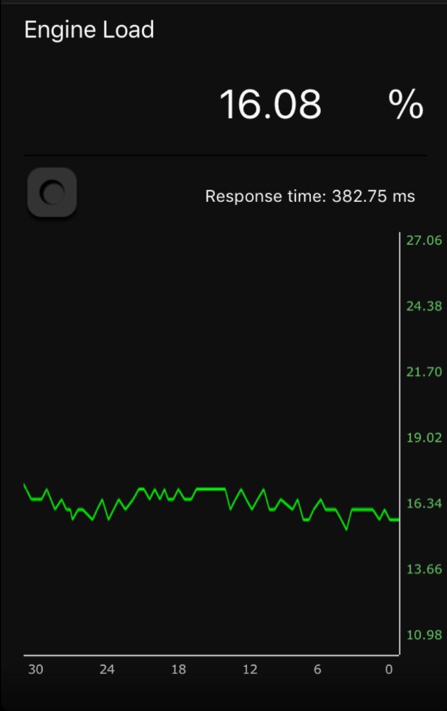

8 years 3 months ago #22462 by babajis2010

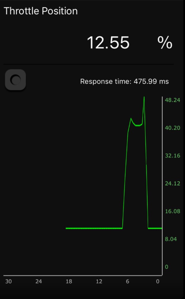

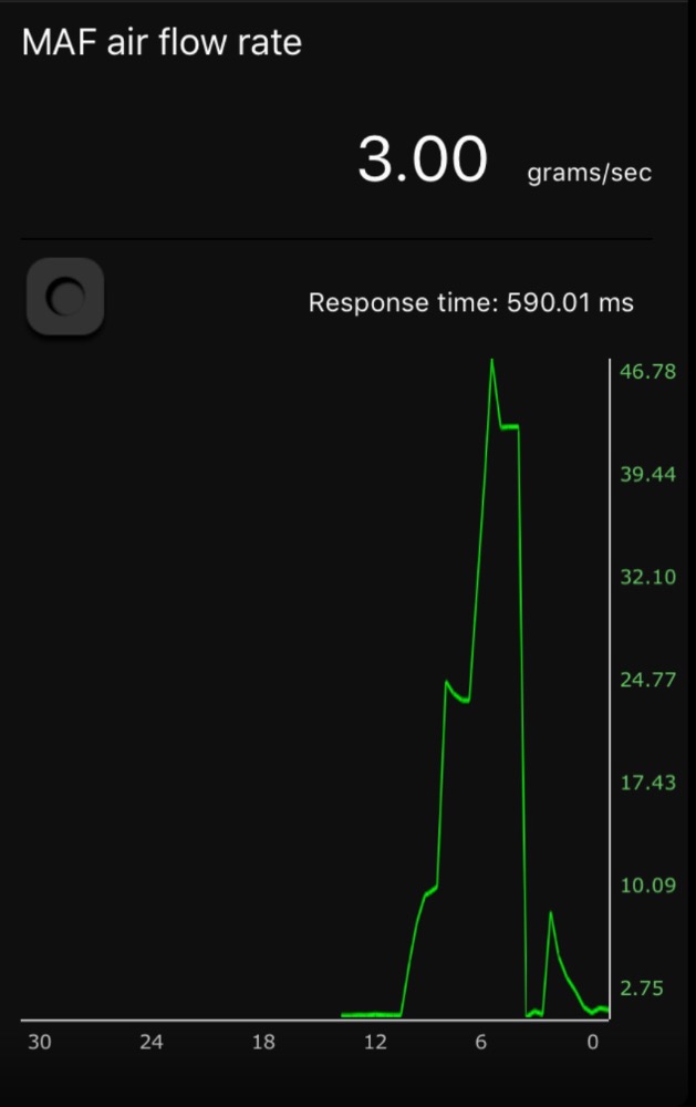

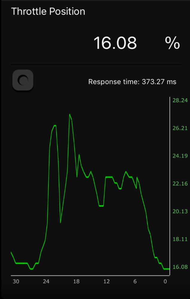

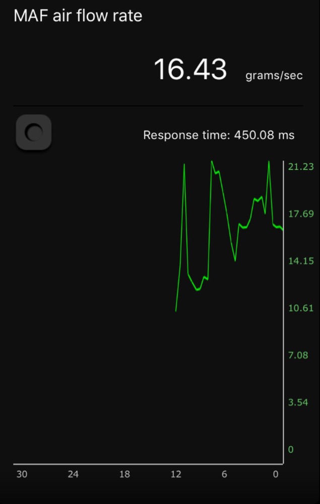

I am attaching data for engine load, tps, MAF reading and dashboard when I was on the highway at 90km/h around 60mph
And the next data I am uploading was acquired when I was parked, I rev the engine to around 7000rpm and you can tell me if the tps and MAF readings are correct.
Appreciate your help a lot. The mechanics here don’t do vehicle diagnostics apart from changing ball bearings and stuffs.

TPS and MAF at 7000rpm when in the parking lot.

I suggest you do a test drive and record the relevant parameters with your techstream in graph mode....
I would like to see tps, maf, rpm, engine load, fuel trims.
Have you put a vacuum gauge to the intake in order to confirm a plugged exhaust?

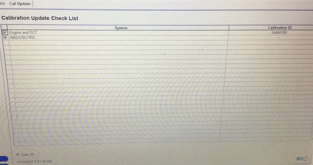

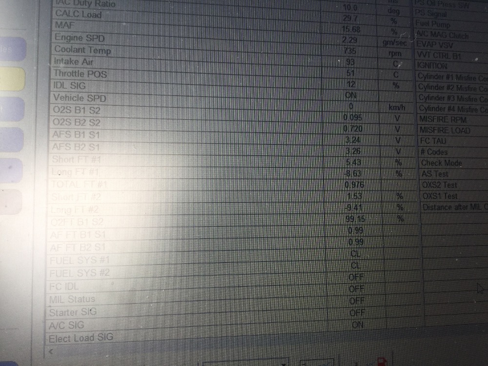

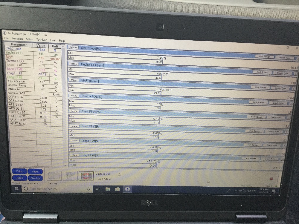

8 years 2 months ago - 8 years 2 months ago #22530 by babajis2010

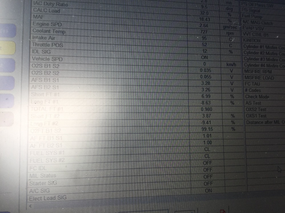

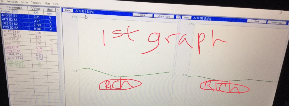

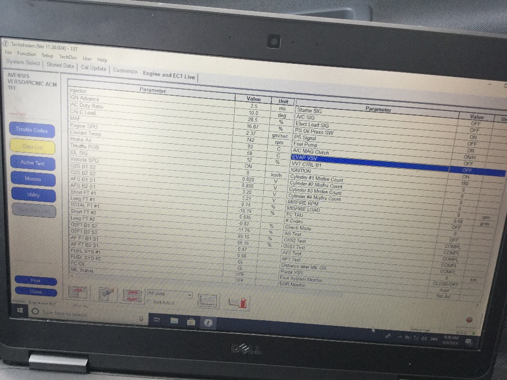

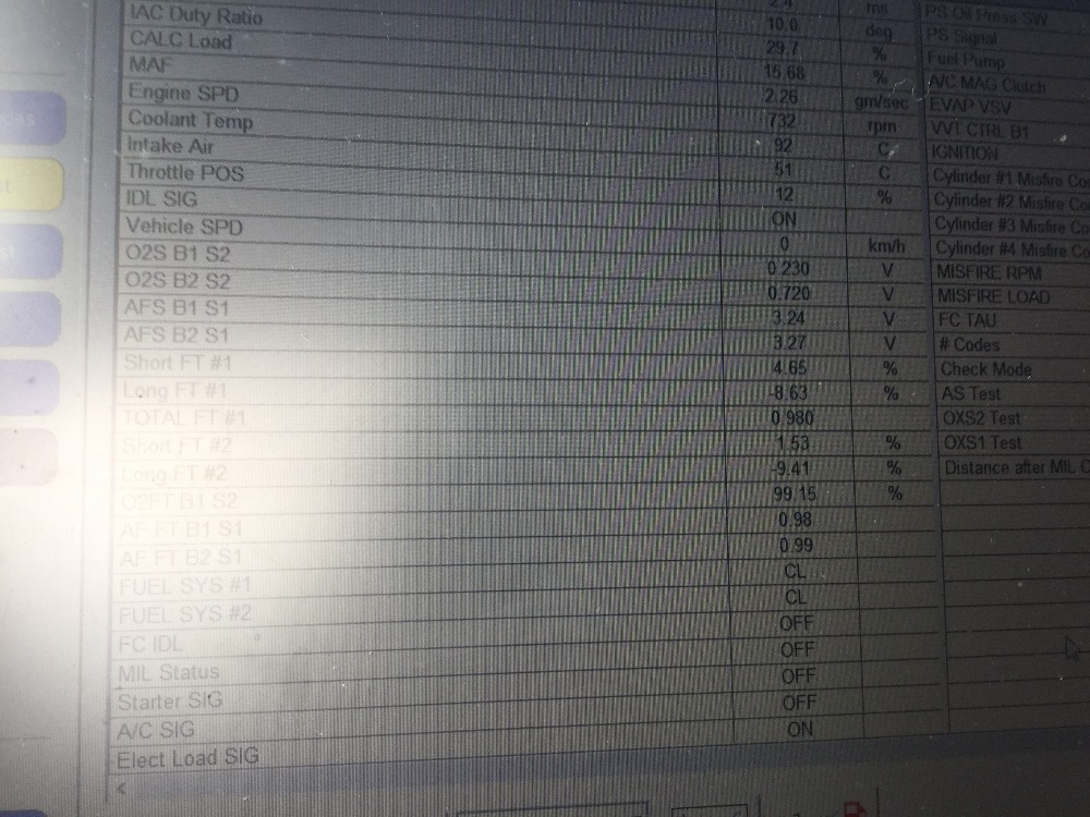

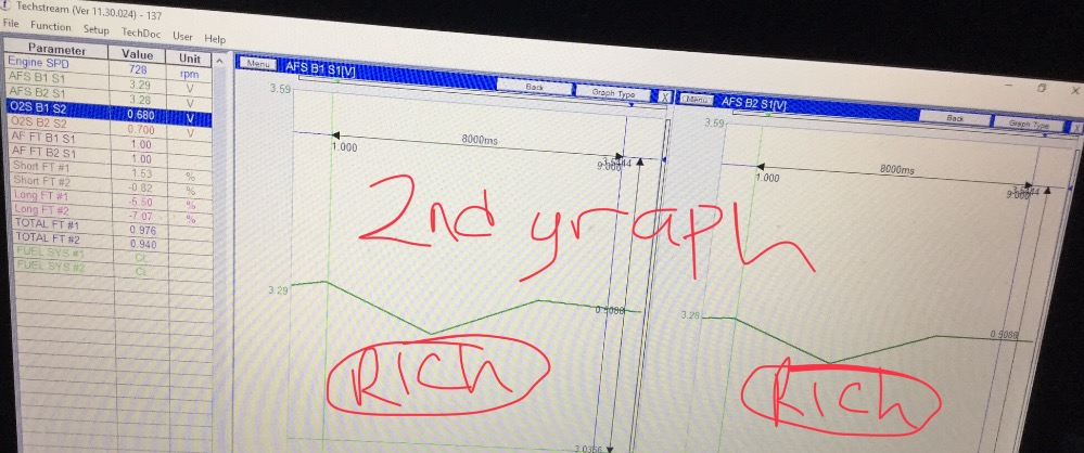

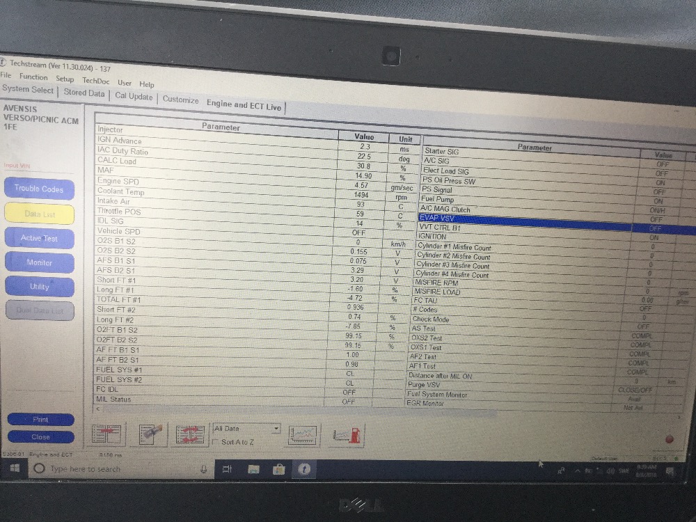

Like I said all the dealers and big mechanic workshops here don’t have a back pressure gauge, I’ve been to 8 of them. I am going through a very painful diagnosis myself and I will be very happy once I find the drivability fault.
I have gathered all the data you need but I will be sending first in meter graph. I ordered an aftermarket MAF sensor with 1yr warranty which means I can return it. After installing the new MAF everything remains exactly the same as if I had my old MAF, no changes whatsoever infact my old MAF was showing LTFT around -7, STFT around 2.34, the new MAF LTFT -11, STFT 0.43.
I will attach 4 images.
1. All the parameters at Idle RPM
2. All the parameters at 1500 RPM
3. All the parameters at 2500 RPM
4. The specific data you requested at meter graph mode captured at 4437RPM. I will try and send you the line graph mode later.
My next message will be about what I found out doing an active test of injector volume and A/F control injector volume using the techstream. Could you pls help me and look into calibration update, I have this number showing on the techstream for engine and ECT 34404100. Otherwise I find someone with an OEM MAF to borrow.
Thanks for your time.

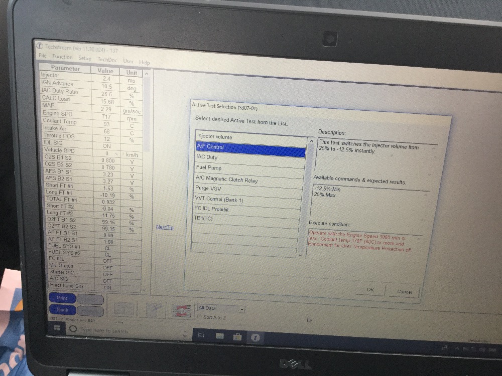

8 years 2 months ago #22531 by babajis2010

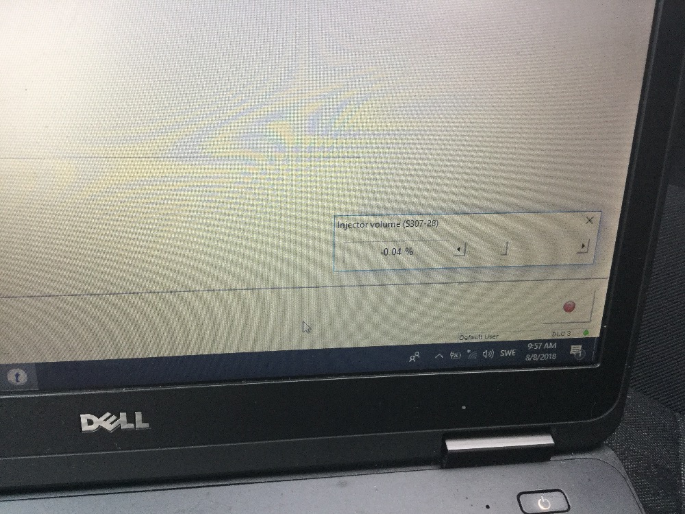

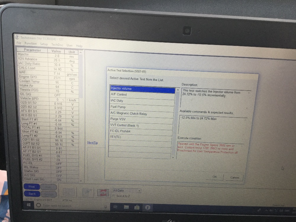

As for the injector volume test and A/F control , the results didn’t match techstream expected results.
I did test for IAC duty, purge VSV and VVT control (bank 1) and they all came out fine with the expected results specified on techstream.
But when I did injector volume test, at 3000RPM it just permanently stayed at -0.04% instead of switching from 24.72% to -12.5% incrementally and same thing happened when I did A/F control test the injector volume remained at -0.04% permanently instead of switching instantly from 25% to -12.5%. Can this affect TPS and MAF reading output, since I believe my TPS at full torque of 4400RPM should have read 80% as against the 38% I got and MAF should be around 120grams/sec at same RPM as against 49.01grams/sec I got.

As I was watching the live data, of course my wideband A/F upstream sensors is still out of stoichiometry with low voltage of around 3.24v instead of 3.3v (running rich).
My question is on my downstream sensor, since CAT monitor passed the downstream o2 sensors have stable voltages of 0.7-0.8v for a minute or so and immediately just drop to 0.035 when radiator fans kick in and back to normal again within 3-5 seconds.
Will a rich condition affect voltage readings of downstream sensors also even though the job of the downstream sensor is to monitor the efficiency of the CAT which it has done successfully but still drops in voltage. Is the behavior of my downstream o2 sensor normal considering all the information I’ve given out so far. I’m just trying to separate facts from fiction. All the big mechanic workshops here claimed car is fine when infact it’s not considering -11 LTFT and my driveability problems. This is a rogue operation for me, one shop even quoted me new CAT and new ECU. Atleast now I know I can’t trust their words since my CAT monitor has passed.

  • juergen.scholl
  • juergen.scholl's Avatar
  • Active partschanger
8 years 2 months ago - 8 years 2 months ago #22588 by juergen.scholl
Replied by juergen.scholl on topic Drivability problem driving me crazy for 1 year
Once again I ask you to record a test drive under varying driving conditions and post this techstream file here so anyone can open it with techsstream to analyze the data.
The pictures you posted are very limited and there is no under load data.
Did you ever do the volumetric efficiency test Andy suggested?

8 years 2 months ago #22595 by Andy.MacFadyen
Replied by Andy.MacFadyen on topic Drivability problem driving me crazy for 1 year
It would help us if you took screen shotds.
Thanks Andy, Screenshots would be very perfect as anyone without techstream can view what’s happening. I will take as many interval screenshots under varying conditions and load from gear 1 to gear 5 (20km-90km).
I understand an expert can use my fuel trims information and behavior to diagnose the problem also.
I have now taken away my resonator and muffler and nothing has changed. I still have loss of power.
My long term fuel trims on both banks remain around -11 (negative 11) at idle, but when I’m on the highway with my leg fully on the gas pedal, my LTFT drops to -1.56 and once I take my leg off the gas pedal it goes back to -11. STFT remains 0.78 - 1.56 on both banks.
This behavior in a STFT would mean vacuum leak I guess, but for a LTFT to drop under load can anyone make out what’s happening.
Andy from this thread below mirroring the same problem I’m experiencing you mentioned that o2 sensor may be lying. I am tilting towards my downstream o2 sensors because they are the ones I bought used and I remember after watching a video on YouTube having negative LTFT due to downstream sensors switched to the other, I switched my downstream connector cables and there was so much white smoke coming from the exhaust like raw fuel getting into the exhaust or something, but funny thing is on gear 1 at some point in my test drive the car was flying like it just came out of the factory, like something blocking the throat just suddenly release, unfortunately CEL P0420 and P0430 came on again. I had to switch the connectors back. I will do a swap of my downstream sensors by taking the sensors out and not just the connectors swap and see what happens. I bought an oxygen sensor FROM a 2003 Verso with same part number at 60,000km, now I’m wondering how can a 2003 car have 60,000km (km and not mile), then it probably means the sensors have been replaced and nobody knows if the replacements were OEM or aftermarket. I bought the sensor in 2017 and that means it came from a 14yr old car, even if the car did 10,000km/year that’s 140,000km in 14yrs. We do an average of 15,000-25,000km/year here.
I’m willing to take this up with the part dealer and file a report if they can’t be honest enough to display right part history.
After going through one of the old threads on this forum, I am beginning to be more than convinced I need an OEM MAF sensor, simply because my first fix on my car to drive down my STFT from +25 to what I have today was cleaning the MAF sensor, I am of the opinion cleaning of MAF sensor works maybe 50% of the time. My MAF reading is acting funny under load in the parking or while driving, sometimes 54g/sec at WOT and sometimes 92g/sec. my MAF should read above 120grams/sec even though it checked out fine at idle and under load without driving following Toyota technical information, but Toyota didn’t go further to tell us how the MAF should behave under load on the highway. Most likely the aftermarket MAF I installed did not do a better job also. I have seen far too many internet posts of problems with fuel trims with people throwing in other parts and at the end the fix was an OEM MAF, even some people ran into problems using aftermarket MAF.

8 years 2 months ago #22661 by juergen.scholl
You might want to try to disconnect the 2 precat A/F sensors or even better the 2 postcard oxygen sensors as well.
That way both banks will stay open loop and fuel control would not be skewed by misreporting sensors.
