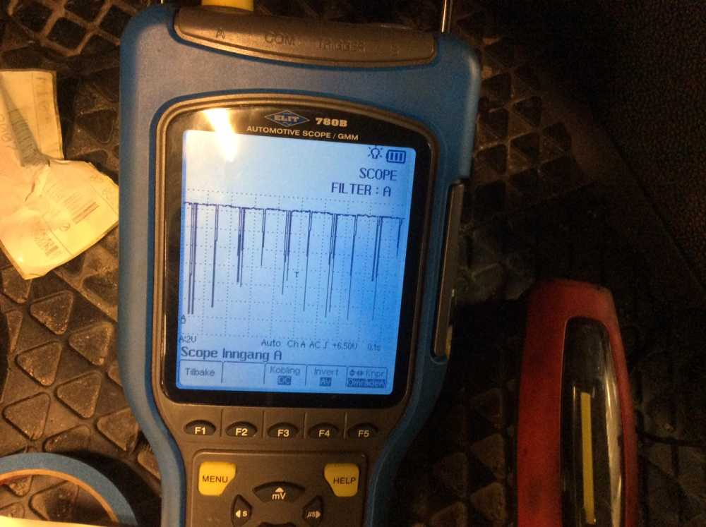

The passenger side window sometimes work, when it does it is from both switches. I have loaded the supply circuit and it is ok. Tried scoping the LIN bus but was not sure what I was looking at. Seemed like 12 volts with some noise over it.

I'm starting to believe it to be the door modules acting up. The only thing bothering me is the LIN. It does not do what I was expecting.

Any way you can get a shot of your waveform, sir? Just curious to see a screwy LIN waveform :ohmy:

9 years 10 months ago - 9 years 10 months ago #2907 by Inge Jeppesen
Replied by Inge Jeppesen on topic vw transporter t5. window lift not working.
Tyler;
Well I probably could. My scope has difficulties zooming in when the signal is 12 volts. So the resolution is only 1 V\div.
The 12 volt signal goes above the screen, when I adjust it down and zoom out it's not visible if you know what I mean. Hope you do.
Maybe I'm using the scope wrong.
The only noise I can see is that the signal line gets thicker when I turn on the ignition. It might as well just be noise and no evidence of communication. Not sure what kind of voltage change the lin bus operates,

Most LIN messages I've seen look something like this:
To me, it sounds like you're describing noise or a faulty signal, instead of correct communication.

Did some troubleshooting today. And when I disconnect and connect the driver door harness the Lin comes to life and every thing works.
For a long period. If I close the doors, pull in the harnesses nothing happens. There is a computer problem somewhere shutting of the communication.
When it happens nothing in the doors will work except mirror adjustment. Own circuit.
Have added a picture of the scope.

Problem fixed. Changed the door module including motor and everything is working!
