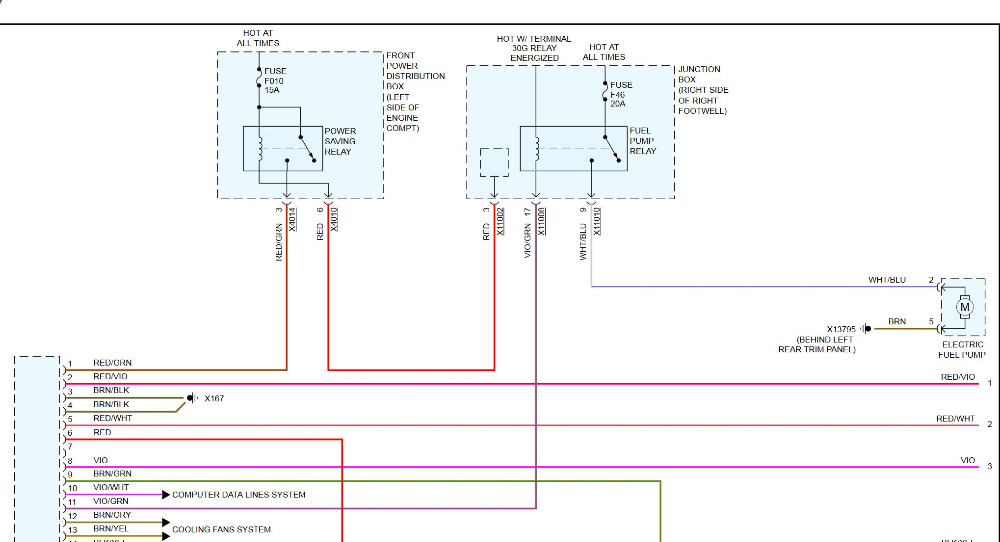

Hello all. My name is Bobby and I am a DIY mechanic with limited experience. I just got tired of paying big money for repairs that I could have done myself. So with that being said...I have a 2009 Mini Cooper S (my sons actually) that I have been troubleshooting a no start with crank. At first the car was in the shop for a turbo leak. After $1100 to repair that, the mechanic told my son the high pressure fuel pump was bad and it would be an additional $500 to change. The car was also having hard to start and rough idling. That's when I stepped in and said I will change it after watching how simple it was using YouTube. The HPF pump was changed, as well as the fuel filter. In between the maintenance repairs we had a terrible down pour and the inside of the car was soaking wet. My son thought a mini cooper looked cool with the doors off...totally different story!!!! Since the repairs and soaking of the inside of the car, I am in my current situation. I checked all relays and fuses with a light probe. I checked continuity at the pump and I thought I found my issue and changed the pump but that didn't work. That's when I came across Scanner Danner on You Tube. I can now say, I do not get power to prime the pump with the key/ignition in the on position. If I give direct power using my Power Probe I can here the pump priming. I checked voltage while cranking the engine I see battery voltage. Also, the RPM gauge does read a spike in RPM while trying to start so the crank sensor is sensing rotation. Spark was also verified. I am getting frustrated with this and looking for any advice. Thank you in advance.

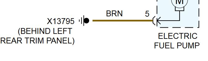

Pole71 I backed pin the white/blue and brown wires at the fuel pump connector.
8 years 2 months ago #22524 by Chad
Replied by Chad on topic 09 Mini Cooper S No start with crank
To make sure I understand....
1. The pump does NOT get power, and does NOT run for a couple seconds of prime when the key is turned to the "ON" position.
2. If you give power to the WHT/BLU wire with a power probe, the pump runs.
3. Cranking the engine, you have power on the WHT/BLU wire, and a good ground on the BRN wire but, the pump does not run.
Is this correct?
  • Bchez71
  • Bchez71's Avatar Topic Author
8 years 2 months ago #22525 by Bchez71
Replied by Bchez71 on topic 09 Mini Cooper S No start with crank
Pole71...Yes this is all correct.

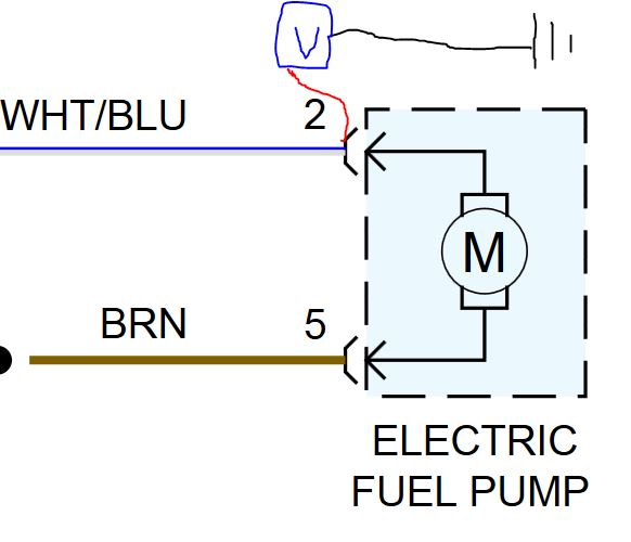

8 years 2 months ago - 8 years 2 months ago #22536 by Chad
Leave the battery connected. Set your meter to Volts DC. Connect the negative test-lead to a GOOD ground.

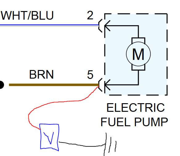

Then, back-probe the power side of the fuel pump connector (WHT/BLU) with the positive lead of the meter. CRANK the engine and read the voltage.
Now, move the Back-Probe/positive test-lead to the GROUND side (BRN) of the fuel pump connector, leaving the negative test-lead connected to a good ground. CRANK the engine and read the voltage.

Just to be clear, make sure you are doing this test with the fuel pump connector CONNECTED to the fuel pump.
  • Bchez71
8 years 2 months ago #22542 by Bchez71
Hello Pole71. Ok I got 10.9 volts on the positive side and 3.0 on the negative. Thanks for explaining to me how to properly check it. I was using the ground on the actual pump connector. Dee da dee
8 years 2 months ago - 8 years 2 months ago #22543 by Chad
3 volts on a ground wire is not good. You have a bad ground. Check the BRN wire and connections for corrosion, rust, cuts, etc.
You can use a jumper wire (or PowerProbe) to provide a temporary GOOD ground for testing purposes to confirm.
Last edit: 8 years 2 months ago by Chad.
