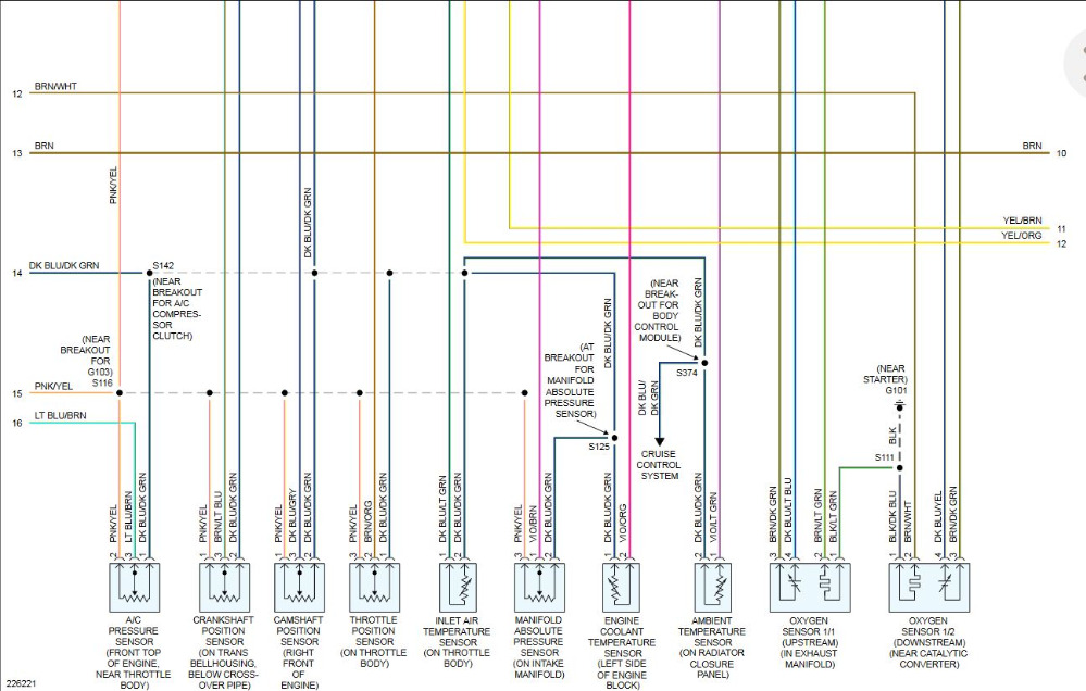

- thegrandvoyager
- Posts: 16
8 years 2 months ago #22516
by thegrandvoyager
Replied by thegrandvoyager on topic Error code P0016
thanks for your reply.
Tomorrow I am taking the car to someone who has an oscilloscope and he will check the pattern.
I checked the voltage to the sensors and found it was reading 4.75v. I understand it should be 8volts.
my next step is to discover the corresponding pin numbers on the ecu so I can continue checking. So any assistance you can provide will be muck appreciated
- Posts: 2223
8 years 2 months ago - 8 years 2 months ago #22517
The Pink/yellow wires should be 5 volts.
Replied by Chad on topic Error code P0016
thegrandvoyager wrote: I checked the voltage to the sensors and found it was reading 4.75v. I understand it should be 8volts.
Last edit: 8 years 2 months ago by Chad.
The following user(s) said Thank You: thegrandvoyager
