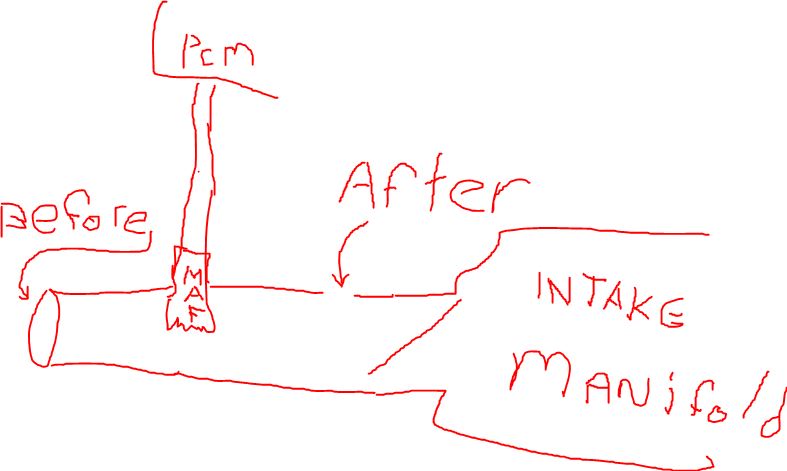

gerber wrote: If i put some carburator choke after maf sensor wont start too.. but if i do before the maf start right away
Are you saying that if you spray Carburetor Cleaner into the intake BEFORE the MAF, drawing the carb cleaner THROUGH the MAF, it will start?
But, spraying in AFTER the MAF, it won't start?
Like this?:
  • gerber
  • gerber's Avatar Topic Author
8 years 2 months ago #22646 by gerber
  • gerber
8 years 2 months ago #22647 by gerber
But already try with another maf sensor and atill do the same.. and iat is new..
8 years 2 months ago #22657 by Chad
:unsure: Hmmm. I wonder if that has anything to do with the spray pattern? At what angle is the spray going in AFTER the MAF? I wonder if it is "pooling" instead of "misting". Just speculating and grasping at straws...:dry:

8 years 2 months ago #22701 by gerber
I used start fluid and water too but nothing .
8 years 2 months ago #22709 by Ben
When using starter fluid with intake tube disconnected you need to disconnect maf connector as well I suspicion that's with it only starts when sprayed through maf housing
