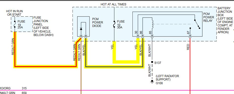

I have a 2000 Ford Explorer with a no comm to scan tool and with a no spark and no injector pulse. I have also checked and I am not getting any ign voltage to pcm relay I have battery power and ground

Thank you I’m gonna work on it tomorrow
