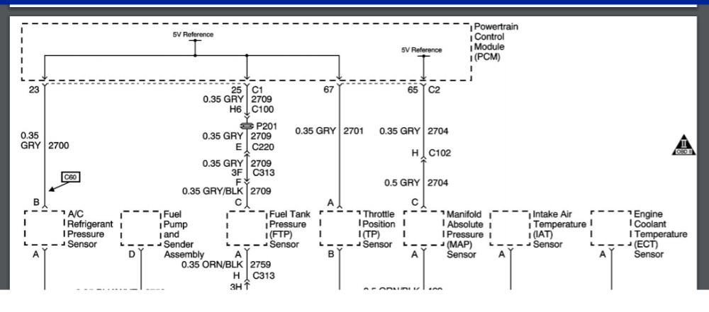

Definitely sounds like you're chasing a 5V reference wire shorted to ground.
Been there, and it's never easy. Like Paul says, the trick is heat and vibration. It's my experience that intermittent, brief shorts will usually set sensor codes and not 5V reference circuit codes. That's why you're getting a P0122 and not a P06XX.
It sounds like you've eliminated the sensors themselves, which leave the 5V reference wires themselves. I grabbed this from the GM wiring diagram:
Some careful shaking of the harness while watching the 5V reference might be a good next step, as long as you don't get too aggressive with the shaking. Just some gentle pushing and pulling are the trick.
The other option would be to access the PCM connector and remove pins 23 and 25 from C1, and 65 and 67 from C2 one at a time and recheck for the codes. For example, if you remove pin 23 and the P0122 comes back, the short isn't in the A/C Pressure Transducer wiring. But, if you remove pin 65 and the code never comes back, you know the issue is in the MAP wiring.
Make sense? If depinning the connector isn't an option, you can also cut the wire close to the PCM. Somewhere repairable, after you've found the problem.

Was looking around the C100 area after I shoved the fuel tank back in and found...
Right at the top of the harness bundle, there was a bunch of wires that seem to have been pinched at some point, all different colors. The worst one was.. GRAY. It had 2 holes worn in the insulation about 1/4" apart. So I cut the tape and pulled back the loom in the part going to the PCM about 10" back, cut the wire, and pulled it out of the harness. I cut out about a 4" section of the wire and soldered in another piece. I couldn't pull the C100 either out of the bracket or apart (I already said the car is a rust bucket and the bracket would have been royally messed up), so I don't know what terminal this wire was in, but wish me luck...
