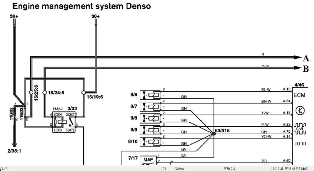

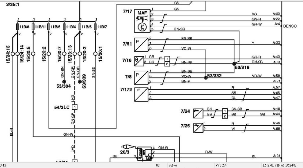

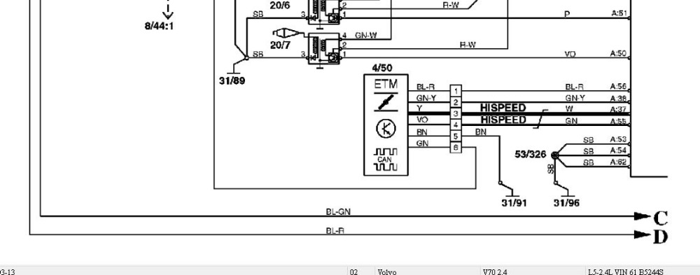

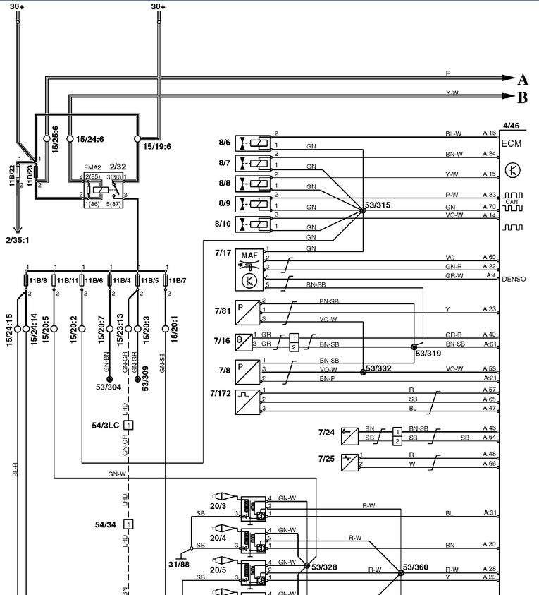

needing a wiring diagram for the fuel pump. if anyone has one its appreciated

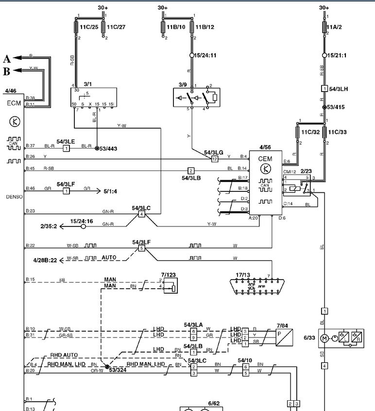

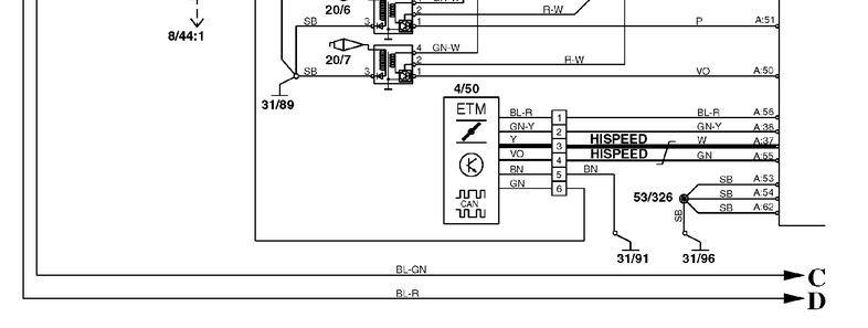

Replied by Paul P. on topic 2002 volvo v70
Hope this helps. They are snippets, you will have clip them back together, Its your engine management diagrams and Fuel Pump.

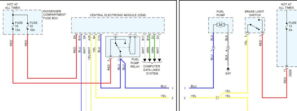

Replied by Chad on topic 2002 volvo v70
- Posts: 2223
8 years 2 months ago #22759

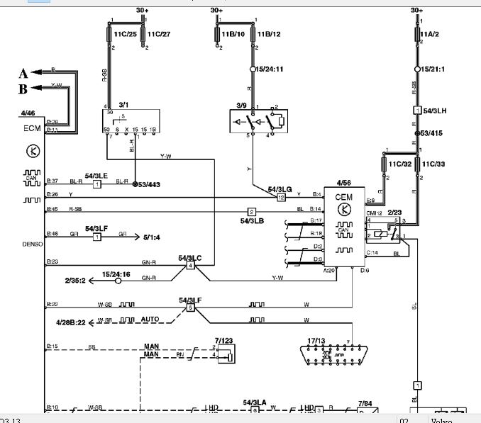

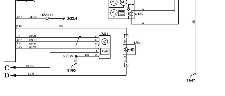

Thanks pole71, for a complete picture, for the life of me, I could not figure out how to get one big diagram with Alldata lol.

I use Windows Snipping Tool. Zoom in so that the Screen is filled by 1/2 of the diagram. Then snip two halves. When you insert them in the post, it looks like 1, complete, diagram.
Thanks, I shall try that, so it knows to put the two Jpegs together?
And, what source was the nice relay diagram, Mitchell?

- Posts: 2223
8 years 2 months ago - 8 years 2 months ago #22775
When you upload the .jpg/.png file, the insert option is presented. It will insert the jpg/png wherever the Cursor is positioned in the message.
After you insert the first jpg, the cursor is flashing after the file tag. Press enter to go to the next line, directly below and insert the second jpg.
Hit enter twice, before inserting the first part of the second diagram, to separate diagrams.
Yes, it is a Mitchell diagram. AllData has Mitchell diagrams, now, too!
Edit: That is, actually, from AllData. Notice that it is two different pages, side-by-side. AllData will let you scroll them like that. Mitchell will not.
