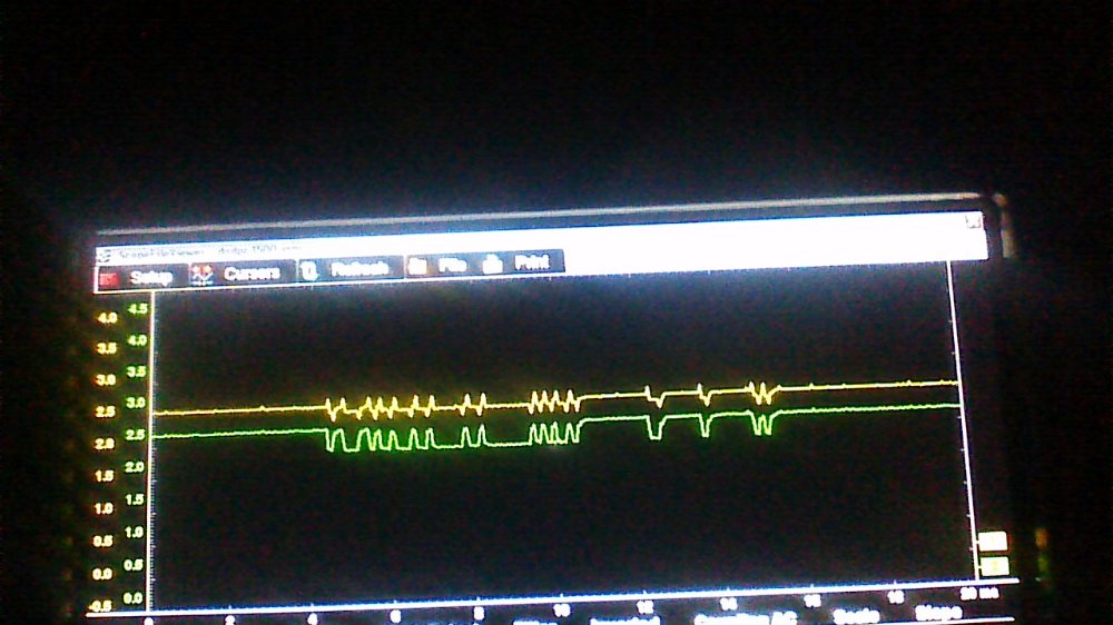

by betterway357
2002 dodge ram 3500 no bus displayed was created by betterway357
Greetings I'm from new York . 2002 dodge ram 3500 van. Vehicle will start run and shortly after cut off. Sometimes will start right back up, other times it will crank with no start. The odometer displays no bus. No codes present. Back probed pcm bus negative and positive. Did not receive signal I figure I should see. That points to bad pcm or what? The voltages on the waveform did not vary by 2 volts. I may be able to post the waveform if I can figure out how to get it off the scanner. Any help would be appreciated. Thanks in advance

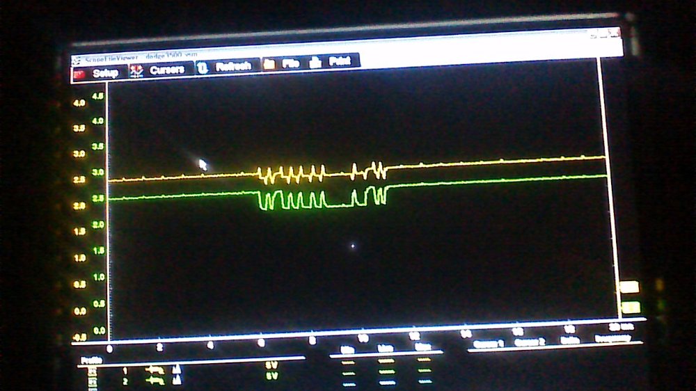

Thank you for the reply. There was a 5v ref signal present at a sensor. What would this 5v ref have to do with the bus signal? Then even if a sensor was pulling the 5v ref down shouldn't a code be thrown whether directly related or indirectly? I will post the waveform. I appreciate the help ro-longo

Thank you for the help? Have you looked at the waveform? I will check the asd relay. For proper operation. Also I will check what's missing once I get the no bus display. To me it looks like a resistor is faulty on the bus from the waveform but I'm no expert. I really do appreciate the time taken out for a reply john z and Ben
