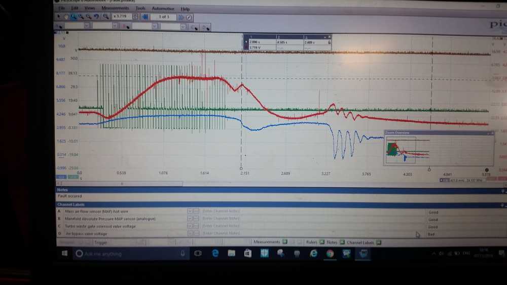

Hi guys car is back in and I have managed to recreate the fault. Here is a known good waveform notice the yellow bypass valve at the top gets told to open when the throttle valve shut's.

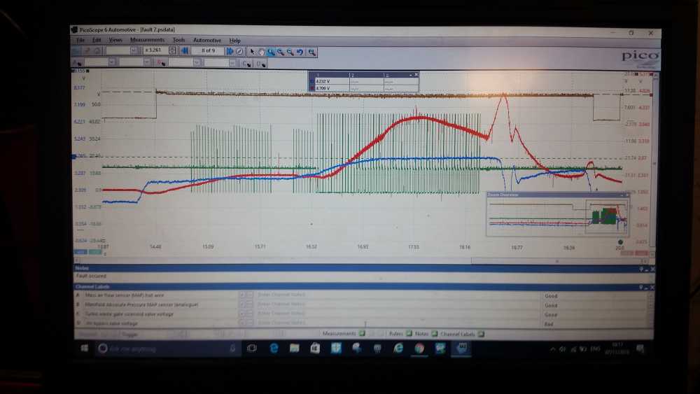

Here is where the fault occurred and fault code gets logged and it instantly goes into limp mode. NOTICE the boost pressure isn't even that high but when the throttle valve shut's the bypass valve doesn't recieve any command to open

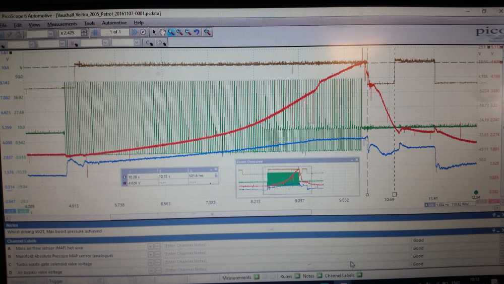

This is also where the fault occurred and the boost pressure did go super high again no command for the bypass valve
The red trace is boost and the blue is MAF. The green trace is the wastegate control solenoid which looks to me like when enegised it allows boost to occur, I see no fault here. Other than a software or driver issue I am struggling with this one any help or advice will be much appreciated. THANKS for your help.
  • Richey.brown
  • Richey.brown's Avatar Topic Author
9 years 11 months ago - 9 years 11 months ago #3347 by Richey.brown
Replied by Richey.brown on topic P0234
The air bybass valve is a valve bolted to the turbo which looks to me like it allows the intake air to bypass the turbo vanes altogether, (taking the turbo out of the intake system when it is not required.) Does anyone notice the down ward slope from the boost pressure sensor when the fault occurred??? Does this mean anything to anyone. Boost pressure Leakage perhaps???? Still struggling to see why there is no command for bypass valve. can't be a wiring issue as there is a zero voltage drop. And it wouldn't only NOT work at a a high boost pressure range and work every other time.
