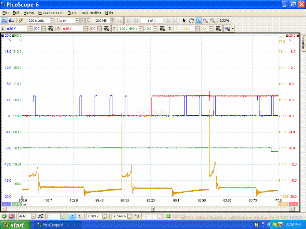

So those last three are ignition ground control. We should see coil activity if its a good coil since control is there.
One thing I notice with your setup is channel one (yellow) is set to "Test Lead" and not "Ignition Probe". It works better even when scoping on the primary circuit to set the scope in ignition probe mode for which ever channel is probing coil control. Change that and take another snap shot of coil control. Even if there is no spark from the tower we should still see activity on that coil.

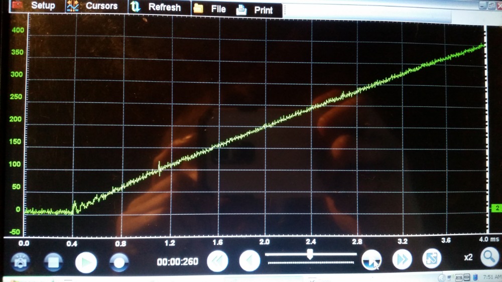

Do you have an amp probe? It would be good to take a current measurement of that coil to see if its shorted either on primary or secondary.
Also I learned that the crank sensor goes to 5v with the windows so if you ever have the crank sensor not spike to 5v on these I would highly suspect a sensor problem instead of something mechanical. If it stays at 5v for too long or turned on to early to 5v, something mechanical like spacing would be a suspect.

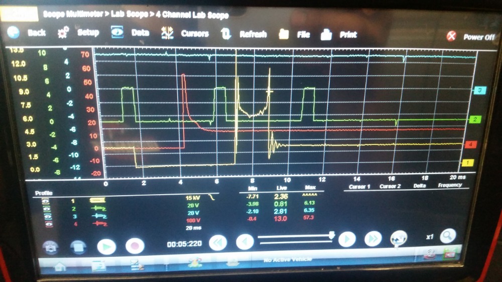

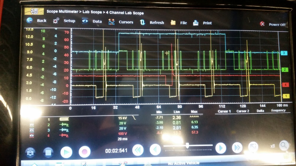

Here are a couple shots. The crank sensor is a problem with this one so that large 5v turn on in the green channel at the beginning and end of the cam signal is bad so ignore that. This vehicle does run fairly smooth just hicups now and then.
Yellow: IGN COIL CONTROL AT PCM
Green: CKP SENSOR AT PCM
Blue: CMP SENSOR AT PCM
Red: Cyl #1 Fuel Injector Control Wire at Fuel Injector

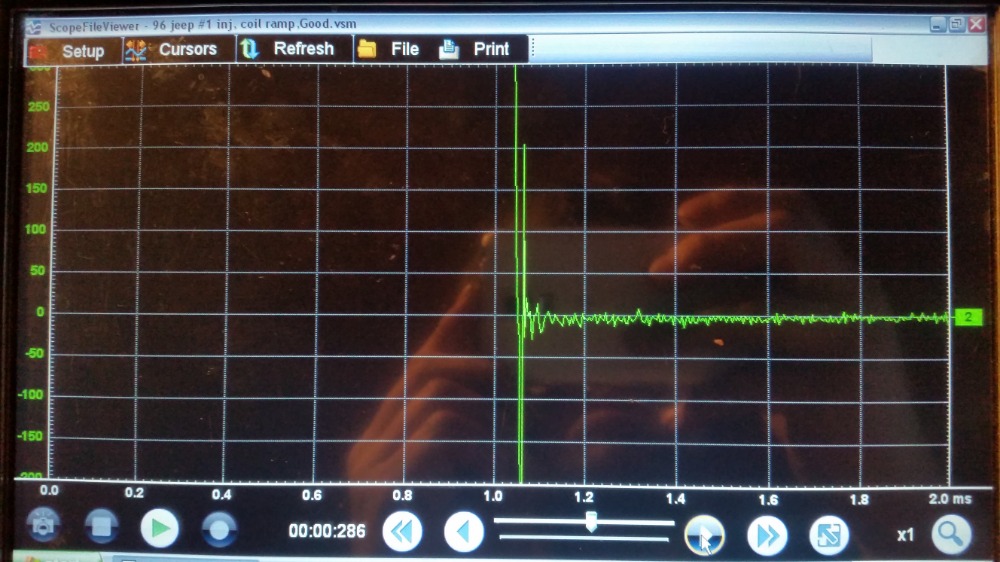

Here is what good coil control looks like on a 96 Jeep 4.0
Here is a Shot viewed out with crank and cam, #1 Inj to sequence the #1 cyl ignition event.

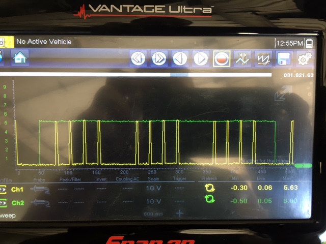

7 years 11 months ago - 7 years 11 months ago #23131 by graywave
Replied by graywave on topic 1995 Jeep Grand Cherokee 4.0L
So looking at this just looks like your time base was too long and may not be a ckp sensor dropping out.
Your flywheel and distributor look to be correct for your year. They also look like they are timed correctly.
Just so we can see everything in detail which will also tell us if something is not timing right...
CKP Sensor, CMP Sensor, #1 injector and Ignition Coil Ground Control.

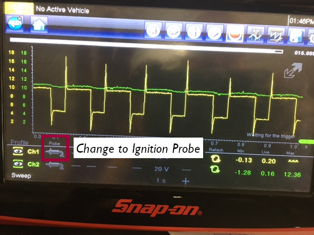

1. Set your scope so the channel scoping the ignition coil is set to "Ignition Probe" and you may need to put the KV scale is high as it will go. Attenuators work good for keep ign signals under control on the scope.
2. CKP & CMP sensor channels you can set to 20v scale.
3. The fuel injector channel you will probably need to set it to 400v scale. Attenuators help with this too.
Set your time base to 50ms. Have someone crank the engine and fill the buffer and hit the stop button then save all frames. Now you can adjust zoom levels and other parameters. You can take screen shots with your phone and if you have an online drive (cloud drive) like google drive, you can upload the entire scope file. May need to use a usb drive to transfer file to another pc.
I would be interested to see what everything looks like.

I noticed your snap shot here. If the CKP sensor and CMP sensor have no drop outs at all, then your CKP and CMP sensors look good and your timing is right.
I would say just grab CKP & Ignition and then CKP and #1 Fuel Injector. In fact CMP & #1 Injector would also help to judge timing of everything since there are no major sync notches in the CKP signal that can allow us to notice 720 degrees of crankshaft rotation. I can then compare them all and judge timing.
I do believe, if you have injector control, then you should have coil control. If you have good coil control, then just to make sure its housing is grounded and you have good power to the coil which I believe you already tested.
Whats interesting is the 96 Jeep I work on only uses a 5v REF to the sensors, not 8v.
Last edit: 7 years 11 months ago by graywave.

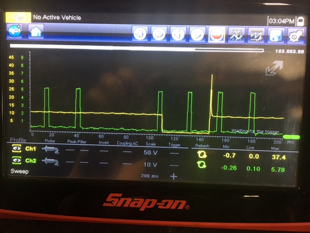

Here are a couple cam & #1 injector

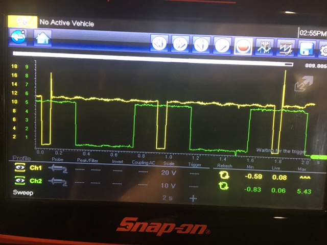

here is crank & #1 injector

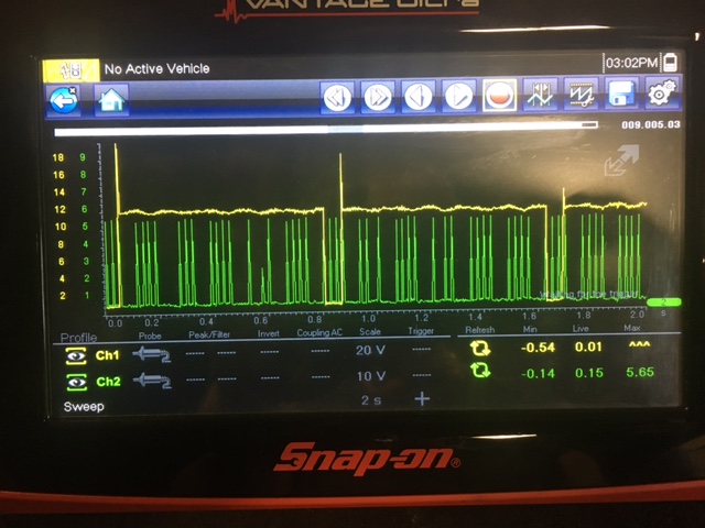

Cam & #1 injector

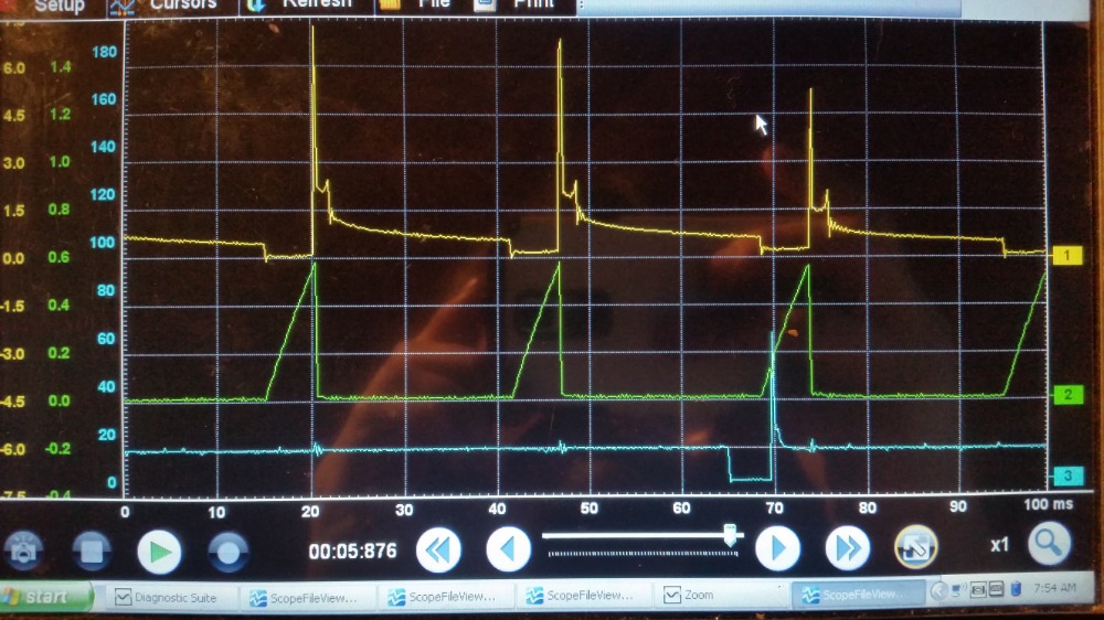

It appears timing wise it looks good. Matches what I got on the 96 jeep which is now fixed.
Grab some cmp / Ign ctrl * ckp / Ign ctrl shots. We need to figure out why your coil is not firing. You should see control to your coil if you have control to your injectors. Compare control at PCM and at IGN COIL. Make sure IGN CTRL is making its way to that coil.
Do you have a low AMP Probe that measures on a scale of 1mv/10ma (20a) or 1mv/100ma (40a)? 40amp could also be 10mv/1A scale, same thing. A current ramp test could tell us if the primary or secondary winding is shorted.
Honestly If you have good control and good power to the coil and the body is grounded well, that coil should fire.
Below I highlighted the area you need to change. You should be able to tap on the probe to change it. You might need to be "recording" aka "Scope Live" to make the change. Then set your voltage/KV scale as high as you can go. I believe it will probably go off the screen a bit "if" the coil was actually firing. Make sure coil is attached to the distributor like normal.
Here is a known good from a 1995 Jeep 4.0. Wiring diagrams do show 8v REF voltage to sensors but that might only be to run the hall sensing circuit. Probably just a 5v supply on the signal wire.

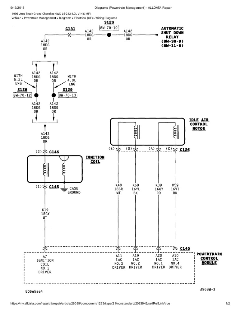

also keep in mind some modules and coils have there ground from the mounting onto body or engine if the bottom is dirty and or there are screws missing the transister in coil or modules will not have a proper ground i fixed a saturn once just by noticing there were three screws missing and dirt had formed under ignition module maybe do an amp test and kinda try and wiggle coil just a thought
  • graywave
  • graywave's Avatar
7 years 11 months ago - 7 years 11 months ago #23301 by graywave
If you get a proper control waveform, this will also tell you if the PCM is pulling the ground control all the way to ground.
What chief eaglebear and I are trying to explain is the body ground on the coil is very important as well as computer case and computer grounds

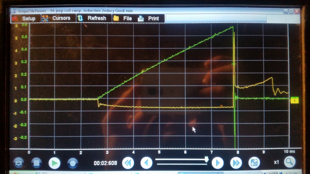

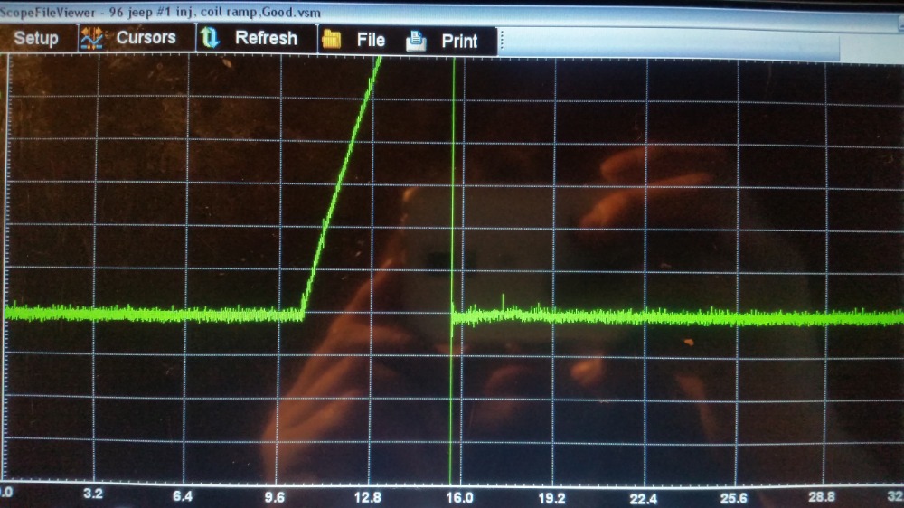

Here is a diagram of the ignition circuit. Notice the "case" ground on the 2ndary coil winding.
Notice this capture of mine. Control Side Ground is pulled almost all the way to ground. Measurements vary between 200mv to 1.4v on the ground side on the coil I tested while the coil charges up. I would like to see it go all the way to ground but there might be current limiting going on maybe....not sure.
Here is a snap shot of #1 Inj, Coil 2ndary with Inductive Pickup and Coil Current Ramp
Ign Coil primary winding current ramp showing secondary winding oscillations at beginning.
I do believe these oscillations at the very end of the current ramp are also secondary winding oscillations or possibly a mix of both primary and secondary?
Another shop of coil current ramp with Ign secondary with inductive pickup

"FIXED". Apparently it was a bad coil driver in pcm. Still not sure why i was getting ignition coil signal from pcm at coil connector with bad pcm & not sparking from coil tower. Does anyone have an explanation for me? I would like a better understanding of what i should have seen with lab scope reading for future reference. I appreciate the help everyone gave in repairing this.
  • graywave
  • graywave's Avatar
7 years 11 months ago #23407 by graywave
GOOD JOB!
The issue was probably the driver not pulling the control side all the way to ground or the pcm didnt have a good ground internally. Thats what it was looking like in your first capture but wanted to see the ign probe waveform to make a call.

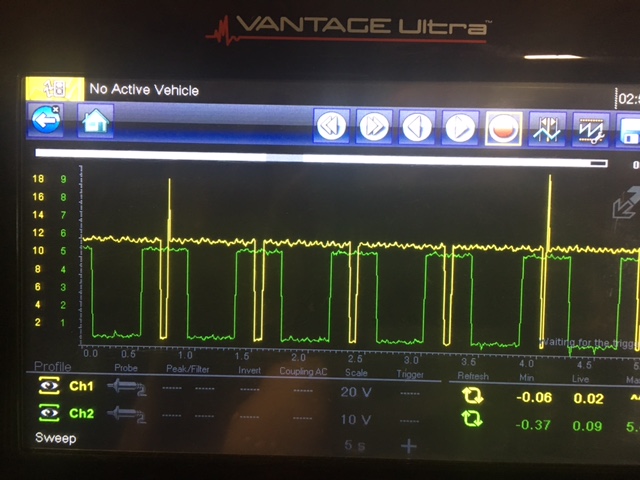

On your first capture, you can see when the voltage gets pulled down, its only pulled to about 4v, 2v max.
In this situation, the ignition coil would not be charging up to capacity and would not create a big enough electro magnetic field to induce high voltage needed to jump a gap any. Its possible i suppose that the original coil shorted out and took out the driver.

I do have a 20amp clamp but I'm still a bit confused. On my very first post the bottom picture is the coil control & 12 v feed that looks to me like maybe 1- 1 1/2 volt above being pulled to ground (0). Then on page 2 towards the end of the page I posted my buddy's jeep coil control and it looks to me like it's not as close to 0 as the none firing coil. So I guess I'm not seeing the problem
