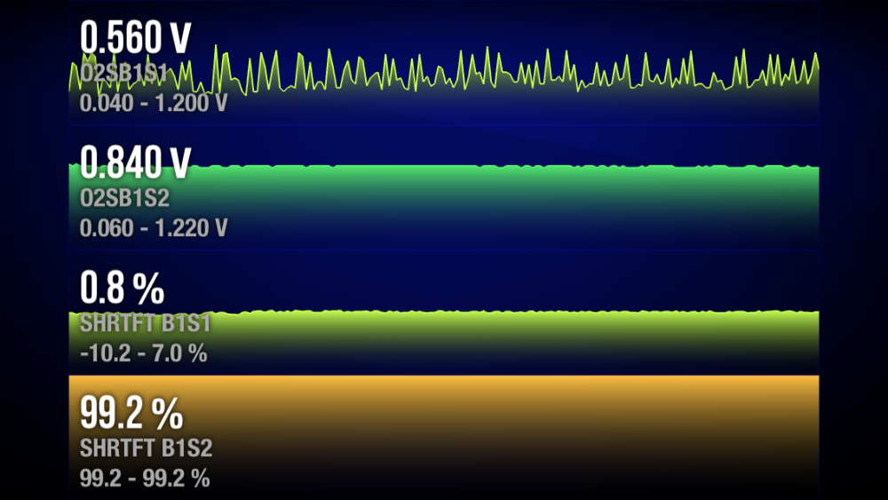

Thanks, yeah, the upstream definitely looks odd after a long idle, right? As the FTs lean further and further out, the range of change is less, but still in the middle range. You can see that it oscillates higher and lower in voltage when it hasn't been idling as long and when I give it throttle. I'm not sure what to make of all this...
WIth higher RPM (1000 and up), FTs normalize and look good and LT comes back to zero, 02 voltages both up and downstream jump up and down the full range - so that makes me think that there's nothing wrong in the 02 sensor department, but maybe I'm missing something?
In open loop, with the 02s disconnected, the roughness and richness is still very apparent at idle. Makes me think that FT isn't part of the problem, but seeing the trims sure helps to understand what the computer is trying to do.
I can't find any exhaust leaks. Really not sure what to check next here...
Thanks again for the help!

The downstream 02 reads high and rich at idle. I don't doubt that it's telling the truth because the exhaust is so fumy. The fact that it mimics perfectly the upstream sensor when I give it throttle and the rpms increase makes me think the cat isn't doing it's job.
Also, there is a PID for downstream O2 fuel trim and it reads a constant 99.2% at idle and when under load. I know that it's been said that downstream is only for emissions, but if there's a PID for downstream O2 trims, it must mean that the downstream is contributing to the FT, right? Or at maybe the PCM is shot? Not sure what to think here... Thoughts?
That said, I know that in open loop it's still rough and fumy so I KNOW that the O2 and cat are not the underlying cause of my woes here... SO...
I'm suspecting that there is an issue with the injector timing. In this engine, it's a single coil conventional ignition system and the fuel sync is based on data from the CMP sensor in the dizzy. As you can see in the images posted previously, the fuel injectors are firing 3/8ths of a full 4 stroke cycle. E.g. the 1st cylinder's injector fires halfway through the exhaust stroke. That doesn't seem right to me. I'd prefer to see the injectors firing closer to when the intake valve opens - at or just past TDC of the exhaust stroke. But maybe I'm missing something?
The fuel sync can be set with the proper OBD tool and by rotating the distributor. Problem is, I don't have access to a better scan tool. Could this simply be a fuel sync issue?

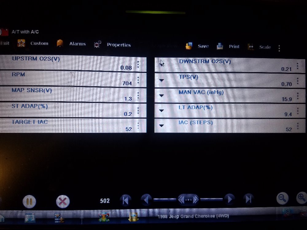

7 years 11 months ago #23601 by Ro-longo
I Don't know if you have fixed your problem but here is an image of a known good Jeep with the same engine.
This is at idle at 4200 ft in elevation. I had just replaced the MAP sensor due to it only showing 8 inches of vacuum at idle and my vacuum gauge showing 16 inches.
I don't know what your elevation is but it will effect you vacuum readings. Higher altitudes means less air to suck, so you wont have as much vacuum.

The 99.x% indicates that there is NO fuel trim from/by the rear oxygen sensors taking place. Don't be concerned about it, that's just a design flaw of early OBD2.

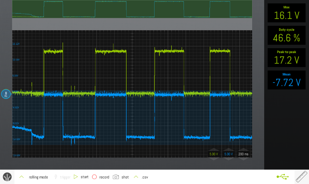

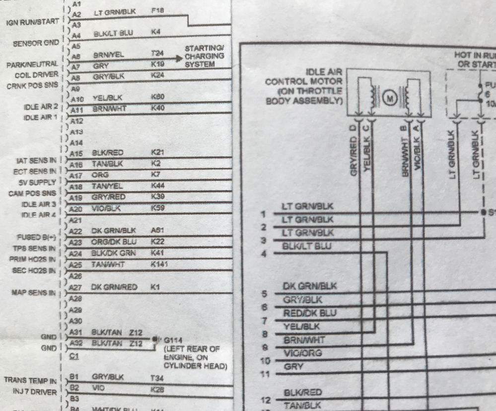

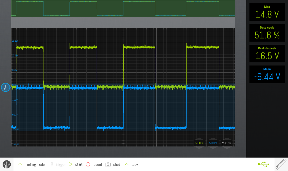

Since I can't get scan data for it, here's what I was able to scope for the IAC at idle:
PCM ins at A10, 11, 19, 20, probed at the valve though:
Violet/Gray (Outer) wires:
Brown/Yellow (Inner) wires:

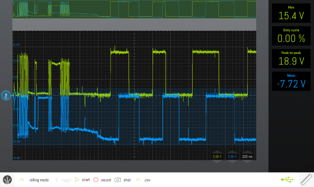

Here's a capture at startup (I think Gray/Brown)
I'm still not sure how to calculate this into steps to compare it to a normal 5.9L. Any thoughts?
