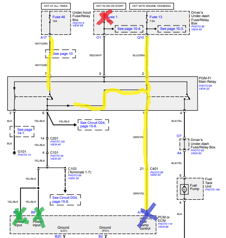

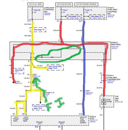

So it sounds like you had a bad connection either at the fuse or relay. That fuse looks like doo-doo. I would clean all the contacts for that fuse and the relay connector too, maybe put a little dielectric grease on them if you have a tube kicking around. Also just double check that the relay connector doesn't have any loose pins.
As for "how it works"... I pulled up the diagram, and I will try to explain. Much easier to explain in person, but here goes...
And please, Honda guys correct me if i'm wrong, I am just interpreting it as I see it...
The first diagram simulates a potential poor fuse connection that seems to have caused the issue. The yellow marker is everything that would be "hot" when you try to start it. Note the blue "x"- the PCM will not provide a ground there to energize the relay, because it is not getting a power input on the green "x"'s. This is part of the immobilizer/anti-theft protection circuit.
The second diagram is with everything functional, i have them in different colors just to see circuit separation easier. I think the confusing part is the wire i have circled in green. Because, doesn't it look like the yellow circuit should power up the other side of the relay? And then why would we need the blue circuit?
That wire circled in green has a resistor and a diode on it. That tells me that the purpose of it is to absorb flyback voltage, likely from the wire below that powers the injectors. With that terminating resistor on the circled wire, it wont have enough juice to power up the other side of the relay. Hope this helps.

TheTechWhisperer wrote: The first diagram simulates a potential poor fuse connection that seems to have caused the issue. The yellow marker is everything that would be "hot" when you try to start it. Note the blue "x"- the PCM will not provide a ground there to energize the relay, because it is not getting a power input on the green "x"'s.
Ah, that blue X is something I was missing - I was only thinking that the hot-with-cranking fuse 13 meant power was getting to the fuel pump, but overlooked the fact that the control circuit isn't active without a ground! :pinch:
TheTechWhisperer wrote: The second diagram is with everything functional, i have them in different colors just to see circuit separation easier. I think the confusing part is the wire i have circled in green. Because, doesn't it look like the yellow circuit should power up the other side of the relay? And then why would we need the blue circuit?
Yeah, that yellow circuit seemed odd to me. Thanks for explaining its function.
