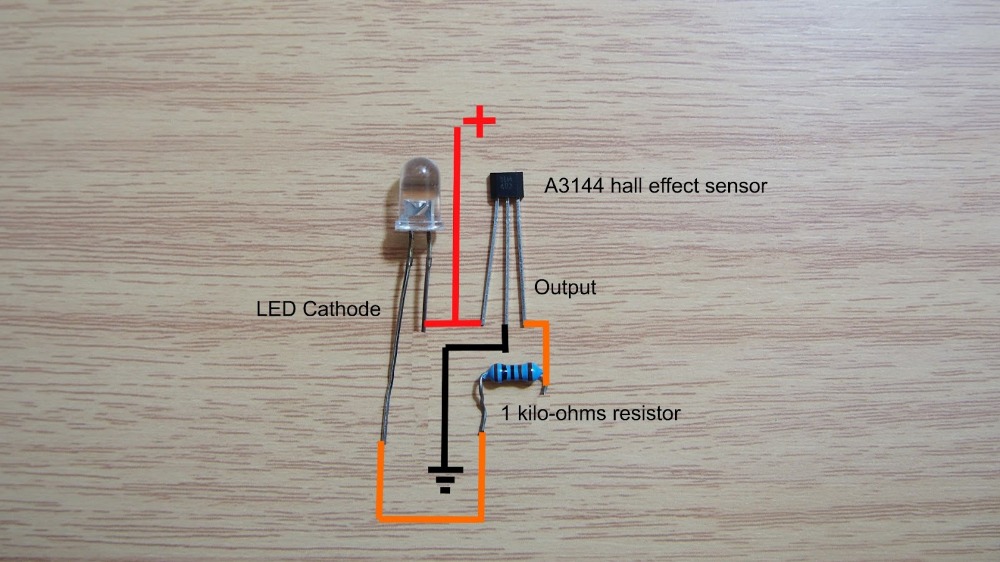

So i found an article that goes into detail about hall effect sensors. They talk about the Hall effect sensing circuit and how it responds to magnetism which requires a power and ground source to function but since there is a magnet in our sensors it must move away and toward the sensing circuit. I had always thought it was just a simple switch internally.
www.electronics-tutorials.ws/electromagnetism/hall-effect.html

graywave,
this is a very good and complex analysis of hall effect sensors :
Have a look at part 5 as well.

The science behind the hall effect is what I needed, Thank you! Completely polishes off my knowledge on these types of sensors.
